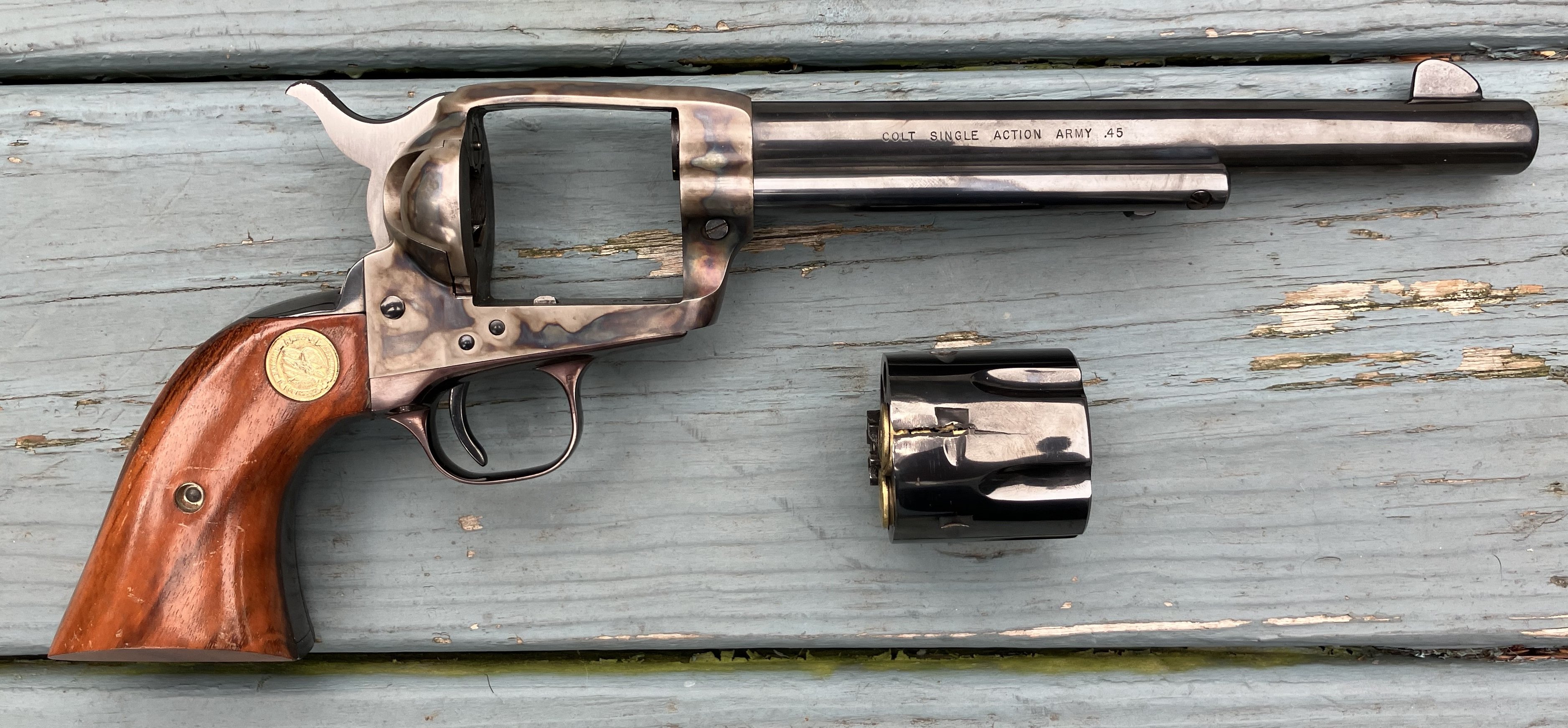

H. K. Uriah, SASS #74619 Posted September 4, 2023 Posted September 4, 2023 Red Dot is good. Red Dot is hard to find where I am. Seems to be as scarce as Trail Boss. HP-38/Win231 can be found, (They are the same powder) and it works.... But if you you a minimum load, it is VERY light. Too light. That's with 5.9 grains and a 200 grain bullet. Max load is 8.0. I went up to 6.5. That was much more respectable, while still be mild. BUT... You do not want to double charge even a min load of this powder. You'll have this happen... Or this.... If your lucky, the friends using your guns and ammo will not be hurt and you'll be able to laugh about it the next day. But you'd rather it not happen at all... I also noticed with this powder, even when up to the 6.5 grains, I had a lot of unburnt powder. Even thought I've got a lot of the stuff, I wanna try something else. I've read that Green Dot can be useful, and I do have some, but have not tried it yet. That'll prolly be my next test.
