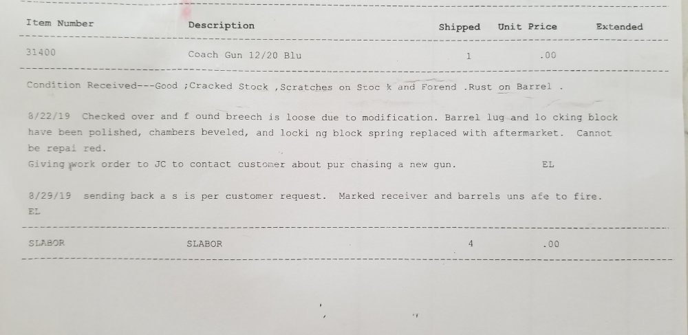

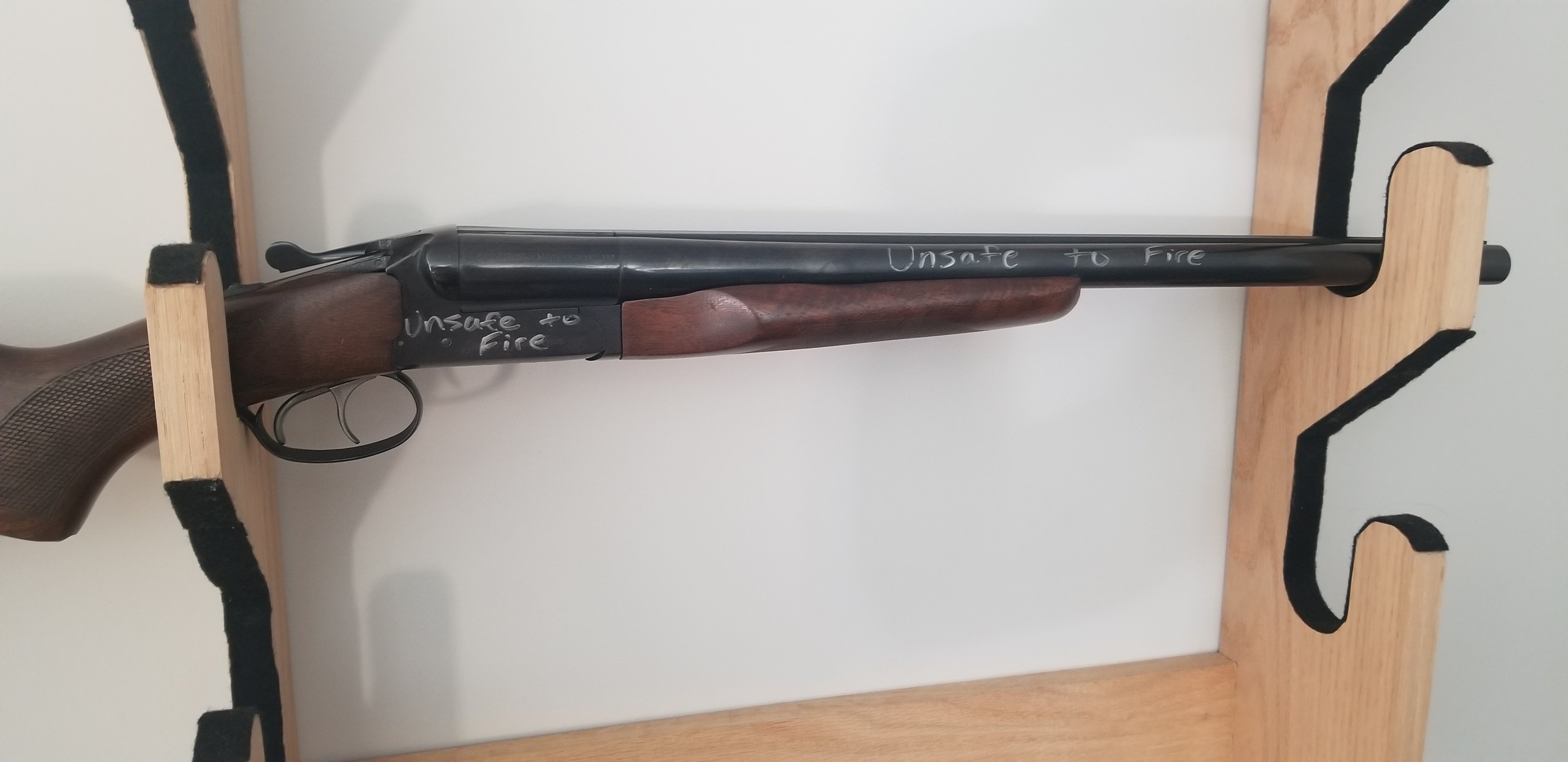

Chantilly Shooter 31 Posted October 6, 2019 Share Posted October 6, 2019 Howdy, pards. I shot my first match in just over a year yesterday. Boy, was that nice. The main reason I'd been away was a six-month deployment; however, random work and life commitments kept me from making a match since I got back in late March. Another issue that kept me away from a match or two was that I didn't have my shotgun. I finally got it back about three weeks ago (late Sept); here's the story. I took my shotgun to a gunsmith back in the first week of April hoping to get a crack in the stock repaired (ref. picture 1). I don't normally care too much, but this gouge leaves the action exposed. After a few (alleged) unsuccessful attempts at finding 'the right piece of wood' to splice in or procuring a replacement stock, the gunsmith elected to send the gun to Stoeger for install and fitting of a completely new stock (late July). There was a mix-up in coordinating my consent for that due to the fact that I was underway, but, I should have sought greater clarification and requested the gunsmith not send it off. Regardless, eventually the smiths at Stoeger get to my firearm, and apparently, they did not like what they saw. Stoeger contacted the gunsmith who shipped it to them to say that the gun appeared to have been modified, and they would not work on it in such a state. Frustrating, but ok, I understand that. At this point, it's late August, 4.5 months after this saga began, and I just want my doggone shotgun back. Well, back it comes, and with a cute little surprise. Some clown at Stoeger decided that because they deemed the firearm unsafe, he or she was entitled to scribble on it, in four locations, in what appears to be silver Sharpie, their determination of 'unsafe to fire.' See the attached pictures. Along with that comes the invoice for their 'work,' which includes a nice little list of what they deemed unsafe. I bought this shotgun about three years ago brand new from Longhunter's in Texas. The folks there did the work on it before I ever saw it, and did a great job. Ironically, Stoeger's list of 'unsafe' modifications reads exactly like the bill of sale for what I paid Longhunter's to deliberately modify! Stoeger doesn't want to work on the shotgun due to modifications? Perfectly fine. Stoeger wants to deem it 'unsafe to fire?' Fine. Stoeger wants to deface my property by scribbling their OPINION in four locations across my shotgun?! HELL NO, that's not fine! Further, to have the audacity to say on the invoice that their solution is 'to contact customer about purchasing a new gun-' are you kidding me?! This really got (and gets) my blood boiling. Respect for personal property is a paramount value in my book. To wrap it up: 1. The crack in the stock isn't repaired. 2. There's nonsense scribbled on my shotgun. 3. I haven't yet figured out how to effectively remove it without harming the finish. 4. 5.5 months were wasted. But, to end on a high note, because I try to be happy- at least I have my shotgun back and got to shoot a match. Thanks for reading, Chantilly Shooter Link to post Share on other sites

Lawdog Dago Dom 1,802 Posted October 6, 2019 Share Posted October 6, 2019 Apparently hanging a red tag on the trigger guard with an explanation is against company policy? I was PO'ed just reading about it. Good thing they don't work on cars. Link to post Share on other sites
Tyrel Cody 5,264 Posted October 6, 2019 Share Posted October 6, 2019 That would make my blood boil as well I don't believe Acetone will hurt the blue, but will remove the sharpie. Try in an inconspicuous are first. Link to post Share on other sites

Church Key, SASS # 33713 251 Posted October 6, 2019 Share Posted October 6, 2019 Use 91% rubbing alcohol to remove the graffiti. Check online for a replacement stock. Link to post Share on other sites

G W Wade 1,052 Posted October 6, 2019 Share Posted October 6, 2019 Probaly should feel lucky they only used a silver sharpie to disable this dangerous weapon and not a engraver or chopsaw!!!! Sorry but have heard of their ignorance before GW Link to post Share on other sites
Fence Cutter 685 Posted October 6, 2019 Share Posted October 6, 2019 Good thing that marker "clown " doesn't inspect shotgun shells at Winchester ....... Lighter fluid should clean it up without harming the finish. I use it on vintage guitars. Link to post Share on other sites
Jailhouse Jim, SASS #13104 615 Posted October 6, 2019 Share Posted October 6, 2019 WD-40 is really good at taking ink off. Link to post Share on other sites
Yusta B. 1,474 Posted October 6, 2019 Share Posted October 6, 2019 29 minutes ago, Jailhouse Jim, SASS #13104 said: WD-40 is really good at taking ink off. I use Sharpies to mark ammo & WD40 takes it right off with a rag. Link to post Share on other sites

Marshal Chance Morgun 1,093 Posted October 7, 2019 Share Posted October 7, 2019 Reading the title was all that was needed to know what happened. This has been discussed more than once. Being somewhat new, I can see that you didn't know this would happen. Your gunsmith probably should have, but what is done is done. Worth repeating. I understood, at least a few years ago, that if you returned a modified gun to Ruger for a repair they would take out the modified parts and install new factory specs parts. Link to post Share on other sites

irish ike, SASS #43615 1,256 Posted October 7, 2019 Share Posted October 7, 2019 The gun was modified. For them to work on a modified gun makes them responsible for anything that may happen. I understand if you send a "cowboyed" pistol to Ruger they will send it back repaired. As in everything that was modified replaced with stock parts. Stoeger's expert did exactly as the company asked him to do. Don't touch modified guns. Sharpie comes off easily. Ike Link to post Share on other sites
Castalia,SASS#18915 91 Posted October 7, 2019 Share Posted October 7, 2019 Your very lucky. About 7 years ago a friend bought a used Stoeger coach gun that someone put very light springs in. It would open upon firing. Took it to the local Stoeger dealer to get a new set of springs. The dealer recommended sending it back to Stoeger for repairs. The story line was the same as the above example. Only thing was his was spray painted yellow. The whole shotgun,. Then they wrote on it with a red marker. "Unsafe to Fire." Link to post Share on other sites

The Original Lumpy Gritz 7,490 Posted October 7, 2019 Share Posted October 7, 2019 Call Longhunter, and see if he has a spare stock. Lacquer thinner or Acetone will remove the grifity. OLG Link to post Share on other sites
Dusty Devil Dale 565 Posted October 7, 2019 Share Posted October 7, 2019 48 minutes ago, The Original Lumpy Gritz said: Call Longhunter, and see if he has a spare stock. Lacquer thinner or Acetone will remove the grifity. OLG Have you tried Hoppes #9 on the ink? Might work. Won't hurt the gun . Link to post Share on other sites

Turkey Flats Jack 619 Posted October 7, 2019 Share Posted October 7, 2019 I'm with ya I'd be smokin hot about that mess. As for the sharpie easiest way I've gotten it off is to scribble over it with a dry erase marker. Let that dry a few minutes and then wipe clean with a damp rag. Windex works faster than water. Learned that when the kids were young and ornery. T.F. Jack Link to post Share on other sites
