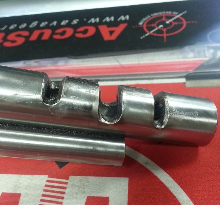

Cliff Hanger #3720LR Posted December 24, 2019 Posted December 24, 2019 I work with a Dremel making small parts. My opinion is the Dremel in experienced hands can be a fine tool. But after 10 years of making small parts with a Dremel, I still believe it is the most effcient tool to make perfectly good parts in to junk. And this happened extremely fast. If you want to work on your guns with a Dremel, may I suggest ordering a couple of spares before you start or maybe a new gun to replace the one your about to work on.

Major E A Sterner #12916 Posted December 26, 2019 Posted December 26, 2019 In the wrong hands it can be used to turn a functioning fire arm into a paperweight.
The Original Lumpy Gritz Posted December 26, 2019 Posted December 26, 2019 In the wrong hands it can be used to turn a functioning fire arm into a paperweight. You have to be 10% smarter, than the tool you're using. OLG
Rooster Ron Wayne Posted December 26, 2019 Posted December 26, 2019 The Dremel is a handy tool . But in the wrong hands or someone who think they are a gunsmith because they have one . They can be a danger to themselves and other shooters .
