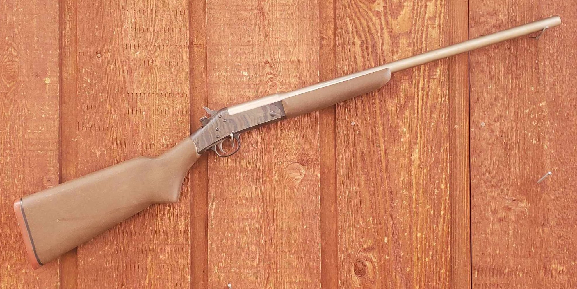

A push-button...? Like on an NEF or H&R, I'm thinking? NEF and H&R single shot shotguns are both out of production, as you may know, but there are a several on Gunbroker. Looking at completed auctions, the first NEF 12g on the first page sold for $77 six days ago, but most went for more like $130-$180ish. The Stevens mentioned above looks like the same thing, and it's priced right, but cutting down a hollow plastic stock might present a challenge. -

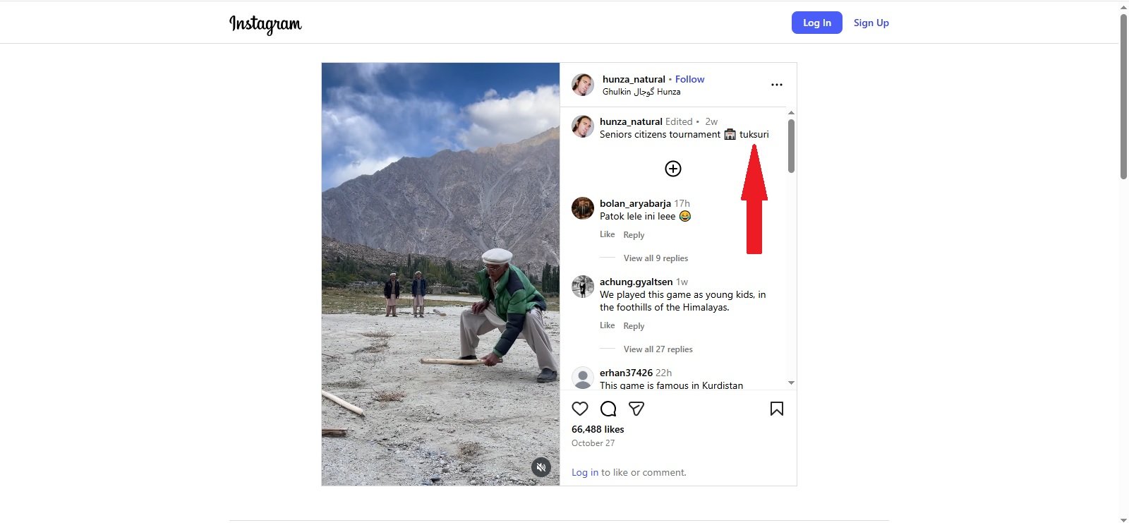

According to the link you provided, it's called Tuksuri. https://www.shupun.org/wakhi/culture-heritage/traditional-sports/tuksuri

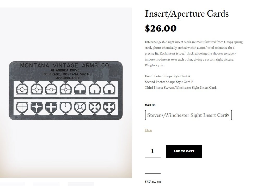

As Lumpy pointed out above, the Stevens/Winchester sight insert set is $26 from MVA. The original Winchester inserts appear to be thicker. The MVA's are .012", so measure yours, and if it's .024+", within reason, there's enough room for a double thickness. Take one of the inserts and break/grind/file the inside aperture away so it's just a shim/spacer ring. If it's less than .024, lay the shim on a piece of sandpaper and sand it thinner until it works. https://montanavintagearms.com/product/aperture-cards/ -

MVA makes a similar front globe, with the U shaped retainer/level clip. -

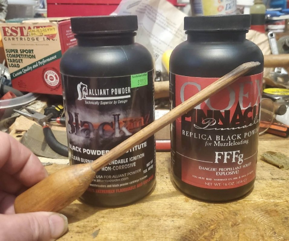

Yep. When powder was getting hard to get, I found an eight pounder and bought it. IIRC, I was loading Cowboy shotgun loads with 14.4 grains and 7/8ths or 1 oz of shot. Below about 14.5, they're a little erratic - I used 14.4 because that's what one of my Little Dandy rotors throws, and it worked fine.

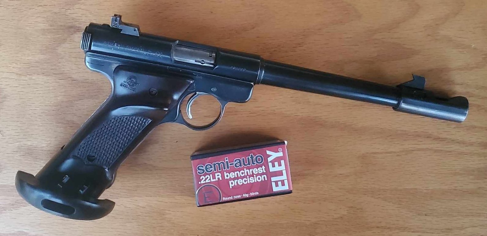

I shot Bullseye some about 50 years ago, and a couple GSSF matches about 25 years ago. Bullseye was OK, but GSSF... start at low ready, knock down six plates, repeat three more times. Whoopie doo. I had a buddy in the Navy who had a 1911, and I bought a used Ruger Mk1 T678, which I still have, so we teamed up to shoot Bullseye when we were at NAS Whidbey Island in the mid-70's. We weren't very good at it.
