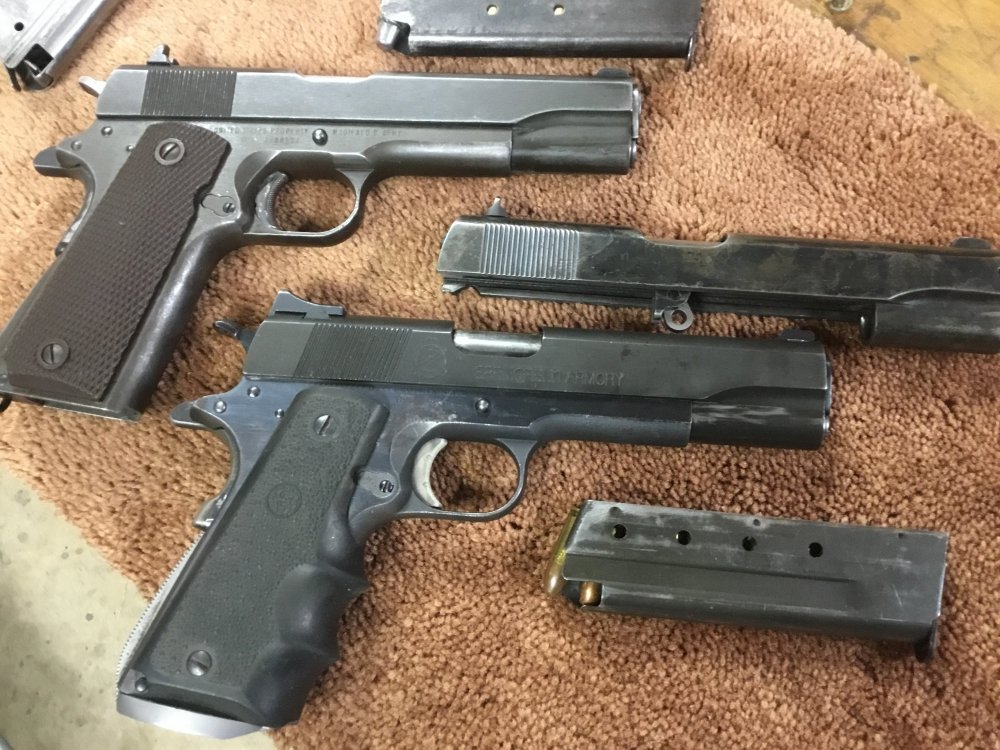

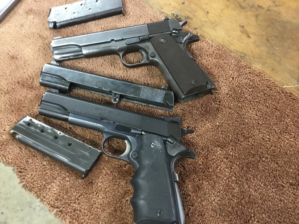

Cypress Sam, SASS #10915 Posted April 11, 2020 Posted April 11, 2020 I saw a 9mm conversion unit in a gun store for sale really cheap so just had to buy it. It was a Springfield unit consisting of slide complete with extractor, firing pin, bushing, recoil spring and barrel with link. (No ejector). I put the “kit” on a Remington Rand (WW II vintage 1911) and it ran just fine with the factory ramp and ejector. Later I bought an old Colt 1911 45 frame at a gun show for a cheap price. This too worked fine with no modification other than installing the “kit”. I since found another slide, barrel with associated parts to convert back to .45. Either frame works fine with either caliber with no ejector or ramp modifications. I’ve heard that the ejector for 9mm is different, but mine works fine for either caliber. The one the right is the converted 9mm and .45 slide/bbl. The other is the Remington Rand .45.
