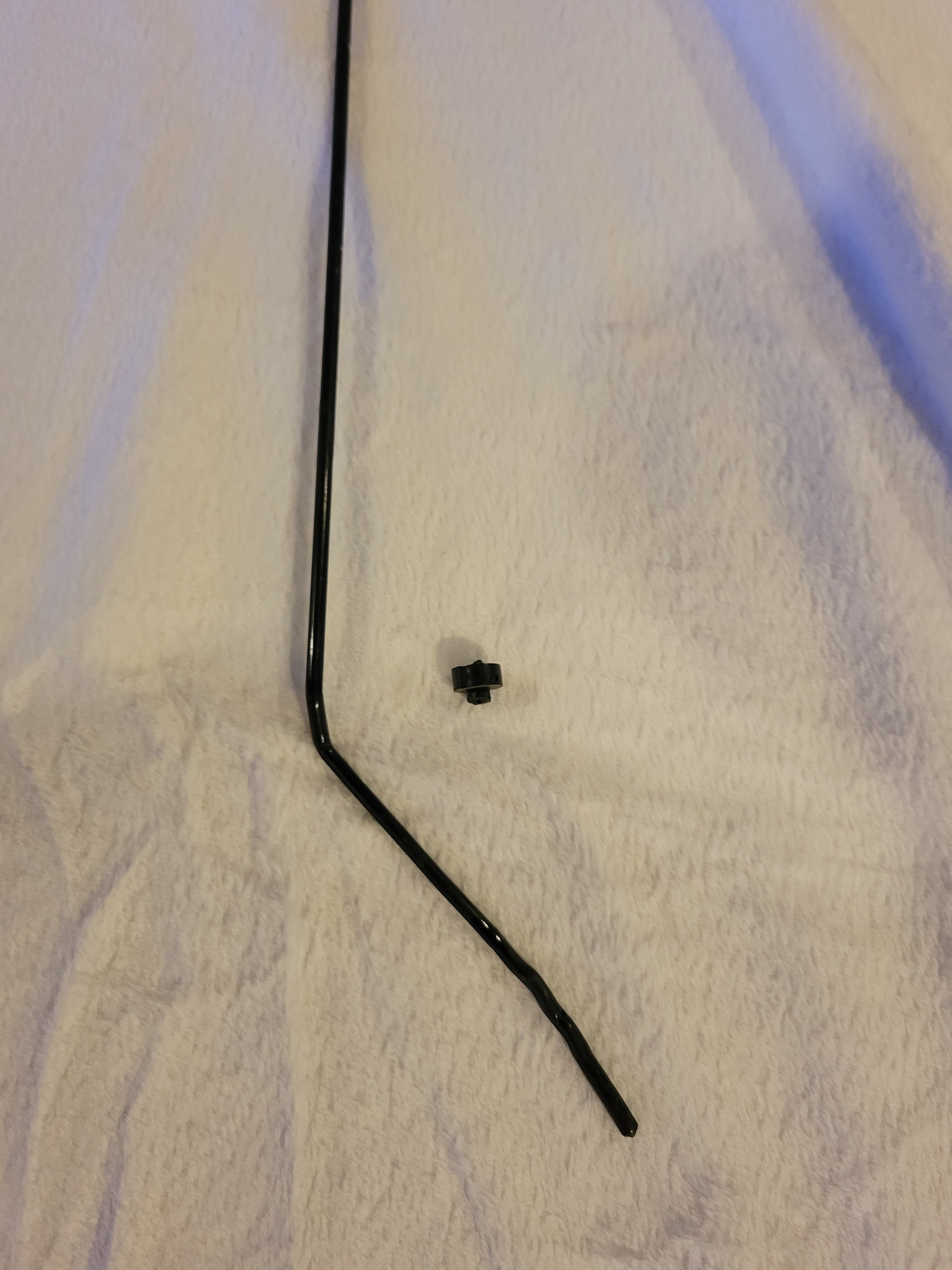

Tennessee williams Posted November 12, 2021 Posted November 12, 2021 Well, I finally HD a primer go off while loading. Let me tell you, it'll scare the 4ell out of you. I was loading like always and everything was going smooth. Perhaps more smooth than usual, when BOOOOOM happened. I never felt a snag on primer seating. After blinking a bit to make sure I could still see and to make sure I wasn't holey, I looked up and there is a primer (I think) stuck in the ceiling and my primer follower was across the room mangled and broken. Now the disk that rotates the primers into position is stuck. I'll have to disassemble it to see what's wrong. The press ram won't go up either. Probably caused by the seized disk. I'll know later. What I don't know is how it flashed in the first place or how it affected the primers in the tube. What I do know is, somehow it is Widder's fault....and I'll wear glasses from now on! Primer stuck in the ceiling. Mangled primer follower.

Garrison Joe, SASS #60708 Posted November 12, 2021 Posted November 12, 2021 Dillon 650 or higher, right? I've had two tubes full of Federal small pistol primers head for the moon. That rotary feed disk has the ability to pinch a primer just right to set it off, and the explosion ripples across the rest of the disk of 8 or so primers, and up the tube to light up your life. Almost always ruptures/destroys the aluminum liner tube inside of the steel outer tube. Pull that out and check. Dillon has several parts bags of the items that usually need to be replaced already staged and ready to ship. Happens more often than most folks ever hear about. good luck, GJ
Tennessee williams Posted November 12, 2021 Author Posted November 12, 2021 4 minutes ago, Garrison Joe, SASS #60708 said: Dillon 650 or higher, right? I've had two tubes full of Federal small pistol primers head for the moon. That rotary feed disk has the ability to pinch a primer just right to set it off, and the explosion ripples across the rest of the disk of 8 or so primers, and up the tube to light up your life. Almost always ruptures/destroys the aluminum liner tube inside of the steel outer tube. Pull that out and check. Dillon has several parts bags of the items that usually need to be replaced already staged and ready to ship. Happens more often than most folks ever hear about. good luck, GJ You're the answer man, Joe! Thanks, I'll look at that inner tube. Still trying to get to every thing.

Tennessee williams Posted November 12, 2021 Author Posted November 12, 2021 27 minutes ago, Buckshot Bear said: Jeez that's scary. On my Xl650 (touch wood) its never happened but I have had primers crushed and mangled in the disk bad enough that the yellow priming mixture (Federal SPP) has been smeared everywhere. So I don't know how close that was to igniting a rocket. Please please please......always always safety glasses!!! I've had that happen a bit and have always felt the difference. With this...nothing.

Max Payne Posted November 12, 2021 Posted November 12, 2021 I lit a whole primer tube up once on the 650. Primer follower looked just like your picture. It was pretty exciting. It'll be okay if I don't do that again.

TN Mongo, SASS #61450 Posted November 12, 2021 Posted November 12, 2021 Glad you're okay TW. I've also had the same experience with my 650. In my case, I was fortunate that there were only a few primers left in the primer tube. For some reason, after the incident, my cats leave the reloading room when they see me on the 650. Does Dillion make (or are they considering) a conversion kit to change a 650 priming system to a 750 system? I think I would be interested.

Hoss Posted November 12, 2021 Posted November 12, 2021 I never had a primer tube detonation on my 650. But heard enough to know I didn’t want one! Bought a 750, sold the 650. Upgraded for about 150. The primer system on the 750 (and 550) is better
