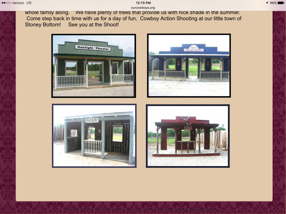

Catlow4697 Posted March 27, 2019 Posted March 27, 2019 Our club installed them 19 years ago on the cowboy range then covered them with rough cut boards to give look of fort walls.
Catlow4697 Posted March 27, 2019 Posted March 27, 2019 The two bottom photos show the walls with covering
T-Bone SASS #36388 Posted March 27, 2019 Author Posted March 27, 2019 Catlow,,,, Y'all have a very nice range..
Catlow4697 Posted March 27, 2019 Posted March 27, 2019 46 minutes ago, T-Bone SASS #36388 said: Catlow,,,, Y'all have a very nice range.. Thankyou we shot at your range a few years back and your range is very nice
