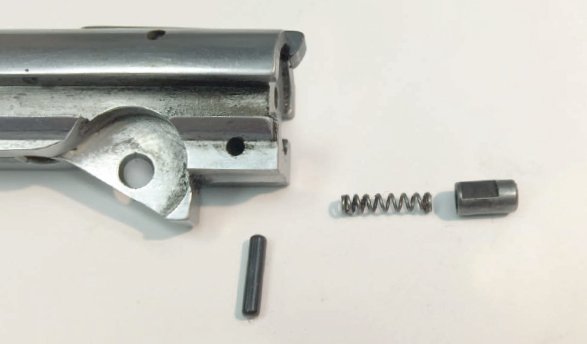

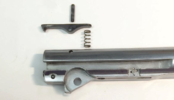

H.K. Uriah Yes, that's the story I knew about Colt and Winchester and I've heard it from a few different sources so I think it's generally accurate. Sasparilla Groz: Unlike the other Lightning clones, your Uberti Lightning has an ejector built into the bolt. It's small spring-loaded plunger that forces the shell to kick up as soon as it clears the chamber's mouth. Two things are important for good extraction and ejection: 1) the extractor must have good down pressure as it grips the shell so that it reliably pulls the shell from the chamber without releasing it early. 2) The ejector spring must be as heavy and long as the one shown here or the plunger will not have the force needed to kick out the shells. Here's what your extractor parts parts should look like (pivot pin, extractor, extractor spring bolt: Here's what your ejector parts should look like (bolt, securing pin, spring, and ejector: Note how heavy the ejector spring is. RR

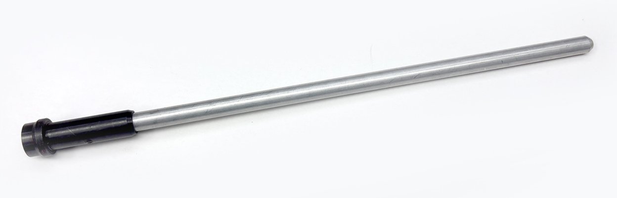

H.K. … I had not heard that Colt ceased production because of problems with the Lightning rifle functioning properly. Interesting. It was my understanding they got into a legal hassle with Winchester over making repeating rifles. And yes, I agree on removing the restrictor - what Pedersoli calls a “magazine limiting device." Here’s what the one looks like that Pedersoli used to limit the magazine to 10 rounds in their 26˝ Lightning. This restrictor weighs 475 grains compared to a loaded .45LC cartridge with an 185g bullet that weighs 310g. It’s entirely too much “mass” and it retards the movement of the cartridges in the chamber when working the rifle fast. Removing the long aluminum bar also helps to reduce the amount of force needed to load cartridges through the loading gate and into the tube. Catamount Kid…. Cartridges under the lifter are caused by a cartridge going over the cartridge stop lever and under the lifter when the lifter is up. The stop lever is the part that releases each cartridge as the action begins to open and then prevents the next cartridge from entering the lifter as the bolt continues to open. The problem is especially found with .357/.38 cartridges because the diameter is smaller than .45LC and the margin of error is greater. It’s a simple fix on the Pedersoli Lightnings because it uses an independent cartridge stop lever whose height - distance the lever comes up - can be easily adjusted. On the original Colt Lightnings, and on the Taurus, USFA, AWA, and Uberti Lightning clones, the stop lever is part of the rocker arm, and the height is not easily adjusted. However, check the reducer in the magazine - the small tube at the end of the magazine that centers each cartridge in the .357/.38 versions - to see how much slop you have around the cartridge in that reducer. You can make a new reducer with a smaller bore to make the cartridge fit more snugly in the reducer, or better yet, with the bore in the reducer being off center and positioned so that the cartridges sit lower in the tube. As a result, it would move the center of the bullet down slightly which gives you a tiny bit more bite of the cartridge stop lever to keep the cartridge in the tube. RR

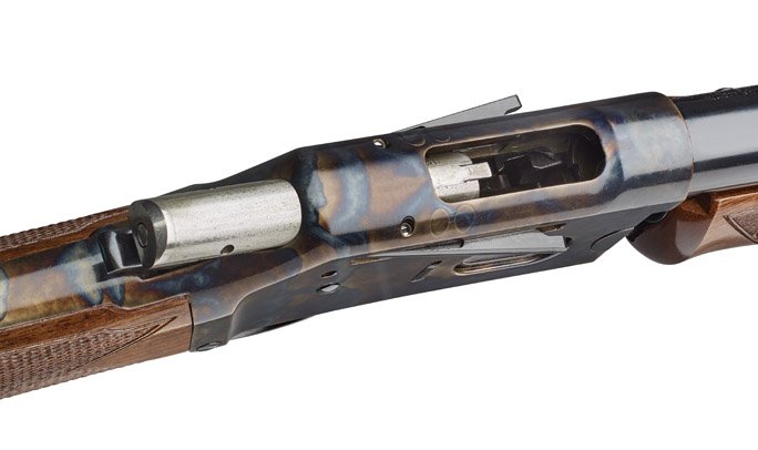

Injun Ryder... Just want to be clear ... So, the round will extract from the chamber but not eject once the bolt is moved back (opened)? Is the shell staying hooked into the extractor on the bolt when you draw the bolt back or does it just come partly out of the chamber and then separate from the bolt's extractor? Can you try putting an empty case in the chamber and slamming the bolt closed with moderate, but not extreme force? (Objective is to get the extractor to hook onto the rim of the cartridge.) RR
