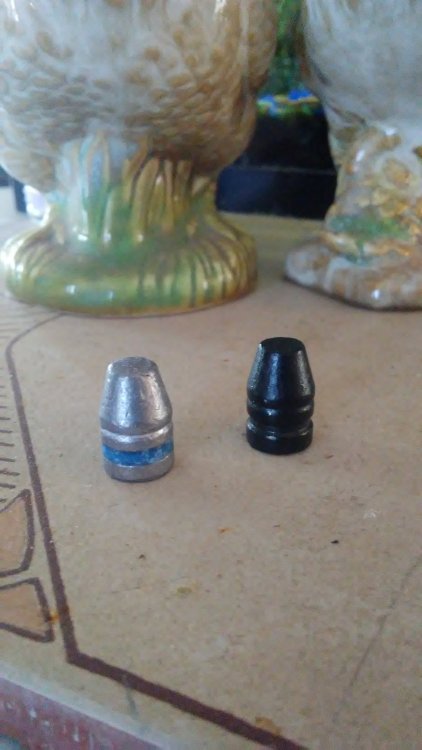

Singin' Sue 71615 Posted March 5, 2021 Posted March 5, 2021 If it helps. We use these truncated. You can see slight difference in the two...but the SDB likes them. (You may want to send back to Dillon for a refurbish, if you're looking at using it a while)
