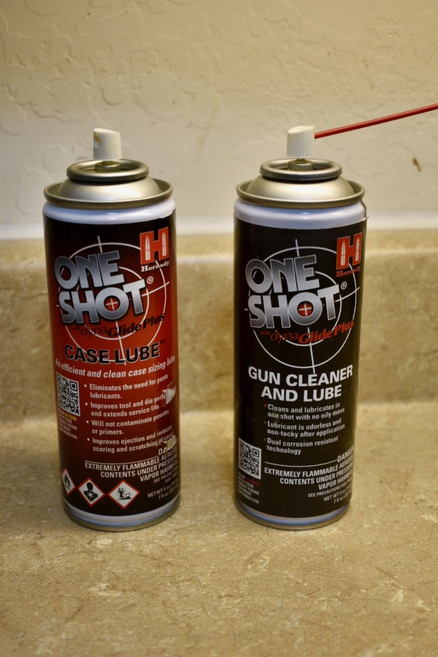

Just read the labels carefully. Hornady has “One Shot” Case Lube AND “One Shot” Gun Cleaner & Lube.
The case lube makes a poor gun cleaner and lube…guess how I know?
In case you can't read the cans are different colors. :P
Betcha I know how you know.... :rolleyes:
I get the case lube in the smaller cans and the gun cleaner/lube in the bigger ones. I don't use near as much case lube as I do the gun cleaner, so this way I ain't gotta rely on my excellent eyesight. :D
I can read just fine. I ordered 4 cans of cleaner / lube from Amazon. They sent  1 can of case lube and 3 cleaner & lube. Somehow I grabbed the wrong one and I was in a hurry and spayed the crap out of the internals of my S&W 327 NG then let it dry out. I reassembled it and took it to the range. The trigger pull was stiff.
When I got home I saw the can on the bench. That was a slap yourself in the forehead moment.
I have just put a smart*** hex on you so sometime soon you will use the wrong thing and think of this post. :P
"In case you can't read the cans are different colors. :P"
The YOU was the generic you for people reading the post.  I have been falsely hexed.:wacko:
