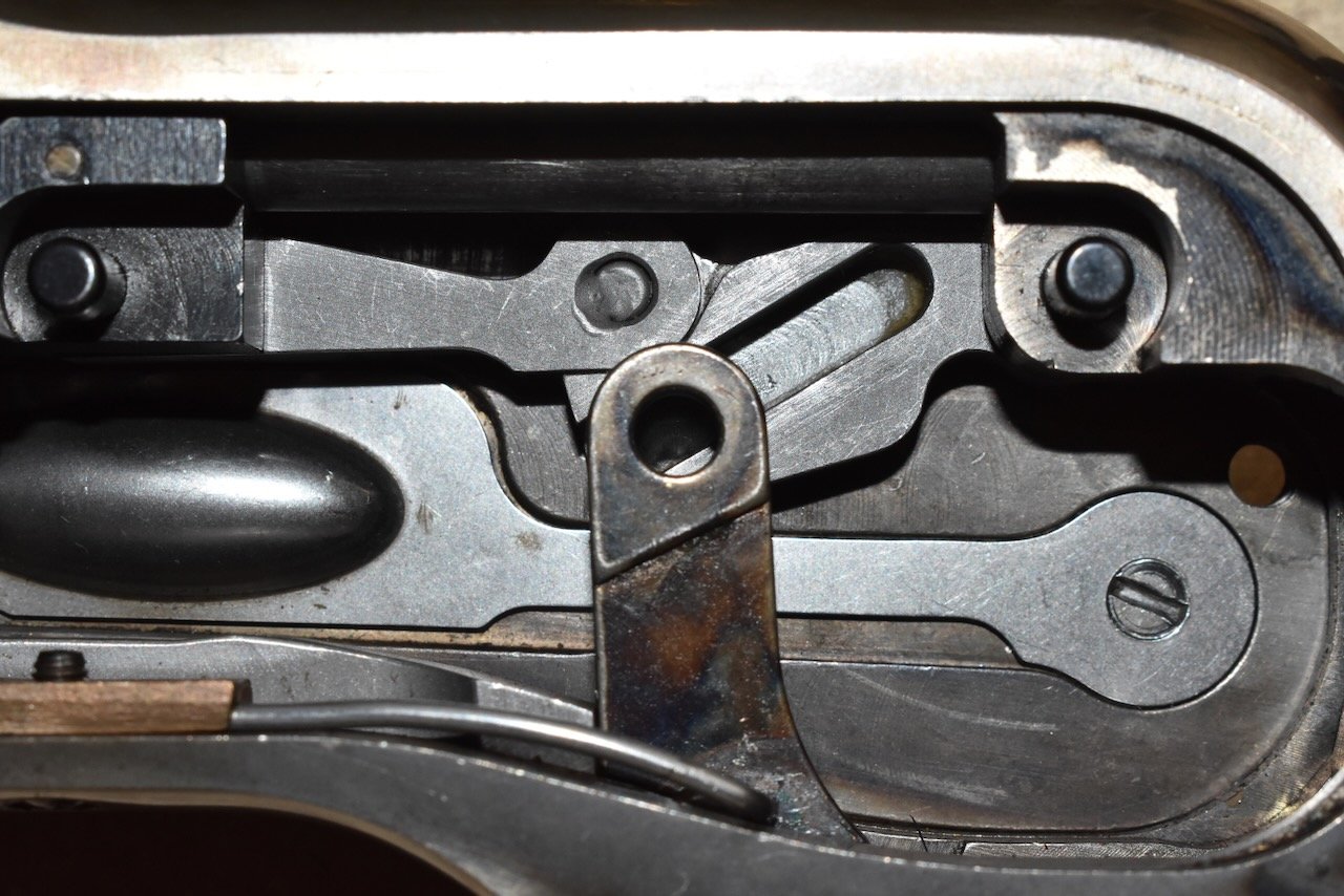

Larsen E. Pettifogger, SASS #32933 replied to Irish Pat's topic in SASS Wire
Remove the cylinder. This will release the tension between the bolt and hand. Chances are the cylinder bolt did not reset on the hammer cam because of something your young friend did. Do the basics before sending it back for "repair." P.S. Remember the basic rule of Colt. Half-cock to load. THEN fully cock the hammer. Never lower the hammer except from the full cock notch.- 15 replies
