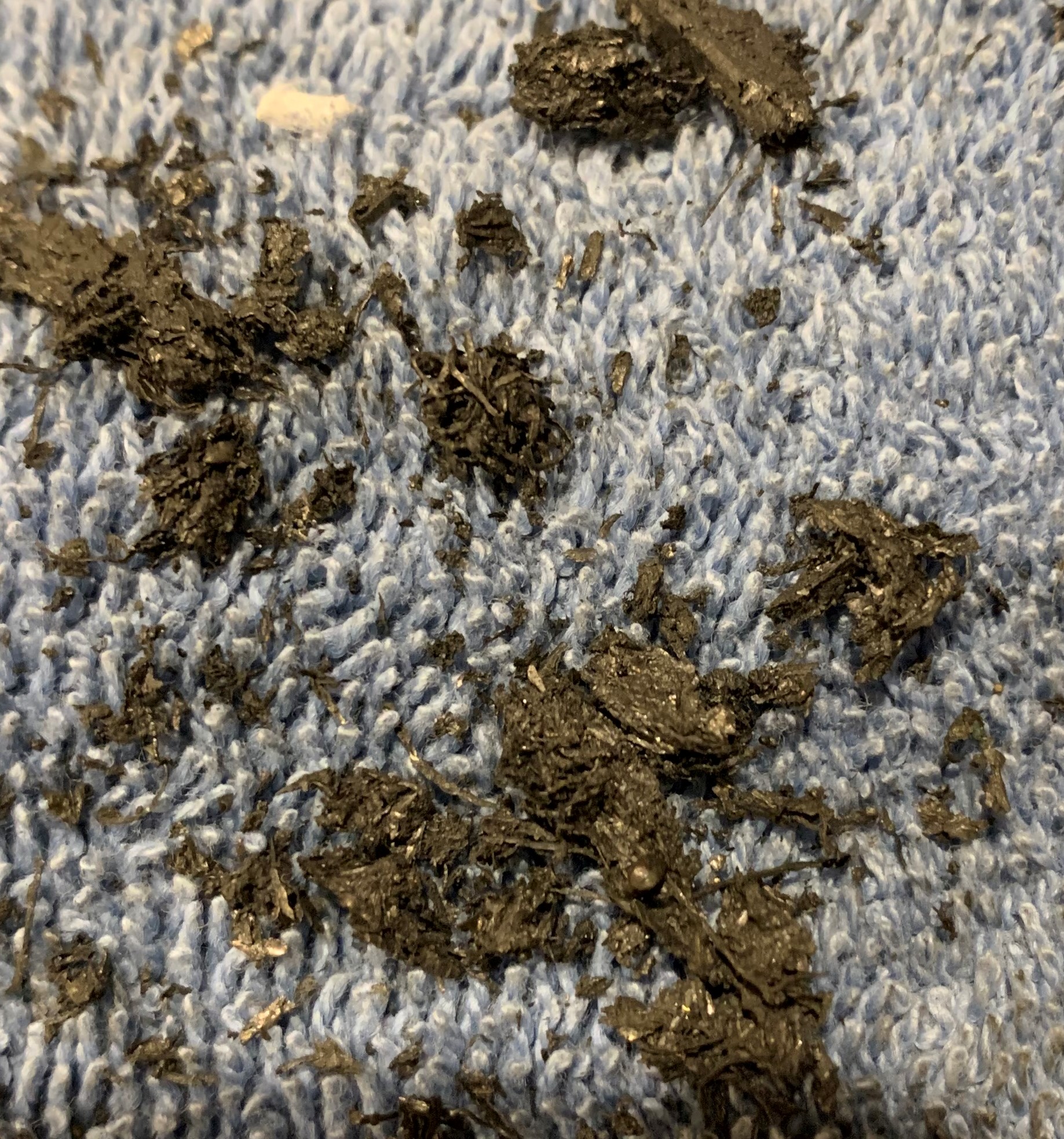

Cholla Posted March 9, 2021 Posted March 9, 2021 I cleaned a rifle I recently picked up and it literally looks like mulch inside the action. I can not fathom what this might be. I know some use grits and cream of wheat for blackpowder filler. This looks like mulch for a Barbie Dream House. I would assume any filler would go out the muzzle, not back into the gun action. >>>I think I may have figured it out. It has been recommended that I use a push stick to shove the cartridges in. Depending on what was used, I could see a soft wood or plant stem peeling against the loading gate opening. If that was done for an extended period, I can see it filling the action with the fibers I found.

PaleWolf Brunelle, #2495L Posted March 9, 2021 Posted March 9, 2021 Have you asked the seller about what it might be? How/where had it been stored? Send to a lab for analysis? Smell? Taste?
Cholla Posted March 9, 2021 Author Posted March 9, 2021 It's nice to know everyone else is mystified as well. It was so packed in that as I slowly stripped the action down I was uncovering springs and other pieces. I also found strips of what looked like copper foil.
Cliff Hanger #3720LR Posted March 9, 2021 Posted March 9, 2021 I would ask the same questions as Palewolf. My first impression is the rifle was stored muzzle up and no cover. This appears to be dust, dirt, yard clippings that have fallen down the barrel in to the receiver. Maybe mice making a nest some where above the barrel. As long as it has not gotten wet and rusted in the rifle, it should clean up.
Abilene, SASS # 27489 Posted March 9, 2021 Posted March 9, 2021 What was the bore like? And the outside of the rifle, for that matter.
Cholla Posted March 9, 2021 Author Posted March 9, 2021 Just now, Cliff Hanger #3720LR said: I would ask the same questions as Palewolf. My first impression is the rifle was stored muzzle up and no cover. This appears to be dust, dirt, yard clippings that have fallen down the barrel in to the receiver. Maybe mice making a nest some where above the barrel. As long as it has not gotten wet and rusted in the rifle, it should clean up. It cleaned up great but it took totally dismantling the action and soaking everything in Dawn and hot water. I doubt I will ever know the true source. As I understand it, the pard I got it from bought it from a very ill (terminal) shooter to help him out. I got a good deal so I'm not complaining.
Cholla Posted March 9, 2021 Author Posted March 9, 2021 2 minutes ago, Abilene, SASS # 27489 said: What was the bore like? And the outside of the rifle, for that matter. The bore looks like new. All the parts look perfect except for some bluing wear. I learned every wrong way to assemble a Lightning but it cycles like a champ now.
Singin' Sue 71615 Posted March 9, 2021 Posted March 9, 2021 Don't laugh...but, insect? Maybe a mud-dauber nest.... Moths? Really looks like decayed moths once I enlarged it.

Cholla Posted March 9, 2021 Author Posted March 9, 2021 When I was soaking the parts, the pieces softened and looked very much like fibrous plant matter.

Garrison Joe, SASS #60708 Posted March 9, 2021 Posted March 9, 2021 Maybe the original owner used dry grass clippings and toothpaste as an action tune-up compound. Does it smell minty? Try rinsing some of that sludge to see if there is hay or straw strands in it. I could imagine dust and barn chaff combining to fill up the action if it had been a "barn gun." good luck, GJ
Abilene, SASS # 27489 Posted March 9, 2021 Posted March 9, 2021 How did it feel cycling the action before and after?

Cholla Posted March 9, 2021 Author Posted March 9, 2021 All the debris went out in the trash so I won't be doing an investigation. The action was sticky before and slick now. >>>I think I may have figured it out. It has been recommended that I use a push stick to shove the cartridges in. Depending on what was used, I could see a soft wood or plant stem peeling against the loading gate opening. If that was done for an extended period, I can see it filling the action with the fibers I found.

Go West Posted March 9, 2021 Posted March 9, 2021 There are a lot of people who don't know how to take apart a Lightning and put it back together. I'm sure a lot of them spray it down and call it good. Lightnings love to be clean however, with some wanting this more than others. Your guess about a push stick having pieces scraped off is as logical as any and I bet the gun wasn't disassembled and cleaned either. I took the bristles off a toothbrush and wrapped the handle with leather to make a "period correct" push stick for the wife years ago. After getting another Lightning, I made another but didn't bother with the leather wrap.
doc roy l. pain Posted March 9, 2021 Posted March 9, 2021 1 hour ago, Go West said: There are a lot of people who don't know how to take apart a Lightning and put it back together. I'm sure a lot of them spray it down and call it good. Lightnings love to be clean however, with some wanting this more than others. Your guess about a push stick having pieces scraped off is as logical as any and I bet the gun wasn't disassembled and cleaned either. Though I don’t know the exact composition of what was in your rifle, Go West hit the nail on the head. Sometimes a lightning can be intimidating to take apart and put back together. Because of this, many shooters just spray down and blow with compressed air or just hose down and think they get em clean. Over time it keeps building up into the condition that you found. The Pedersoli’s are nice rifles and will run but, they must be kept clean to function properly and a tear down is part of that cleaning process.
Eyesa Horg Posted March 9, 2021 Posted March 9, 2021 Seems like an awful lot of crud to have come from a push stick. He must have gone thru a lot of them.

Go West Posted March 9, 2021 Posted March 9, 2021 I was going to suggest pot like CS did, but I do know that guns with blowby can accumulate an enormous amount of crud.
