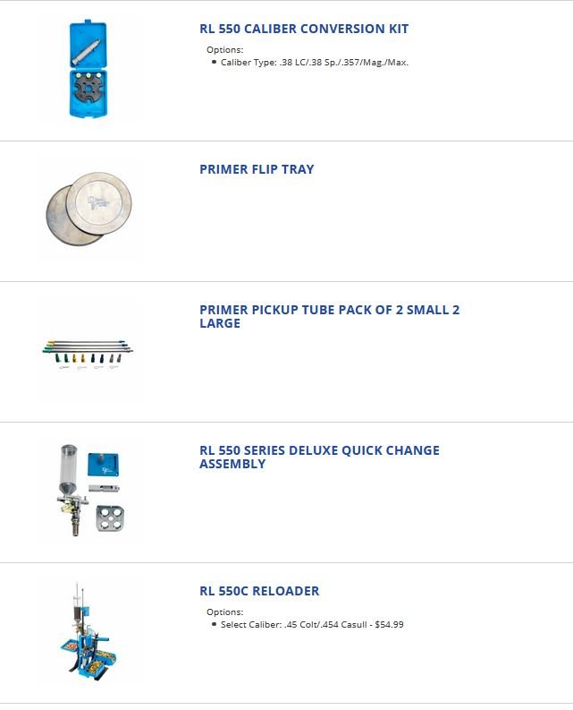

Lucky Lead Pepper Posted January 7, 2021 Author Posted January 7, 2021 Here's my cart. I can use my Lee dies with this until I decide differently.

Cypress Sun Posted January 7, 2021 Posted January 7, 2021 22 minutes ago, Lucky Lead Pepper said: Here's my cart. I can use my Lee dies with this until I decide differently. I personally don't like the Dillon primer flip tray. Probably just me though. Midway has plastic primer trays for 1/5 of the price. I use the green RCBS tray. See below for the Midway flip trays. If you really want a Dillon flip tray, I'd sell you mine for $20.00 shipped. Otherwise, I think you've made a fine selection. primer flip tray - MidwayUSA
Lucky Lead Pepper Posted January 7, 2021 Author Posted January 7, 2021 3 minutes ago, Cypress Sun said: I personally don't like the Dillon primer flip tray. Probably just me though. Midway has plastic primer trays for 1/5 of the price. I use the green RCBS tray. See below for the Midway flip trays. If you really want a Dillon flip tray, I'd sell you mine for $20.00 shipped. Otherwise, I think you've made a fine selection. primer flip tray - MidwayUSA Good call, I hadn't considered cheaper flip trays. I'll drop that out of my cart and get an RCBS.
Barkeep Casey Posted January 7, 2021 Posted January 7, 2021 39 minutes ago, Lucky Lead Pepper said: Here's my cart. I can use my Lee dies with this until I decide differently. I would recommend the press stand and the bullet tray. They are shown in the pic with the loader but are extra's. Also the low primer sensor if it still doesn't come with the press is really handy.

Lucky Lead Pepper Posted January 7, 2021 Author Posted January 7, 2021 I pulled the trigger. I ordered the 550C with extra primer pickup tubes, caliber conversion kit, and deluxe quick change assembly. It should all be here tomorrow...I wish. I'm thinking I will probably order a KMS Squared UFO lighting kit for it too, anyone use that light setup? Thanks for all of the insight and suggestions from everyone!

Griff Posted January 7, 2021 Posted January 7, 2021 You'll also want to get their spare parts kit for the press. It's full of stuff you can lose, break or mutilate... nothing they won't replace under warranty... but without the mail delay!

Sedalia Dave Posted January 7, 2021 Posted January 7, 2021 7 hours ago, Lucky Lead Pepper said: Here's my cart. I can use my Lee dies with this until I decide differently. Order a second primer feed assembly. Set one up for small pistol and the other up for large pistol.

Gateway Kid SASS# 70038 Life Posted January 8, 2021 Posted January 8, 2021 4 hours ago, Lucky Lead Pepper said: I pulled the trigger. I ordered the 550C with extra primer pickup tubes, caliber conversion kit, and deluxe quick change assembly. It should all be here tomorrow...I wish. I'm thinking I will probably order a KMS Squared UFO lighting kit for it too, anyone use that light setup? Thanks for all of the insight and suggestions from everyone! Just bought the UFO lights for the 650 & the 550 I use. Only question I had is why didn’t I get these years ago? Ten minutes each to install and these tired old eyes are really, really happy!! No strain no glare. Order to delivery three days. Regards Gateway Kid
