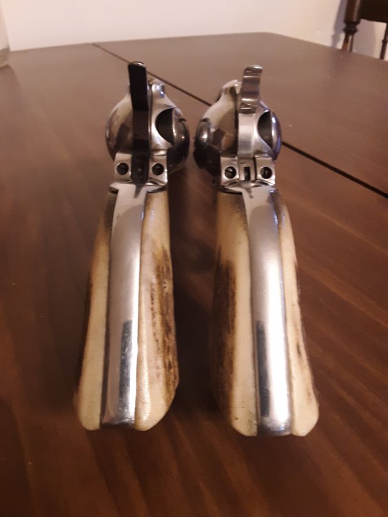

evil dogooder 1,005 Posted December 19, 2020 Share Posted December 19, 2020 (edited) Grips are probably the most important but overlooked part of shooting revolvers well. . Im fairly proficient at gf and it's what I will pretty much always shoot. Try all the guns you can get your hands on. Take two identical guns, use different grips on them and they will feel totally different. My personal opinion is while you can shoot any stock grip properly, you'll never be as fast as if you have custom grips built. They aren't expensive, and there are a lot of competent makers. Or you can do it yourself. Get oversized blanks and slowly remove material. The first pic is my main match guns. The grips are different. Swells are in different places To fit my hands. They are wider and I've prepped the surfaces. I cant stand the narrow gf grips. I've had multiple surgeries on my left hand so I made them work for it. The blued guns are 45s and recoil more so I did a different style to help with it. Also material makes a HUGE difference in feel, balance, and grip. I do not use grip powder, as I personally dont see any advantage to it. I wouldn't recomend plastic grips for anything. I have guns with them but if I plan on actually using the gun I swap grips out. Edited December 19, 2020 by evil dogooder 1 Quote Link to post Share on other sites
