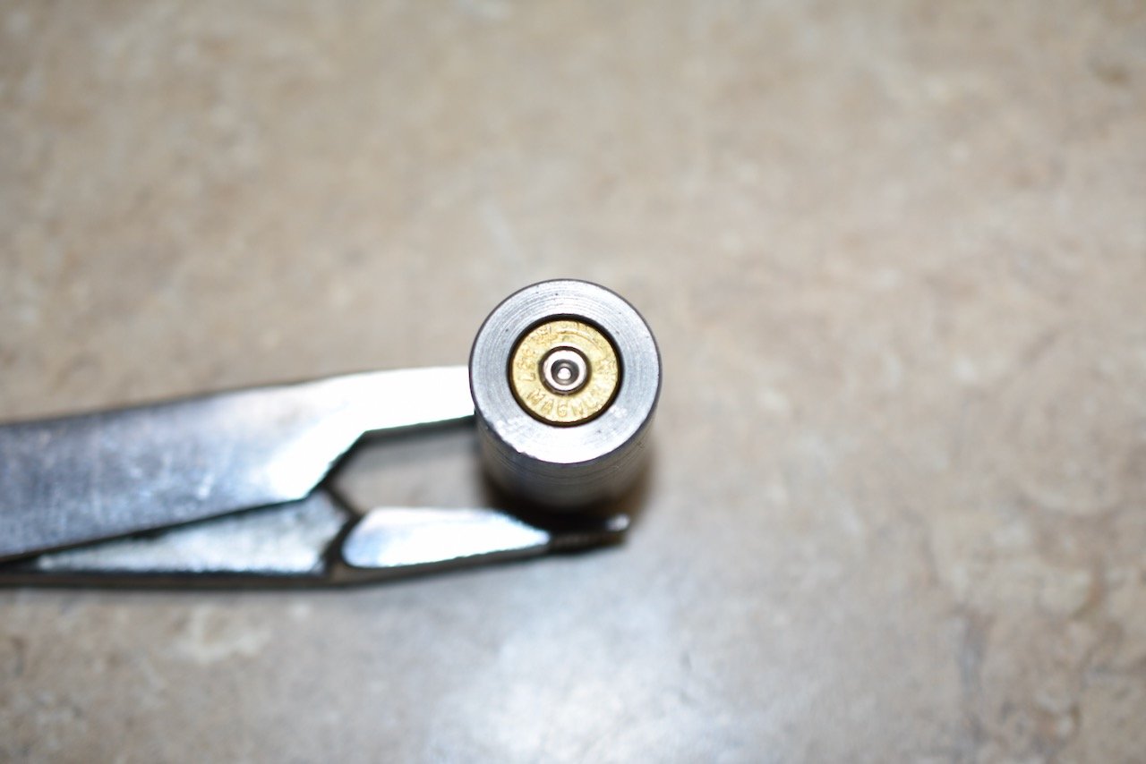

Larsen E. Pettifogger, SASS #32933 Posted April 30, 2022 Posted April 30, 2022 After adjusting everything many times I finally made a "rim" gauge over 20 years ago. I just dropped the brass through the gauge and if it did not drop through I put it aside. It quickly became apparent the brass was at fault. Crap brass from the range with gouges in the rim or some crap brass manufacturers got mixed in with my regular brass. The worse is AMERIK. Lots of European stuff is also out of spec. Solution, I try to load only Starline or Winchester and toss the other crap. Also, if you have one of those after market plastic index ball and super light spring kits I would put the steel ball and stiffer spring back in to make sure the shell plate is fully indexed and aligned.
