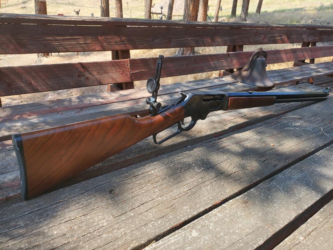

Three Foot Johnson Posted April 17, 2022 Posted April 17, 2022 19 minutes ago, Widder, SASS #59054 said: I shouldn't tell this, but TN Williams and I have a pair of Marlin 1895 COWBOY's in .45-70 which we plan to compete with in future months. Plus, TN has a couple other 45-70's he'll probably dust off and shoot a little. All this info posted above will help us greatly. THANKS, everyone! ..........Widder If you're going to stretch the range out, put a decent sight set on 'em. I've got MVA on my 1895 and Lee Shaver on a couple of Sharp's. Still waiting on another MVA for my Chiappa Little Sharps .22 - 9 1/2 weeks and counting... a year and a half ago, this one only took 3 weeks, 3 days... maybe I should shoot them an email.
