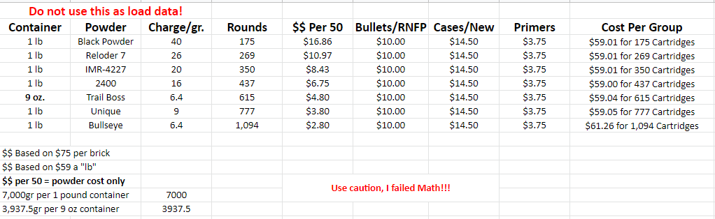

1 hour ago, Savvy Jack said:
Did I do this correct? Other than old prices. I still missed something somewhere.
Based on 44-40 loads
So what you're saying is that Trail Boss is not the cheapest or most expensive powder per 50 rounds, all else being equal.
Link to comment
Share on other sites
 am still not quit sure what I was trying to say cept it looks like black powder loads yield the most expensive handloads and Bullseye the cheapest? My brain still hurts.
I think is is obvious that "bulk" powder loads cost more to shoot compared to "light" powder loads.
Link to comment
 Some are more efficient than others not a good way to figure out costs. Try again.;)
