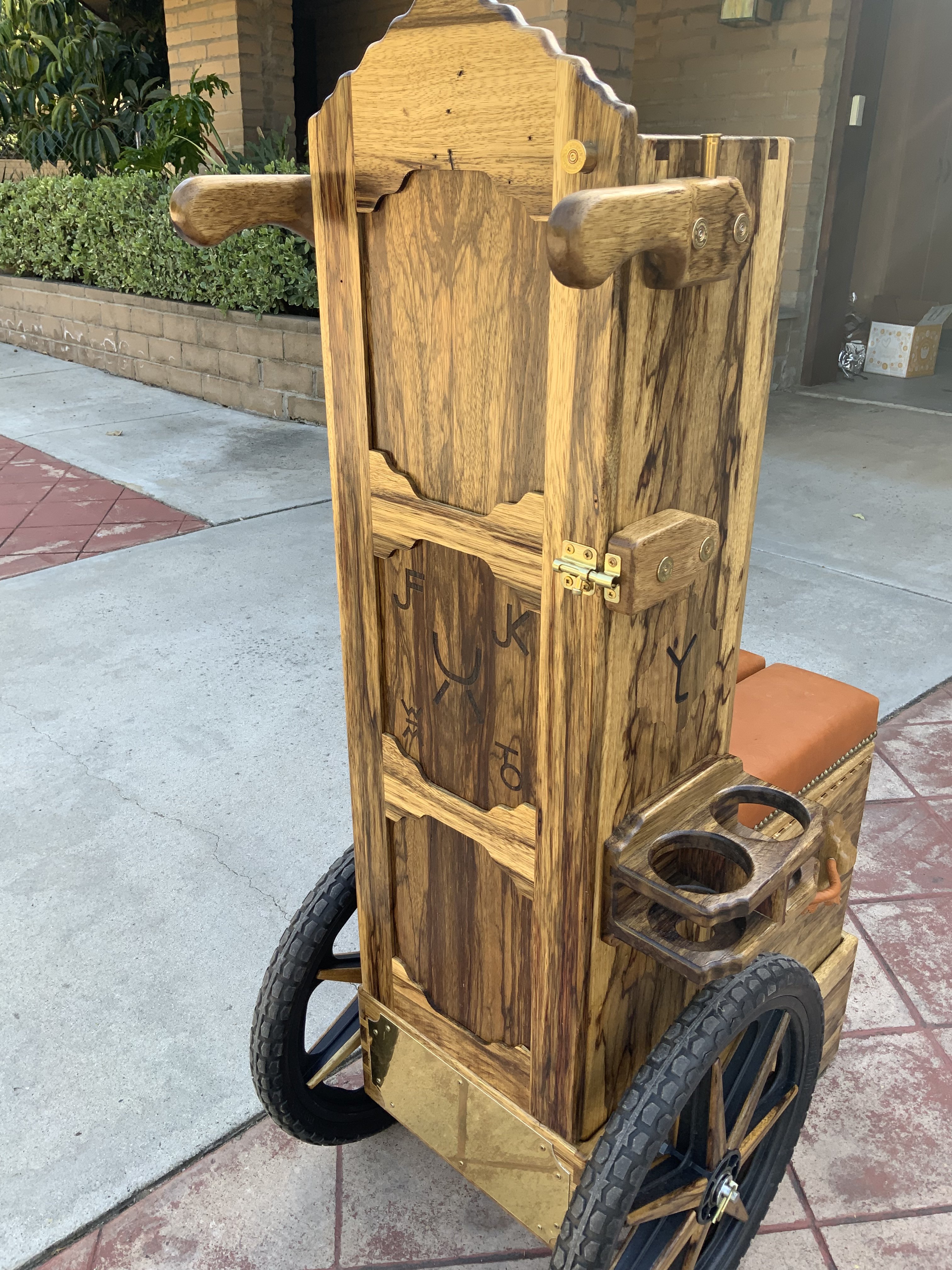

Yul Lose Posted April 21, 2022 Posted April 21, 2022 This gun cart was built for a shooter and his wife and they wanted it to reflect the Texas family ranching history by showing the various family cattle brands. My pard Trainwreck and his son did the laser layout and engraving and Double Diamond did all of the leatherwork. Notice the brands on both sides of the cabinet are branded on inlays. The lumber I used is African black limba. The steer skull drawing on the front of the chest is a drawing of a skull that was found on the family ranch a number of years ago and they wanted it included on the cart, it is lasered on an inlay also. Through dovetail and sliding dovetail joinery and mortise and tenons where needed were used. The trays feature an ammo tray with two SG shell box wells and room for R&P cartridges. Notice the finger notches on the tray dividers, all you have to do is fold the flaps back on a box of shells and drop it in the well and your all set. When the shells are gone lift up a tray and get another box of shells and exchange it for the empty box. Under the trays is an ammo strip bin that will hold 10 loaded or empty ammo loading strips. Pull a loaded one out shoot the stage and then lift the tray up and put the empty strip back where it came from and pull another loaded one for the next stage. There is also a small 6 pack soft sided cooler that fits in the bottom of the chest. On the inside of the cabinet door there are 2 sets of holsters and a SG mop and brush holder. The locking bar to keep the long guns in place is locked in place in the down position with a rare earth magnet and then another magnet holds it in the up position when your pulling your long guns or putting them away. The cabinet is held to the carriage with a hinge pin and is very easy to remove and reinstall.

Chancy Shot, SASS #67163 Posted April 21, 2022 Posted April 21, 2022 Very very nice. As a matter of curiosity, is there room in the cabinet to keep a SXS open or does it need to be closed to shut the door? Thanks for sharing. Chancy
Yul Lose Posted April 21, 2022 Author Posted April 21, 2022 Open or closed. Since it’s in a cabinet and out of sight most keep them closed.

Yul Lose Posted April 23, 2022 Author Posted April 23, 2022 On 4/21/2022 at 8:47 AM, Tex Jones, SASS 2263 said: Yul, Don't you ever make anything less than a work of art? I guess building gun carts is my form of artistic expression. Exposed dovetail joinery to me is very artistic and I try to feature that in every cart. Even the carts with no embellishments on the chest front or other places I hope the joinery and wood that I use come across as art to some people. Thank you for all of the kind comments, everyone.
