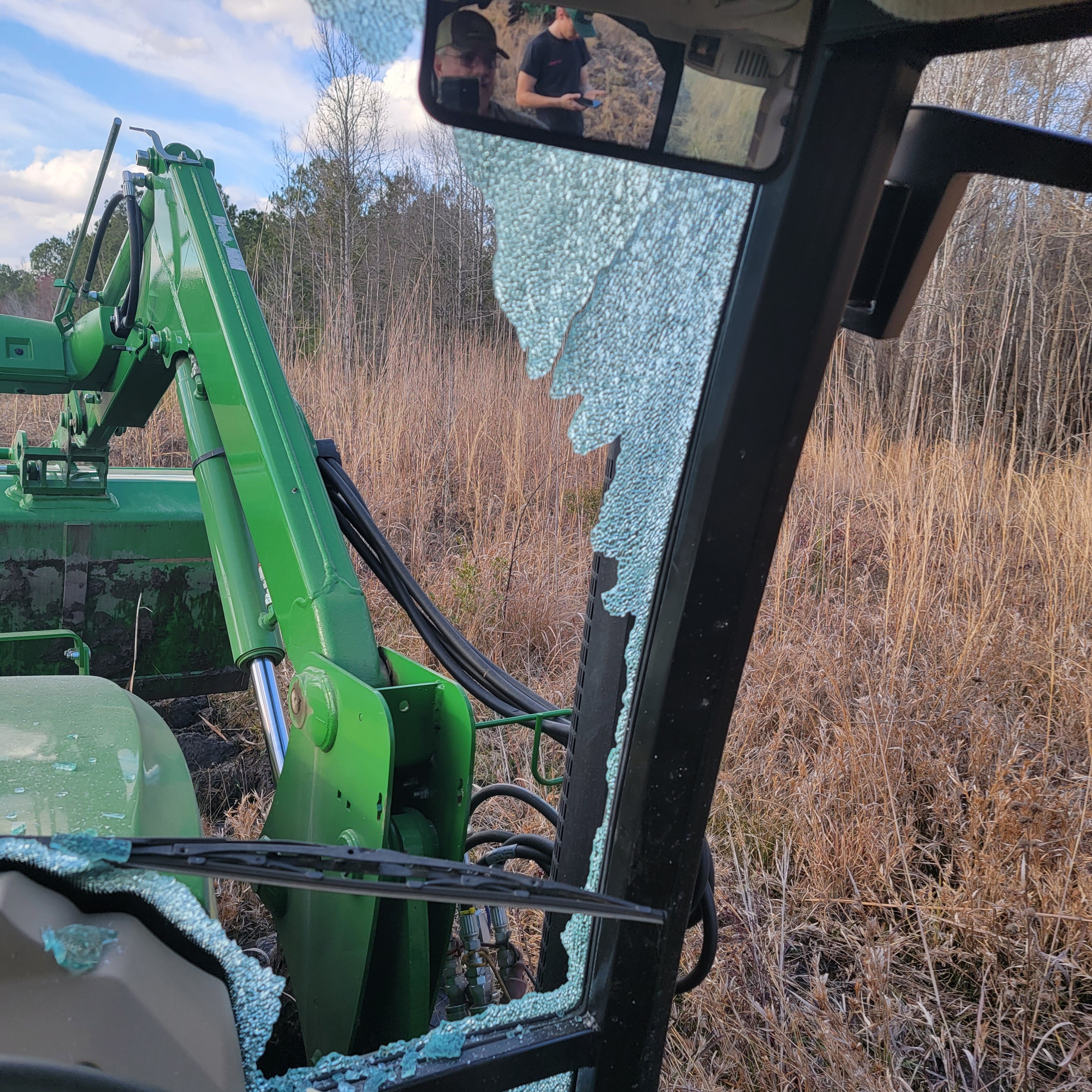

My son had just returned from school.   He came out with a bigger tractor.  We hooked up the Bubba rope and tried several times.   We then pulled the harrow off and tried again.   We were making progress.   Then I heard a loud BOOM and realized the Bubba rope had broken free from his tractor and flew thru the back glass and went past my head and busted the front window.   4 windows total.
I had multiple cuts on my right arm.  Glass in my teeth, though small.  Glass just under my eyes and hair and in my mud boot.  I accidentally swallowed the tiny glass in my mouth.
God sure did look out for me.
Toss a heavy tarp over the center of a tow rope/cable, it takes the energy of the rope parting.

Why I’ve always liked using chains , when they break they typically just drop , cable can get pretty nasty when it lets loose also .
My dad told me he once saw cable bury in the armor plate of a tank when the cable from a tank retriever broke

When I was in school, the dad of one of my class mates wound up in a wheel chair from using one of those snatch ropes.  In his case the clevis pin failed and the recoil of the rope propelled the clevis into the seat of the tractor he was driving. The force of the impact sheared the seat off just above the rockshaft on a JD 4020. Shoved him and the seat into the console, shattering his pelvis and both femurs as well as breaking several ribs.
Haven't used one of those things since.
We used two good log chains with an old tire between them. The tire adsorbs any shock and prevents the chain flying should something break.
I do frequent heavy logging with very big skidding and log loading tractors on steep terrain, up to 70% slopes.  Broken choker chains and heavy cables are more commonplace than most people would expect, and failures of either can easily can be fatal to a driver, crew or bystanders .   They snap without warning, and do not allow ANY reaction/avoidance time.
 When doing linear pulling,  ALWAYS place a dampener across the middle of the pull line in at least one and preferably two places, as Garrison Joe described above.  The dampener can be a heavy tarp, or on heavy jobs it can be a log, second choker chain, or anything else with enough mass to dampen the snap of the pull line so that its whipping end cannot reach the driver before it becomes de-energized.  A broken choker cable or chain can easily and instantly decapitate a driver, and as you learned, the windows offer little protection.
I will not skid logs on cables or chains without a proper forestry cage for the driver.  if the tractor has a bucket, pull in reverse and position the bucket or blade up high, between the load and driver.
I've seen some very bad accidents in the past.  Please heed this advice wheneve heavy pulling or winching.
I do not like using synthetic ropes or straps for towing or winching. If I have to, I do as Garrison Joe described. I put a tarp or even a rolled up bunch of rope over the tow rope to keep it from flying if it snaps.
When I was in the Navy a synthetic line snapped when a Tender was tying up to the dock directly across the pier from our ship. I heard the shotgun like crack of the line snapping. I heard a scream and yelling. I saw blood streaming over the side of the ship. A sailor on that ship lost his legs. He did survive.
Helluva lesson for everyone on where to stand when taking up slack and pulling the line taut with a capstan.
We were taught “When using synthetic line stand clear & outside the line away from the railing. When using natural line stand inside the line closer to the ships railing”.

That's why we put an old truck tire between two high quality chains. It acts as a shock absorber without the hazards of synthetic rope.

I bought a tarp today for the next time.  I also told my son, next time we will use the loader to raise the front, tie off on the front axle and use the loader to run interference in case it breaks.
