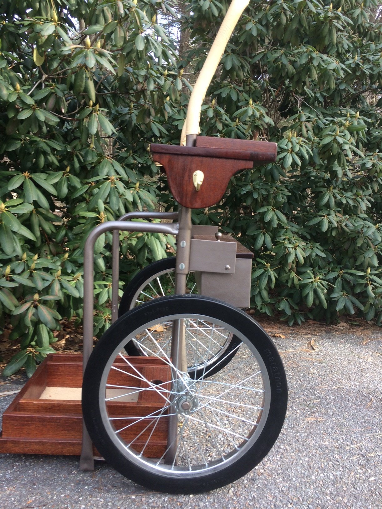

Loophole LaRue, SASS #51438 Posted December 14, 2020 Posted December 14, 2020 Actually, the welding cart works great. I made everything removeable (ammo box, bottom box, handle, wheels) using a mix of large headed thumb screws and axle split pins. It takes me less than 5 minutes to assemble/disassemble. or less if I'm using a larger vehicle. Mine will hold four long guns, two days of ammo, a small cooler, necessaries, holsters, and a large umbrella. The wood is mahogany left-overs from my shop. Ammo box, bottom box and loading shelf lined with felt. Handle and barrel slots wrapped in leather. I replaced the wheels with a foam-filled pair; no more flats. This design rocks back with the touch of a finger; lightweight and agile. The secret is the low center of gravity and the oversized wheels. LL

Tequila Shooter Posted December 14, 2020 Posted December 14, 2020 I’ve always liked the idea of the welding cart for guns. I think if you’re a good woodworker or a really good welder you can make it work nicely. When you look at the cart @Loophole LaRue, SASS #51438 built it’s obvious that he has the woodworking down and also some good vision on what he needs and how to make it work. There is a lot of trial and error with your first cart, but as Noz said is a good start.

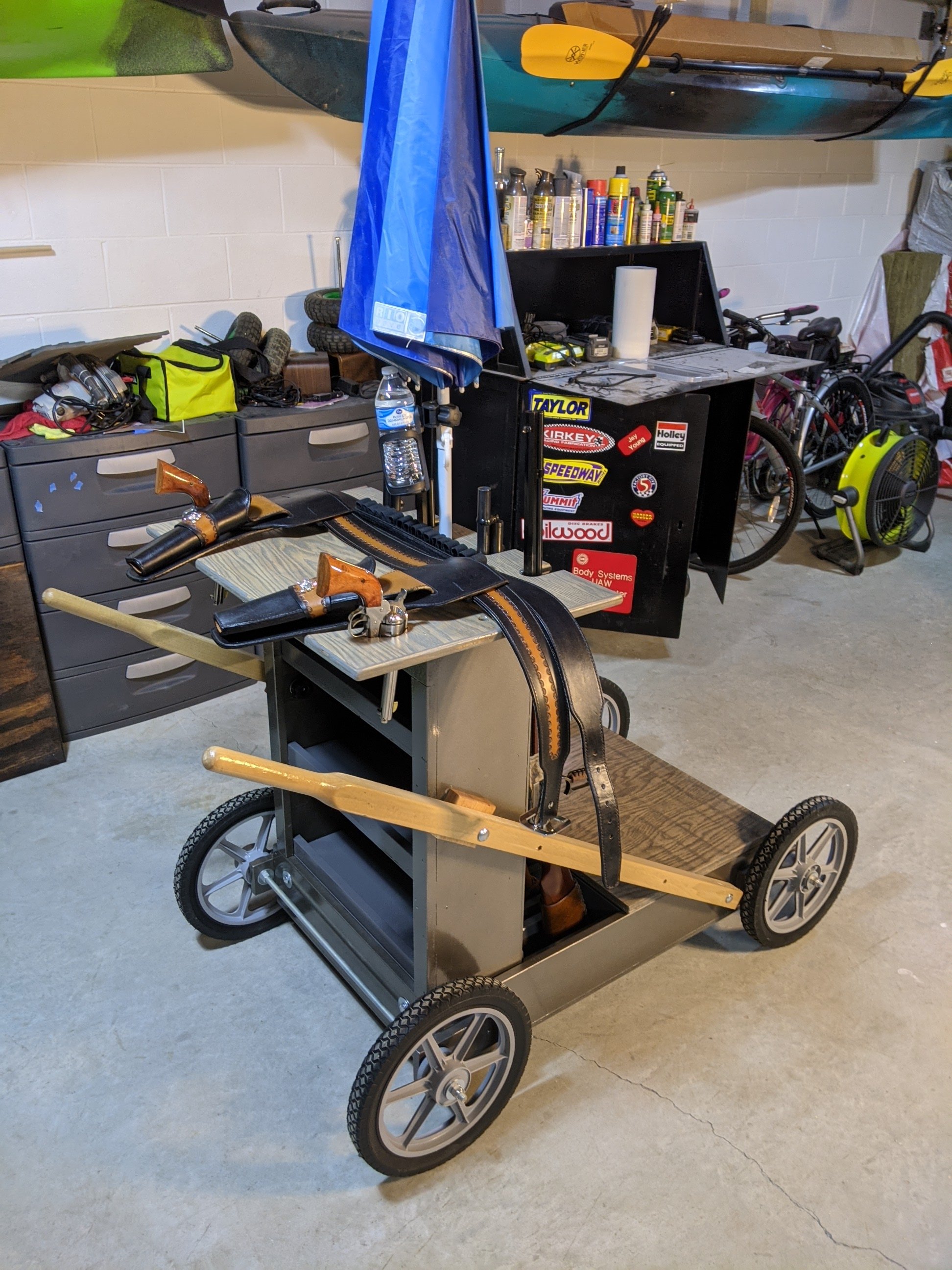

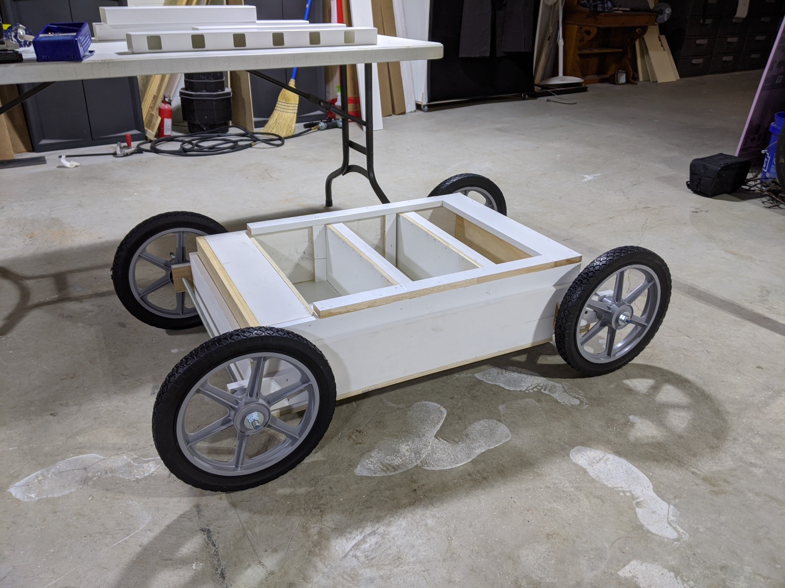

Mister Badly Posted December 14, 2020 Posted December 14, 2020 I just built this one with some wood I had. The upright fits in the base and the top fits in the upright as the shelves are removable. The buttstock holder also is removable and fits in the upright. There is storage under the front cover. The wheels are 14".

Grass Range Posted December 14, 2020 Posted December 14, 2020 50 minutes ago, Mister Badly said: Room for sweat mitigation devices. Does the fan have enough power to pull the cart?

Mister Badly Posted December 14, 2020 Posted December 14, 2020 26 minutes ago, Grass Range said: Does the fan have enough power to pull the cart? No but if it's hot enough someone might volunteer to push it for me. Lol
Dirty Dog Doug Posted December 14, 2020 Posted December 14, 2020 1 hour ago, Mister Badly said: Room for sweat mitigation devices. I have dewalt battery fan that has saved me in the Summer my BP pills have me overheating soo fast

Tequila Shooter Posted December 14, 2020 Posted December 14, 2020 I made one from a baby jogging stroller and learned an important lesson. I mounted the long guns towards the back, and put a removable wooden box over the front wheel. The box makes it tippy to use on steep slopes. On my winter to do list is to re-make the cart so the box is behind the front wheel.
Mister Badly Posted December 15, 2020 Posted December 15, 2020 I did a jogger and still have it. I may modify it with a second swivel front wheel for stability.
