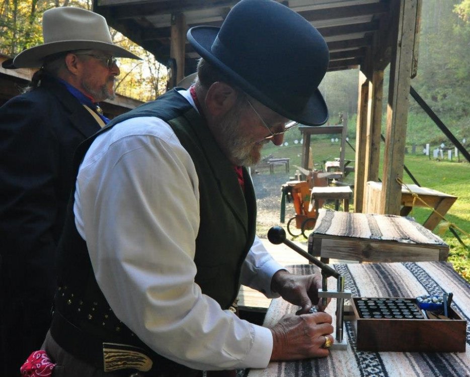

Lucky R. K. Posted October 14, 2019 Posted October 14, 2019 1 hour ago, July Smith said: If I had a pair of Ruger OMAs or Remingtons I might consider simply having an extra set of cylinders and loading off of the gun on one of those presses I have seen some shooters using. If you want to shoot cap guns and work the posse a loading press is a must. I shoot ROA's and Pietta '51's, mostly the '51's, because they are lighter and easier to handle. Unless the posse is really small I can reload and still have time to work before the stage is over.

Jed I. Knight, SASS #36423 Posted October 28, 2019 Posted October 28, 2019 As has been mentioned already, most often I see Frontiersman loading their cylinders at the Unloading Table and checking folks as they come off the firing line. As for me, when I shoot Plainsman, while... I cheat a little. I have enough cylinders to get me through a match so I just swap ‘em out lickity-split at the unloading table and go about my regular posse duties (heckling shooters and the like).
