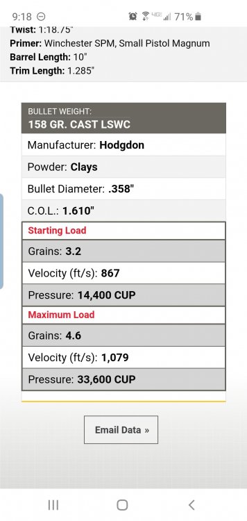

Tyrel Cody Posted April 12, 2019 Posted April 12, 2019 If you've got any Clay's I'd suggest 3.2-3.4 gr would be a pretty good load.

Shifty Bob Posted April 12, 2019 Author Posted April 12, 2019 5 minutes ago, Tyrel Cody said: If you've got any Clay's I'd suggest 3.2-3.4 gr would be a pretty good load. Is this 357 case?
Tyrel Cody Posted April 12, 2019 Posted April 12, 2019 4 minutes ago, Shifty Bob said: Is this 357 case? Yes http://www.hodgdonreloading.com/data/pistol Pick .357, 158 gr bullet and it'll give you all kinds of loads. Trail Boss is in there as well; 3.5 gr of that is probably good but stay towards the middle range with TB.

Shifty Bob Posted April 12, 2019 Author Posted April 12, 2019 Gee all great advice. I am stuck with a few things from not so great advice that doesn't match what you all have advised here. (I should have asked here first!) I have a large amount of: 357 brass 158 GR lead RNFP TRAIL BOSS Should I work with this or change one of the components. $
Tyrel Cody Posted April 12, 2019 Posted April 12, 2019 1 minute ago, Shifty Bob said: Gee all great advice. I am stuck with a few things from not so great advice that doesn't match what you all have advised here. (I should have asked here first!) I have a large amount of: 357 brass 158 GR lead RNFP TRAIL BOSS Should I work with this or change one of the components. $ Use the Trail Boss and 158gr bullets. When you use up the bullets, don't buy anymore that size; switch to 125gr or lighter. Personally I'd use the Trail Boss up too and never buy any more, but that's just me. I'd probably switch to 38 cases at some point as well.
Michigan Slim Posted April 12, 2019 Posted April 12, 2019 4 minutes ago, Shifty Bob said: Gee all great advice. I am stuck with a few things from not so great advice that doesn't match what you all have advised here. (I should have asked here first!) I have a large amount of: 357 brass 158 GR lead RNFP TRAIL BOSS Should I work with this or change one of the components. $ Use what you have. Because you have it. Your not going to slow yourself down with a very little increase in recoil. TB is good powder, 158 are good bullets, .357 cases run in your guns. All good stuff.
