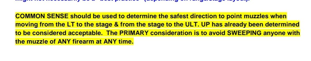

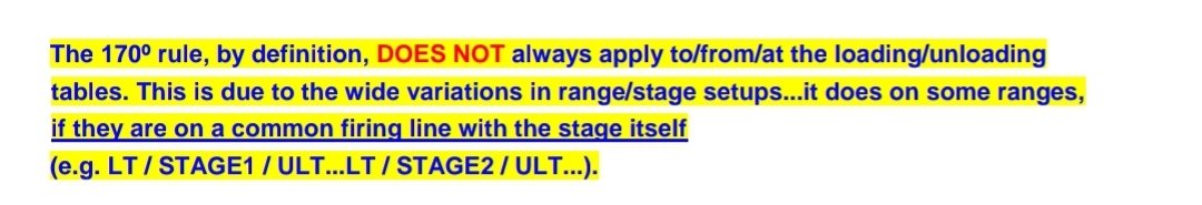

PaleWolf Brunelle, #2495L Posted July 21, 2022 Posted July 21, 2022 READ THIS: 170 DEGREE RULE BTW..."STRAIGHT UP" is actually in violation of the 170. Sounds like a *********** call to me.

McCandless Posted July 21, 2022 Posted July 21, 2022 "COMMON SENSE should be used to determine the safest direction to point muzzles when moving from the LT to the stage & from the stage to the ULT. UP has already been determined to be considered acceptable. The PRIMARY consideration is to avoid SWEEPING anyone with the muzzle of ANY firearm at ANY time." If all is as originally posted, then "By the book" this may have been a correct call... but they sorta left out the "COMMON SENSE" and "PRIMARY consideration" part.

Mister Badly Posted July 21, 2022 Posted July 21, 2022 What is the 170 when you are exiting the firing line and the TO, spotters, brass pickers and target resetters are moving in to ready the stage for the next shooter. People are to my left, right, front and back. My pistols are holstered and my long gun actions are open.
PaleWolf Brunelle, #2495L Posted July 21, 2022 Posted July 21, 2022 18 minutes ago, Creeker, SASS #43022 said: AFTER the stage is completed... WITH action open... Barrel/ muzzle pointed STRAIGHT upwards (straight upwards is 10 degrees past the 170) while moving to the unloading table... ASSUMING the op is accurately describing the incident... And the barrel NEVER passed beyond STRAIGHT up (never pointed rearward even by one degree?) That's not what the OP stated. Quote "...after completing his stage caried the rifle back to the unloading table straight up however as he was walking to the unloading table the gun was tilted about 10 degrees back. The shooter was then issued a stage DQ for breaking the 170."
PaleWolf Brunelle, #2495L Posted July 21, 2022 Posted July 21, 2022 7 minutes ago, Mister Badly said: What is the 170 when you are exiting the firing line and the TO, spotters, brass pickers and target resetters are moving in to ready the stage for the next shooter. People are to my left, right, front and back. My pistols are holstered and my long gun actions are open. Please READ the referenced document.

PaleWolf Brunelle, #2495L Posted July 21, 2022 Posted July 21, 2022 The OP never stated that the muzzle was pointed UPrange...just that it was pointed "back" 10 degrees (which would be AT 170 from straight UP) A lot of assumptions are being made to justify a SDQ here. Y'all feel free to ignore the referenced doc and the rules quoted therein. I'm done here.
Diamond Jake Posted July 21, 2022 Posted July 21, 2022 I'm still confused, and I read the document and the SHB definition of terms. Down range is defined as "180 degrees from the shooter toward the targets of a stage." Sometimes a shooter has to turn his back to the targets in order to go to the UL table. In that case, tilting the rifle 10 degrees over his shoulder would be downrange, and tilting it towards where he is walking would be up range. In many of our stages there are people all around when you go from the loading/unloading tables to enter the little buildings to shoot from. and sometimes you have to make a few turns to get there, so your path of travel may or may not be parallel or perpendicular to the shooting targets. I always wondered if straight up isn't the best (safest) option in those cases. So, is the 170 degrees always measured from the shooting position to the targets, or is it in relation to the shooter's body position?

Tennessee williams Posted July 21, 2022 Posted July 21, 2022 Am I in the twilight zone or something? Common sense should be used when moving from the LT to the stage and from the stage to the ULT. For instance: Shooter has to turn his back on the stage to exit the area. Shooter is facing uprange. Does that mean he has to have his long guns slanted slightly behind him? No. Think about it. Lots of times folks are going downrange to set targets or are picking brass downrange from the shooter. That means slightly downrange is not the best direction. If I'm walking away from the stage in an uprange direction with everyone behind me and my rifle goes 3,4,or 5° uprange away from everybody are you going to SDQ me for using common sense to determine the best direction for my muzzle?
