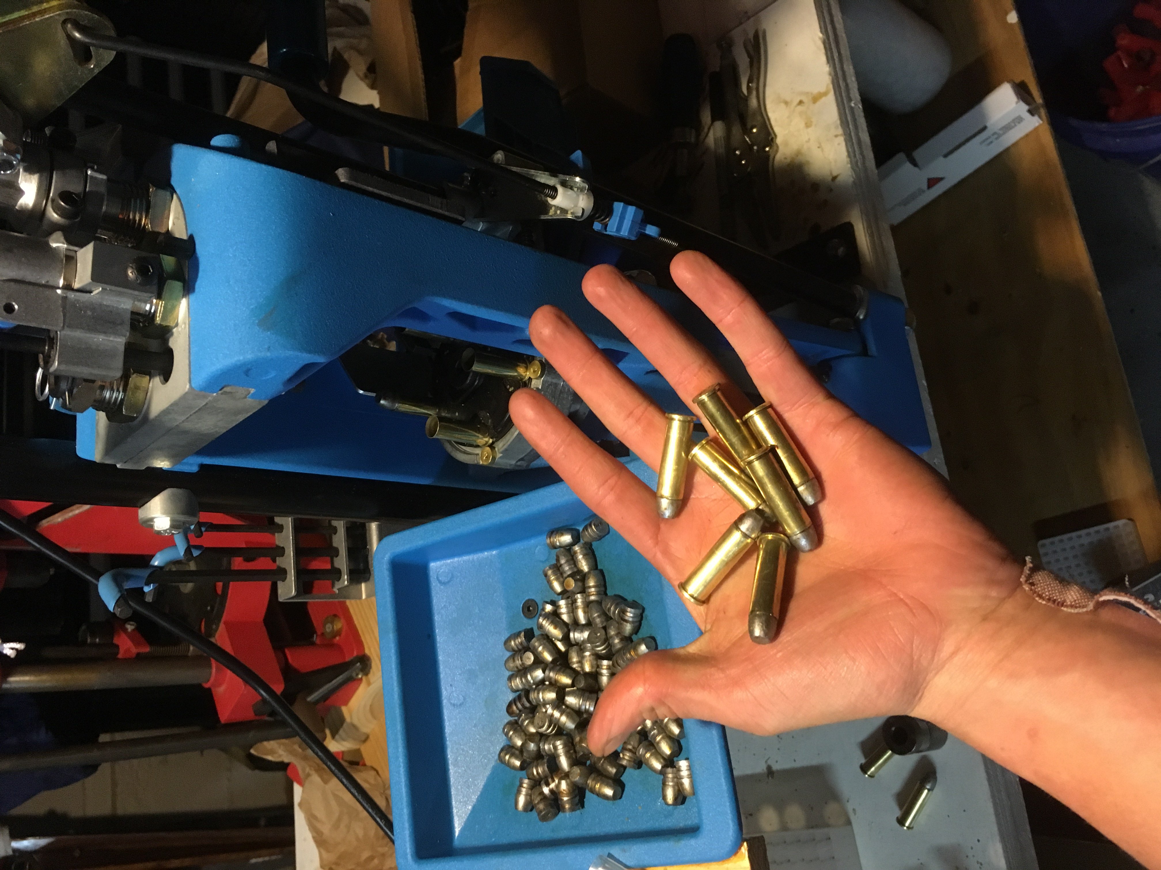

Moe T Vator Posted February 6, 2019 Posted February 6, 2019 Howdy All, Why reload? Do you save money? Do you prefer controlling your ammo, accuracy, velocity? Is it a hobby? Do do you spend an hour making 10 perfect target rounds or an hour cranking out 1000 match rounds? Regardless, here’s my cost breakdown and I want to know yours. (This does not take into account the bullet moldes, melting pots, reloaders, sizers, and Brass tumblers I’ve invested in. Only the consumable items) bullets- I cast all my own projectiles from reclaimed range lead. Cost-$0.00 Powder- clays smokeless power 8# for $150.00 $18.75/pound $0.008 a round when loading 3 grains to push a 125 grain bullet. (Rifle) And $0.007 a round when loading 2.7 grains to push a 105 grain bullet. (Pistol) Brass- reused brass. $0.00 Primers- Federal Small Pistol Primers. box of 1000 for $32.00 $0.032 per round Bullet Lube- liquid Alox $0.01 per round brass polish- Brasso $0.0025 per case lead flux- (wax and sawdust) $0.001 per round total cost: $0.0526 per round. Now, if you’ve stuck with me this long why does it matter ?? Well, the cost of a 50 round box of LRN 38 special at Walmart is $23.50 after tax in my area and local shops (if they have it) is about $25.00 Thats $0.47 per round and you run the risk of the place not even having what you need when you go shopping. SOOOO... What’s your breakdown?? What do you use and why? Eager to learn from y’all and hear your take on it. R, Moe T Vader 104114
