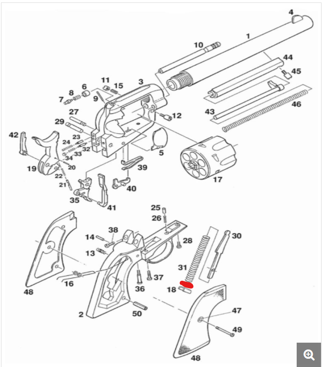

Crazy Gun Barney, SASS #2428 Posted November 16, 2021 Posted November 16, 2021 27 minutes ago, The Original Lumpy Gritz said: Put the washer at the bottom of the hammer spring. I'm no gunsmith... but I believe OLG means to put a washer here.

The Original Lumpy Gritz Posted November 16, 2021 Posted November 16, 2021 32 minutes ago, Crazy Gun Barney, SASS #2428 said: I'm no gunsmith... but I believe OLG means to put a washer here. Yes, TY! OLG
Captain Bill Burt Posted November 16, 2021 Author Posted November 16, 2021 42 minutes ago, Snakebite said: Question #2. Does it happen with the cylinder out of the gun? sb yes 1 hour ago, The Original Lumpy Gritz said: Pic post'n is above my skillz. Put the washer at the bottom of the hammer spring. Use the thicker #10 AN washers. OLG I don't have any washers laying around so I used a piece of scrap leather and created one. I installed it, and I'm seeing a lot more firing pin coming out of the frame and the gap between the hammer and the frame after I pull the trigger is a lot smaller. The difference in cocking difficulty is almost imperceptible. I'm going to put one in the other gun and we'll see how that goes. Later when I have time I'll take one down and check the pawl. and make sure there's no debris or stuff in there.

The Original Lumpy Gritz Posted November 17, 2021 Posted November 17, 2021 1 hour ago, Captain Bill Burt said: It does. I’ve never done more than take the cylinders out. The leather washers seem to have done the trick, for now. I’ll take one of them down later. Do you have a good bolt house near you? Leather won't last. Get those #10 AN washers and buy extra. IMHO, I don't trust those springs. If it was me, I'd order new ones from Wolff. Call Wolff and ask them to pull both springs from the same lot run. This way they are identical. OLG
Chief Rick Posted November 17, 2021 Posted November 17, 2021 2 hours ago, Captain Bill Burt said: I don't have any washers laying around so I used a piece of scrap leather and created one. I have quite a bit of leather in varying thicknesses in the loading room - may try that first.

Captain Bill Burt Posted November 21, 2021 Author Posted November 21, 2021 The pistols functioned flawlessly yesterday. I plan to buy a few #10 AN washers as backups and a couple of Wolf Springs kits with the different spring weights.
