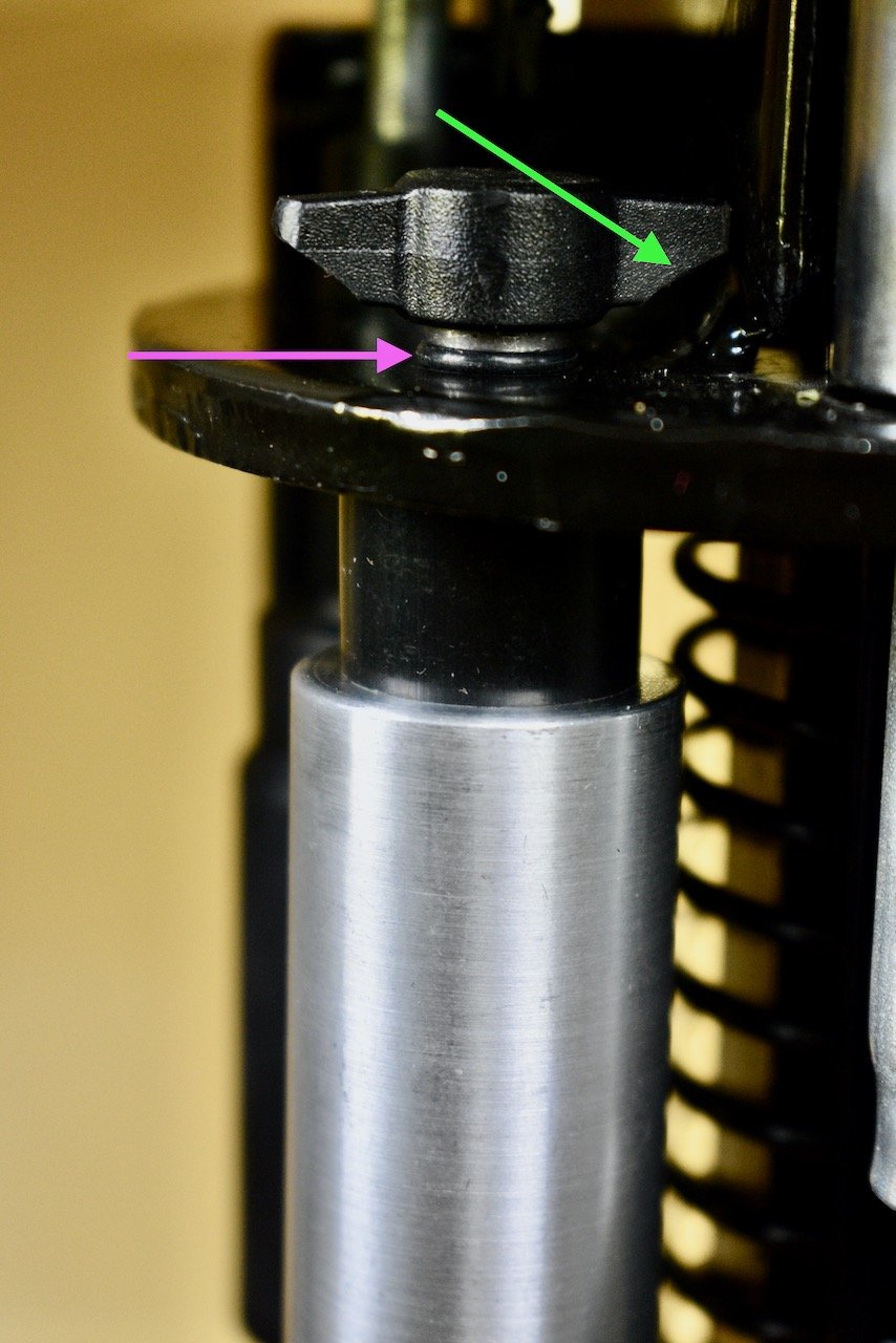

Max Payne Posted November 17, 2021 Posted November 17, 2021 Got mine today. Installed as last crimp station on my MEC 9000. I like the fact that it also resizes the body of the hull again, even though station 3 does this. I ran about 50 & chamber-checked all with my EGW 6 hole chamber checker. Perfect. I also had some reloaded AA red shotshells from the practice box that didn't pass chamber-check. Ran them through & then they passed the chamber check. I plan to use some on the warmup stage Saturday, & assuming good results, I'll use them in the match. I like the idea of the taper assisting faster loads. But, I'm hoping that the hull body reshaping will cut down on throwaway hulls some also.
Max Payne Posted November 17, 2021 Posted November 17, 2021 Just now, Max Payne said: Got mine today. Installed as last crimp station on my MEC 9000. I like the fact that it also resizes the body of the hull again, even though station 3 does this. I ran about 50 & chamber-checked all with my EGW 6 hole chamber checker. Perfect. I also had some reloaded AA red shotshells from the practice box that didn't pass chamber-check. Ran them through & then they passed the chamber check. I plan to use some on the warmup stage Saturday, & assuming good results, I'll use them in the match. I like the idea of the taper assisting faster loads. But, I'm hoping that the hull body reshaping will cut down on throwaway hulls some also. Oh, yeah! I meant to add that I used 2 of the spacer washers. I tried 4 & it was too many, & I didn't want to get it too close, so I went with 2. If you use too many, it puts a bulge in the hull.
Ranger Dan Posted November 17, 2021 Posted November 17, 2021 58 minutes ago, Max Payne said: Oh, yeah! I meant to add that I used 2 of the spacer washers. I tried 4 & it was too many, & I didn't want to get it too close, so I went with 2. If you use too many, it puts a bulge in the hull. Thanks, I measured and thought the die could be a little lower. So you used the plastic spacer and 2 washers ?
