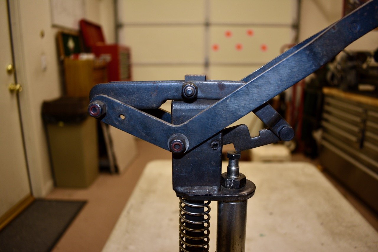

Larsen E. Pettifogger, SASS #32933 Posted November 19, 2021 Posted November 19, 2021 23 hours ago, Dogmeat Dad, SASS #48563L said: That was a very sweet find! Does that thing have a part number on it? No SCHIESSEL has been out of business for 60 years or so. I just happened to see it on EBay and bought it hoping I could use it. I measured several old presses I have in the garage and nothing was suitable. Finally bit the bullet and picked up an old Mec Case Conditioner off EBay. The original set-up used a ring sizer and required a knockout plug to get the hull out of the die. I eliminated this part of the linkage and machined down the very top part of the old setup. It had a 1/4" hole in it and already had the step machined in it that fits in the press head. The shell holder by luck fit the existing hole in the press. The nut just fit between the sides of the press bottom. Since I could not use a wrench to tighten it I made a spacer and sized it so the shell holder was in the correct position when I screwed in down from the top. I made a little gauge to set the proper clearance for the new taper die. I decided to go ahead and spend the money on a separate press as I figured I could also use the die for shells that go into a semi-auto trap gun I shoot. It is a purpose built unsingle semi-auto that loads from the top and ejects out the bottom. It is a Butler. I have attached a photo as they are scarce and not many people have seen one.
Dogmeat Dad, SASS #48563L Posted November 20, 2021 Posted November 20, 2021 6 hours ago, Larsen E. Pettifogger, SASS #32933 said: No SCHIESSEL has been out of business for 60 years or so. I just happened to see it on EBay and bought it hoping I could use it. I measured several old presses I have in the garage and nothing was suitable. Finally bit the bullet and picked up an old Mec Case Conditioner off EBay. The original set-up used a ring sizer and required a knockout plug to get the hull out of the die. I eliminated this part of the linkage and machined down the very top part of the old setup. It had a 1/4" hole in it and already had the step machined in it that fits in the press head. The shell holder by luck fit the existing hole in the press. The nut just fit between the sides of the press bottom. Since I could not use a wrench to tighten it I made a spacer and sized it so the shell holder was in the correct position when I screwed in down from the top. I made a little gauge to set the proper clearance for the new taper die. I decided to go ahead and spend the money on a separate press as I figured I could also use the die for shells that go into a semi-auto trap gun I shoot. It is a purpose built unsingle semi-auto that loads from the top and ejects out the bottom. It is a Butler. I have attached a photo as they are scarce and not many people have seen one. Thank you for the details, and the picture of the unique shotgun. It is amazing what is out there the only a few folks have ever seen. You did pretty much what I was planning to do as well, but finding the shell holder has been a bit of an issue. I would have bit the bullet (so to speak) and bought one of the RCBS ones, but no one has any in stock. I was tempted to buy one of the old CH adapters that converted a through hole screw mount to a modern clip in mount so I didn't have to machine off the base of the RCBS part and countersink the hole like Cheyenne Ranger did, but by the time I bought that, the RCBS part, the Quickloader die, I would have been into it for about $140.00 and I still wouldn't have had the press! Used to be able to pick those up for around $20.00, but with all the recent publicity they are going for around $90.00 to $100.00 when you include shipping! Add it all up and it's like $230.00 to do this and improve my times to the point that maybe I would move from the top of the bottom third to the bottom of the middle third. Doesn't mean that will stop me though! I have an older MEC Sizemaster in 20ga that doesn't get used much so I may just buy a new shell plate and convert that to a dedicated taper crimp press, at least until I start messing with the 20ga again. As a fall back plan, I also talked to my son about doing a 3D printed version of a custom shell holder. I can do the CAD drawings and he can do the printing. Yes, it would be plastic, but I can make it thicker and wider to handle the loads and I can also have it made to include a built in stop so I don't crimp it too deep. Even if it only lasts 1000 rounds, I can just print another. Not sure what direction I will end up going, but that was definitely a sweet find on eBay!
Roger Rapid Posted November 20, 2021 Posted November 20, 2021 Larsen... Nice adaptation to the MEC Case Conditioner!!!! Be good... RR
