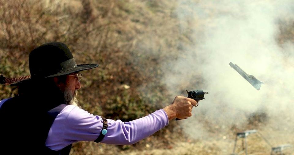

Prairie Dawg, SASS #50329 Posted August 23, 2020 Posted August 23, 2020 I've been shooting cap guns since the early 80s, but yesterday at the OVV monthly, I had this happen: The importance of the wedge........... I guess I was a bit lax about making sure the wedge was in. I should have known, as I had two failure-to-fires just before. I think the wedge got a bit loose and caused way too much headspace. The third one lit off and took the barrel with it! Lesson learned -- after that, at the unloading table, gave the wedge a tap with the nylon hammer! Course, I had to listen to "at least my barrel didn't fall off" comments for the next few stages! But, aside from a bit of embarrassment, learned a good lesson, almost shot the match clean, and had a great time! Goes to show that you're never too "seasoned" to learn something new, and make it a part of your routine! By the way, this is not a picture of me, but an image in my files. I have not been immortalized by a digital image!! So, keep yer powder dry & your wedges tight!!! Be safe & have fun! --Dawg

Mister Badly Posted August 23, 2020 Posted August 23, 2020 I am pretty sure the barrel broke the 170.
Lucky R. K. Posted August 23, 2020 Posted August 23, 2020 The person in the picture you posted was Capt. Jeb. Forrest from North Carolina. He told me the shot where the barrel came off hit the target. He picked up the wedge, mounted the barrel, and finished the stage.

Null N. Void Posted August 23, 2020 Posted August 23, 2020 1 hour ago, Lucky R. K. said: The person in the picture you posted was Capt. Jeb. Forrest from North Carolina. He told me the shot where the barrel came off hit the target. He picked up the wedge, mounted the barrel, and finished the stage. That would have been Jeb. MIss him, he was always fun to shoot with!
Rafe Conager SASS #56958 Posted August 23, 2020 Posted August 23, 2020 48 minutes ago, Cheatin Charlie said: I had one loosen up several years ago. I removed it from the frame and put red loctite on it and reinstalled. Hasn't come loose yet. Course it would depend on how loose it was. I put the barrel on the frame and installed the wedge so arbor was straight while the loctite hardened up over night. How do you remove it from the gun? I'm an ok smit but do know my limits. Rafe
Cheatin Charlie Posted August 23, 2020 Posted August 23, 2020 In the hammer channel there is a small pin that keeps the arbor from turning. Center punch it and drill it out. Then arbor can be turned out of the frame. File down pin in drill to correct size and before locktite hardens drive new pin in. After locktite hardens upset head of pin with punch and file smooth. It worked for me.

Seamus McGillicuddy Posted August 24, 2020 Posted August 24, 2020 On 8/23/2020 at 7:47 AM, Lucky R. K. said: The person in the picture you posted was Capt. Jeb. Forrest from North Carolina. He told me the shot where the barrel came off hit the target. He picked up the wedge, mounted the barrel, and finished the stage. That would make an awesome scene in a western movie. In the middle of a gunfight the hero’s gun explodes and as the sneering bad guy approaches him for the kill the hero calmly reassembles his weapon and takes out the bad guy or last few bad guys at the last second. Seamus
45 Dragoon Posted August 24, 2020 Posted August 24, 2020 Yap, I've always said "tap the wedge in, tap the wedge out". Thumb pressure is no good! Mike
Fingers McGee Posted August 24, 2020 Posted August 24, 2020 On 8/23/2020 at 7:48 AM, Prairie Dawg, SASS #50329 said: OK, now I feel better! If it can happen to "THE MASTER", it can happen to anyone!! --Dawg Just to be clear, I don't remember the barrel going down range. It fell off when I cocked for the next round. You don't have a video of it Warden ................ do you?

Prairie Dawg, SASS #50329 Posted August 25, 2020 Author Posted August 25, 2020 Oh, it wasn't a danger in any way. In Colt open top-style revolvers, every time the gun fires, the ball goes into the barrel, and tries to rip the barrel off the arbor, but the wedge stops that from happening, and the ball goes through the hole in the barrel instead. When the wedge is missing, the ball pulls the barrel off, and the ball/barrel assembly all goes downrange. No danger of explosion or anything else -- except embarrassment. One of the reasons brassies "shoot loose" with stout loads, is that every time it fires, the ball is trying to rip the barrel off the frame, tugging on the arbor. The connection between the arbor & frame in brass-framed guns is not as tight/structurally sound as in steel-framed guns. So. I want my guns to be steel-framed, and keep my loads reasonably light -- We're not shooting bad guys, after all! The wedge holds the barrel on the frame.Once we found the wedge, I just reloaded it, tapped the wedge in tighter, and finished the match. And, yes, I laid the frame/cylinder on the spool & said, "I think it's broke." --Dawg
Tequila Shooter Posted August 25, 2020 Posted August 25, 2020 8 minutes ago, Prairie Dawg, SASS #50329 said: Oh, it wasn't a danger in any way. In Colt open top-style revolvers, every time the gun fires, the ball goes into the barrel, and tries to rip the barrel off the arbor, but the wedge stops that from happening, and the ball goes through the hole in the barrel instead. When the wedge is missing, the ball pulls the barrel off, and the ball/barrel assembly all goes downrange. No danger of explosion or anything else -- except embarrassment. One of the reasons brassies "shoot loose" with stout loads, is that every time it fires, the ball is trying to rip the barrel off the frame, tugging on the arbor. The connection between the arbor & frame in brass-framed guns is not as tight/structurally sound as in steel-framed guns. So. I want my guns to be steel-framed, and keep my loads reasonably light -- We're not shooting bad guys, after all! The wedge holds the barrel on the frame.Once we found the wedge, I just reloaded it, tapped the wedge in tighter, and finished the match.And, yes, I laid the frame/cylinder on the spool & said, "I think it's broke." --Dawg Now that's funny. If I ever get lucky enough to shoot with you I'll remind you to check your wedge (just to be a wise guy)
