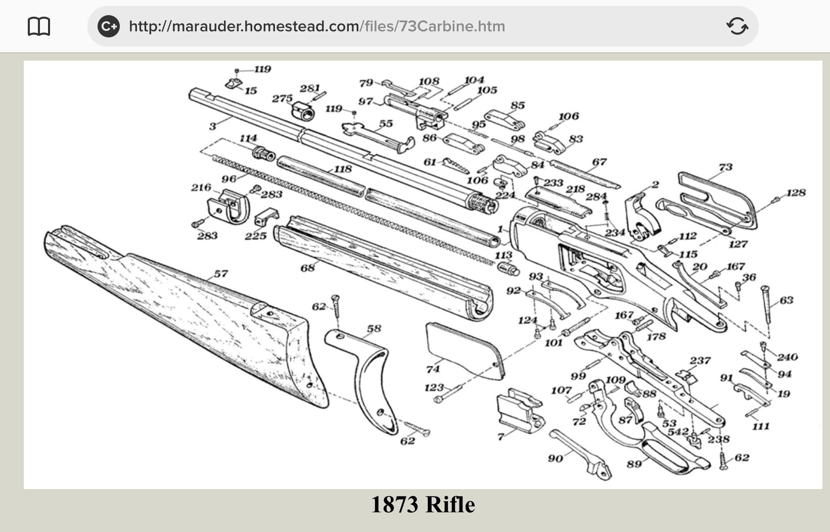

Not Dead Ed Posted March 25, 2022 Posted March 25, 2022 5 hours ago, Smokestack SASS#87384 said: How much does a cartridge stop for a ‘73 cost. They’re free, ‘cuz the 73 don’t have no cartridge stops. http://marauder.homestead.com/files/73Carbine.htm
