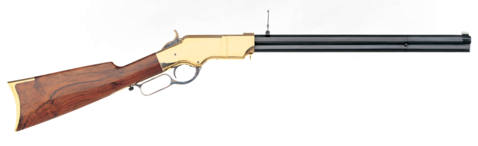

Marshall Matt Dillon Posted March 13, 2021 Author Posted March 13, 2021 3 hours ago, WOLFY said: I’m just glad to hear that gun shows are still a thing. Add my vote regarding the miroku 92 being a great lever gun. Well, we did not find any henrys or 73 rifles at all! I did buy a nib USFA. It is a 12 shot 22lr. Kinda hard to find.
Driftwood Johnson, SASS #38283 Posted March 13, 2021 Posted March 13, 2021 Howdy Why not buy a Big Boy? Ugly! There are those who think the original brass framed Big Boy looked just like a brass framed 1866 Winchester. They have not taken a close look at a brass framed 1866 Winchester. Heavy. Much too heavy for our sport. No after market parts. Did I mention Ugly? Then there is the fact that Henry Repeating Arms has never admitted they have nothing to do with the original 1860 Henry rifle patented by Benjamin Tyler Henry while he was working for Oliver Winchester at the New Haven Arms Company. To this day Henry Repeating Arms still has a page on their website with photos and text implying the history of the Henry Rifle as their own, despite the fact that they appropriated the name because it was well known and was in public domain.
Nimble Fingers SASS# 25439 Posted March 14, 2021 Posted March 14, 2021 2 hours ago, Driftwood Johnson, SASS #38283 said: Howdy Why not buy a Big Boy? Ugly! There are those who think the original brass framed Big Boy looked just like a brass framed 1866 Winchester. They have not taken a close look at a brass framed 1866 Winchester. Heavy. Much too heavy for our sport. No after market parts. Did I mention Ugly? Then there is the fact that Henry Repeating Arms has never admitted they have nothing to do with the original 1860 Henry rifle patented by Benjamin Tyler Henry while he was working for Oliver Winchester at the New Haven Arms Company. To this day Henry Repeating Arms still has a page on their website with photos and text implying the history of the Henry Rifle as their own, despite the fact that they appropriated the name because it was well known and was in public domain. Well then I guess you think the same way about licensed Winchesters made by Moriku? Beauty is in the eye of the beholder. Personally I don’t like the looks of a Marlin, but when I started in the late 90’s, Marlins in .38 special were the rifles only serious Cowboy action shooters used! Stop being a gun snob! No one is forcing you to use one and if you would really look down your nose at someone who came to your monthly shoot with a Big Boy, the I am wondering what you think the “spirit of the game” is? I would be happy to have a new shooter and welcome him/her to the match! But that’s just me having fun shooting and not caring what my score is!
Not Dead Ed Posted March 14, 2021 Posted March 14, 2021 2 hours ago, Driftwood Johnson, SASS #38283 said: Howdy Why not buy a Big Boy? Ugly! There are those who think the original brass framed Big Boy looked just like a brass framed 1866 Winchester. They have not taken a close look at a brass framed 1866 Winchester. Heavy. Much too heavy for our sport. No after market parts. Did I mention Ugly? Then there is the fact that Henry Repeating Arms has never admitted they have nothing to do with the original 1860 Henry rifle patented by Benjamin Tyler Henry while he was working for Oliver Winchester at the New Haven Arms Company. To this day Henry Repeating Arms still has a page on their website with photos and text implying the history of the Henry Rifle as their own, despite the fact that they appropriated the name because it was well known and was in public domain. One, yes there are aftermarket parts, see my post above somewhere. The guts are a Marlin 94, so you can drop PaloVerde spring kit in it. Can’t short stroke it. Second it ain’t heavier than the 1873 octagonal barrel. They weigh about the same... Last as far as beauty, I fall into the If it goes “BANG!” I like it! category... just remember it’s not a racing gun. It more of a Chevy than a Ferrari..

WOLFY Posted March 16, 2021 Posted March 16, 2021 If they made ‘em in .44 spl / russian, i’d run a Henry
Nimble Fingers SASS# 25439 Posted March 16, 2021 Posted March 16, 2021 1 hour ago, WOLFY said: If they made ‘em in .44 spl / russian, i’d run a Henry The only company that did make an 1860 Henry in .44 special is Uberti I believe. Someone even suggested going to VTI to see if they had any barrels left. They had them listed but none in stock. You might get Henry Rifles to do a custom rifle for you, the would only need to work the barrel.
Nickel City Dude Posted March 17, 2021 Posted March 17, 2021 You can get a replacement carrier block that will work with 44 Russian. I have one in my 66 that I shoot blanks out of made from 44 Mag. brass. It is also very easy to convert the existing carrier block in an 1860 Henry to shoot the shorter 44 Russian cartridge. If you send me a PM I will explain how it is done.
WOLFY Posted March 17, 2021 Posted March 17, 2021 I’ve a couple Ubertis one 66 in .44 spl and a 73 that runs .44 russian. Yeah, I’m not gonna ask “Henry R A” for anything.
Abilene, SASS # 27489 Posted March 17, 2021 Posted March 17, 2021 14 minutes ago, Nickel City Dude said: You can get a replacement carrier block that will work with 44 Russian. I have one in my 66 that I shoot blanks out of made from 44 Mag. brass. It is also very easy to convert the existing carrier block in an 1860 Henry to shoot the shorter 44 Russian cartridge. If you send me a PM I will explain how it is done. I believe that in the case of the Henry, you will then be firing a Russian cartridge in a 44-40 chamber. Not a proper fit, but I know some folks do it with no problems.
WOLFY Posted March 17, 2021 Posted March 17, 2021 2 minutes ago, Abilene, SASS # 27489 said: I believe that in the case of the Henry, you will then be firing a Russian cartridge in a 44-40 chamber. Not a proper fit, but I know some folks do it with no problems. Someone said the modern .44-40 rifle bore is good to go, my issue would be finding a gunsmith who could sleeve the chamber.
Nickel City Dude Posted March 17, 2021 Posted March 17, 2021 3 hours ago, WOLFY said: If they made ‘em in .44 spl / russian, i’d run a Henry
