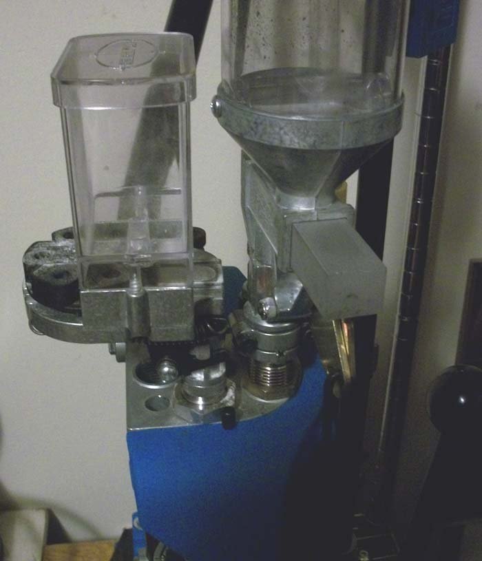

CR I forgot to tell you that for the blanks I make for the 357 revolver I start with 38 short Colt brass I get from Starline. I used to just cut down 38 Spl. brass but the short Colt are more uniform, and I can make them on my 650 Dillon so I can make a bunch in a short period of time. I make them short because all commercial blank guns use 380 or 9mm blanks and these will fit in them also. The biggest hurtle with blanks for a revolver is to get them not to chain fire and to not have anything solid flying out of the barrel but at the same time not allowing the black powder to leak from the cartridge. Here is a picture of the way my 650 set up for 357 blanks with two powder throws. One for the black powder and the other for COW. If you would like more details about how to make blanks just send me a pm with your email or phone #. I would be happy to share my successes and failures with you. -

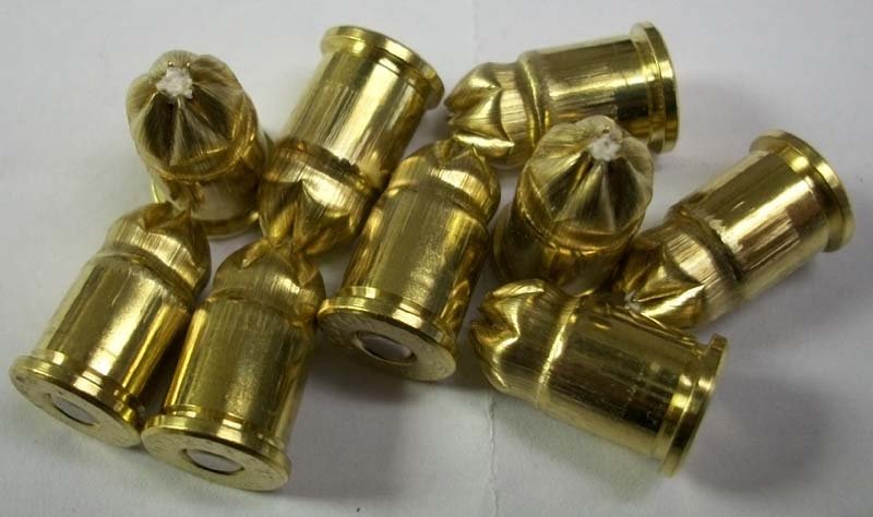

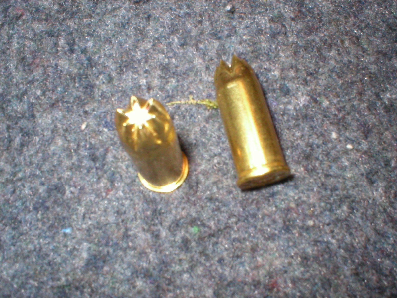

I have been making blanks for 44-40 for about 30 years. I used to reenact the Civil War and used an 1860 Henry. I found that using 44 Mag brass worked better than the 44-40. In a rifle the primer backing out is not usually an issue, but you definitely need to drill out the primer hole to keep that rascally little primer in check. I also use a 1/8 drill to open the hole. I star crimped the end of the cartridge so it would feed better in a lever gun. With a revolver it is not as critical. About 20 grains of black powder is what I used. Makes a good bang and enough smoke to look good. I have also made 38 cal. blanks with black powder, but I only use about 12 grains in them so I can use 10 grains of Cream of Wheat to protect the blanks from chain firing. It is hard to tell the difference in sound and smoke between the 44 Mag. blanks and the 38. If this works, I will post some pictures. -
