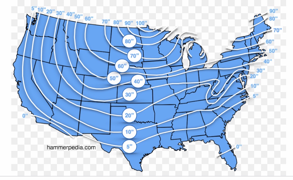

Chili Ron Posted February 20, 2021 Posted February 20, 2021 Howdy, Maybe contact a nearby town and ask what depth they have water mains. Go a little deeper than that. That map seems like a good guide. 100 inches...wow. A good heavy layer of fallen leaves could help too. Best CR

Utah Bob #35998 Posted February 20, 2021 Posted February 20, 2021 5 hours ago, J-BAR #18287 said: Google “frost line map”: But don’t go by it necessarily. It says 20-30” for my area. Local code says 36”.

watab kid Posted February 21, 2021 Posted February 21, 2021 interestingly enough that frost table fails to take into consideration soil makeup - im in 42" area , just north of me is 60" [that map has to be the extremes] but a bit farther north of me the sand hold no moisture and you can lay footings about a foot down , id keep my pipes well insulated and deep tho
Marshal Mo Hare, SASS #45984 Posted February 21, 2021 Posted February 21, 2021 For a map whose scale is less than one inch per thousand miles, you can’t ask for a great degree of accuracy.
