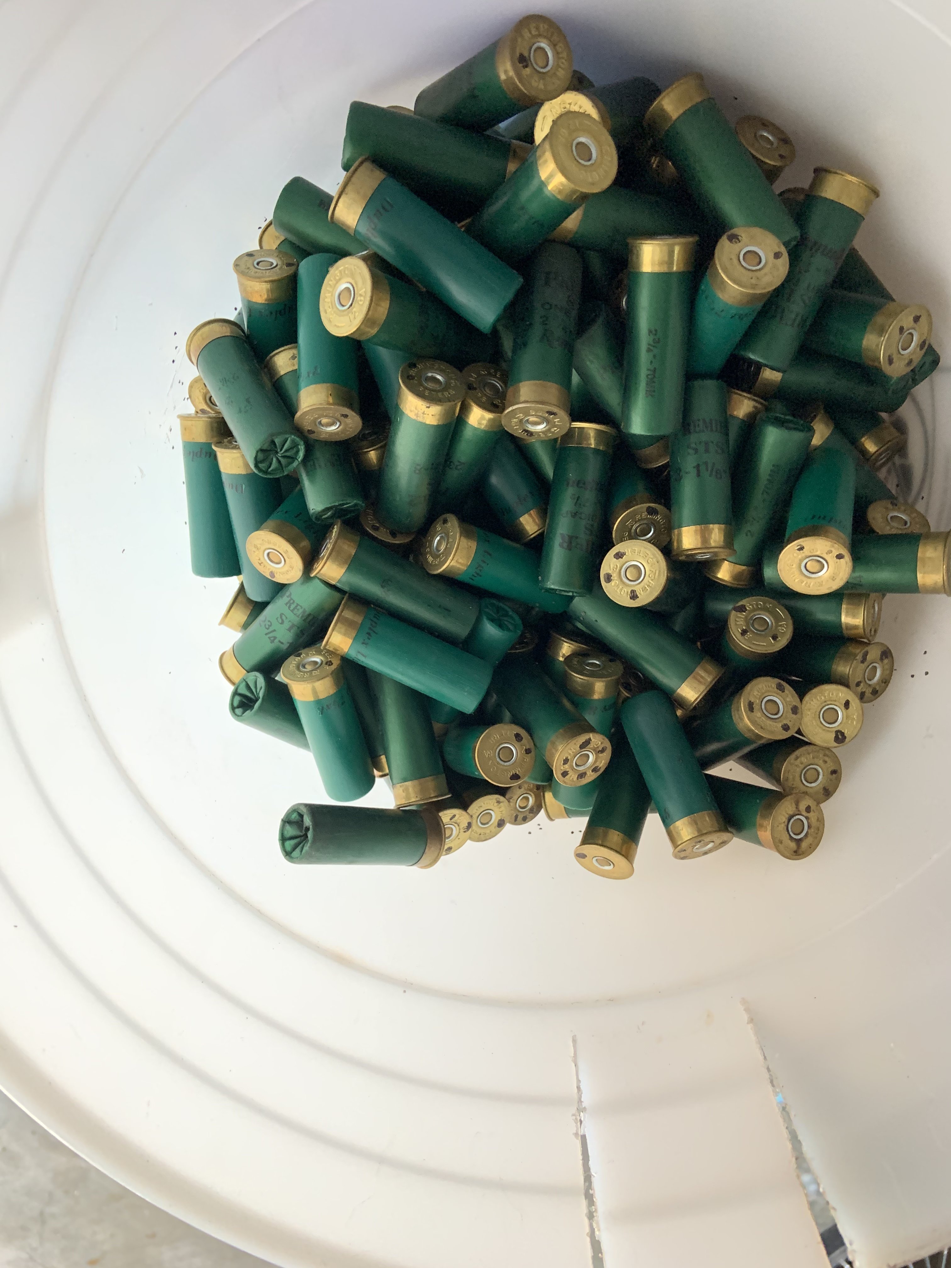

Loaded up about 400 12G this afternoon.  These ought to hold me for a few months!
If I calculated correctly about 4.50/box, about 1/2 price of factory. Not a huge savings, but I can’t always find 7/8 oz loads, and I find STS hulls shuck better, so worth the time.
I started marking my hulls a long time ago. I can get on average 8 or so loadings per hull. Got 12 out of this one!

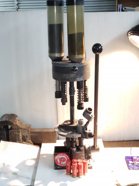

I resurrected/rebuilt this ~40 year old, single stage, Ponsness Warren 375 Duomatic in 12 and 20 gauge I bought off ebay for $175.  Put another $100 in it for taper crimp dies.  It puts out a phenomenal shell that drops right in a shell checker everytime.  Win AA stay crimped, don't start opening up, months after loading.
