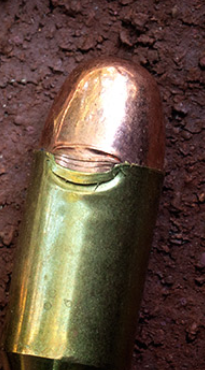

Garrison Joe, SASS #60708 Posted May 26, 2020 Posted May 26, 2020 The lead "fingernails" and crushed case mouths is because you were not belling (expanding) the mouth of the case enough in the expander die. Then the bottom edge of some bullets catch the mouth as you try to seat the bullet, and the weak brass case collapses or shaves lead off the slug. A poly-coated bullet can suffer the same damage if you don't bell enough. So, solution is to bell the case enough that the base of the bullet can be set by hand into the case for the first 0.010" of travel. Enough insertion of the bullet into the case has to be possible so that the bullet does not fall off as the progressive loader rotates the case under the seater die. You should easily be able to feel the amount of expansion that makes bullet seating 100% successful. You will just see it visually. A set of vernier or electronic calipers is a big help on this (and on other loading tasks). Measure the case outside diameter after resizing it. Add about 0.005" ( five thousandths of an inch) as your first target for the bell, measured right at the case mouth. Then, the crimping action of the combo seater/crimper or the separate crimp die will roll crimp at the same time as removing the bell of the case. And the roll crimp tightly holds the bullet in the case under recoil and magazine spring pressure. Load one of two types of bullet designs for lever rifles. Either a Round Nose Flat Point (RNFP abbreviated), or a Truncated Cone (TC) bullet. Both have the flat point needed for safety in the magazine tube, and are streamlined to avoid catching the nose on the rear of the chamber. The example photo of a lead SemiWadcutter bullet that you posted - turns out to NOT work well in many lever rifles because of the ledge below the nose. If you already have made loads with SWC bullets - save them to shoot through revolvers. Shooting one bullet weight in your rifles and revolvers simplifies things a lot! For .38 Special loads, I'd suggest, to start with, loading a 125 grain bullet at about 650 FPS revolver velocity (rifle will add maybe 150 fps to that cartridge MV). Either lead bullets or polymer coated bullets are legal. But not copper plated Berry bullets. Find a cartridge OverAll (OAL) Length that works in your rifle(s). And that will work in the revolvers too. Then ALL your ammo is made of the same components and loaded with the same recipe. Really simplifies your loading! Good luck, GJ
