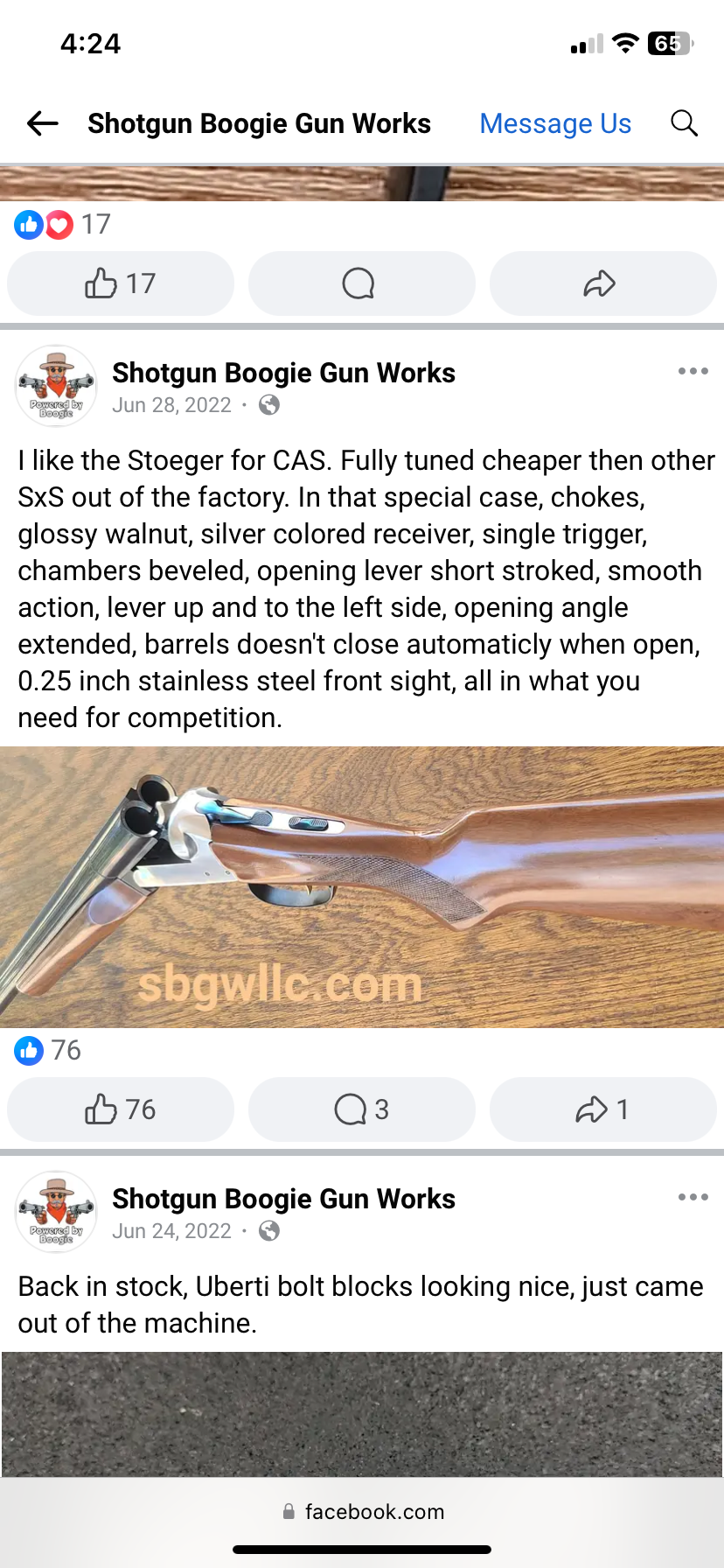

Stump Water Posted June 21, 2024 Posted June 21, 2024 28 minutes ago, Michigan Slim said: Get a slicked up Stoeger and start playing. No need to break the bank right away.

Rafe Conager SASS #56958 Posted June 21, 2024 Posted June 21, 2024 Stogger or bakal when slicked up a bit works just fine. I normally shoot my stoger single trigger that was slicked up by Johnny meadows and have used it at bordertown, winterange and eot. I also have a taylors single trigger that was more expensive also slicked by Johnny. Sure skband browning are top shelf but never going to make you a world champ. Practice loading and transitions. Rafe
Eyesa Horg Posted June 21, 2024 Posted June 21, 2024 Been using my Stoeger for 13 years without issue. I reversed the double triggers and your finger just slides back to the rear trigger.
