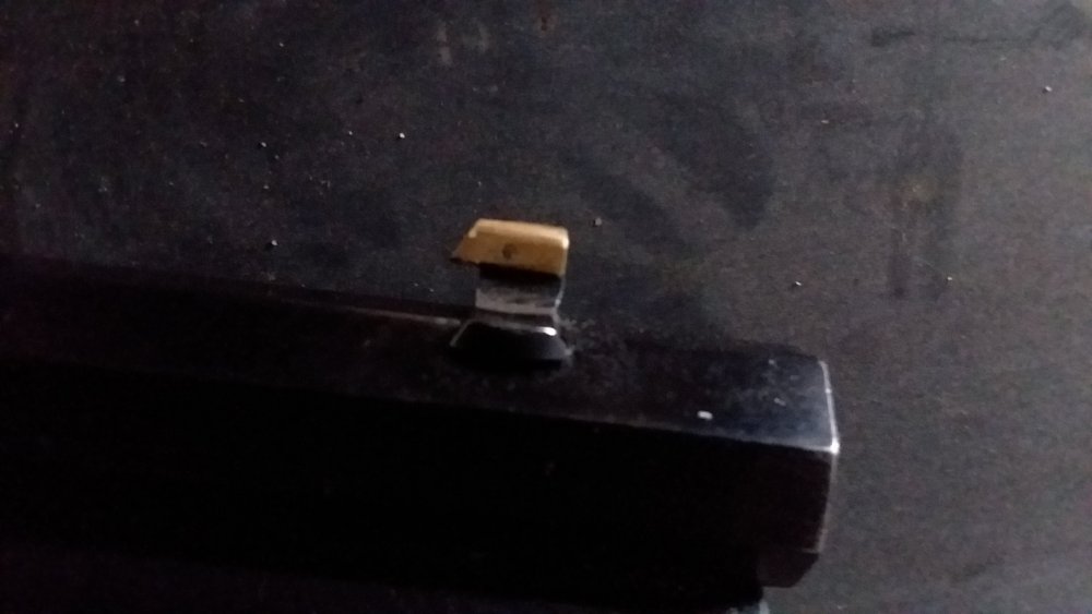

I recently purchased an older Uberti 1873 SRC and it has a blade front sight. I would like to replace it with a brass one, can't seem to find one. Other option is just remove it and replace the front barrel band with one that has a bead sight (longhunter has those). So anyone know where to find the brass sight to fit this or should I just buy a piece of brass and shape it to fit? Or remove it and replace with a barrel band with sight? Thoughts ???

Buy some brass sheet stock and make one.

I've looked at those, just don't think they will fit or stay on. Unlike a marbles sight this is a flat blade, only about .6 inches thick. Think I will go with Lumpy and just make one.
Thanks

 Me thinks you need a 0 in there somewhere. I don't think that sight is over half an inch thick!
You are correct, .06 inch.

Hardware or hobby stores usually have both sheet and wire/round rod in various sizes.  If not, it can be ordered from RioGrande. Com.
If you put 3/16" round brass rod  in a vise and hacksaw carefully 3/4 through it lengthwise, it can usually be easily conformed over top a blade sight.  It can be glued in place with various products, but make sure they are heat tolerant.  I drilled and pinned mine to be sure it would stay in place.  After it is in place, you can file it to desired size and shape.
Most keys are brass, have made many sight blades by filing down a key to fit.

All you have to do is go to a good hardware store and buy a piece of brass stock .060 or so thick.  Might need to buy a hand jigsaw to cut the shape and fille to your taste,  Then file the side to match the thickness of the original.  Drill a hole the same diameter as the pin.  A little work, but you just need patience.  At an alternative, you could use a nickel or a dime!

Take a 22 fired casing cut a piece out of it solder it on.
Take brasso shine it up.
Be careful soldering on a blued finish rifle.  Be ready to patch the bluing afterwards. Soldering Flux is tough on bluing.
