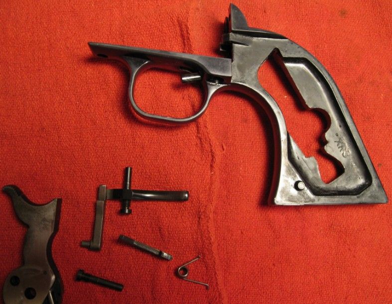

Driftwood Johnson, SASS #38283 Posted March 30, 2019 Posted March 30, 2019 5 hours ago, Nate Kiowa Jones #6765 said: The Ruger lock works were designed in the 1950-60's. It is nothing like the colt style lock basically unchanged since 1836. Howdy I am going to disagree only slightly with the learned Kate Kiowa Jones. When Ruger single action revolvers first came out in the 1950s they were very similar to Colts. The lockwork was almost the same. Not quite but almost. However Rugers have always featured coil springs instead of leaf springs. In the mid 1970s Ruger completely redsigned their entire line of single action revolvers. At this time, the transfer bar was added, completing making the internal parts of Ruger very different than the internals of a Colt. Picture is worth a thousand words department: I don't have any photos of an Uberti broken down, but for our purposes they are almost exactly the same as a Colt. This is what a Colt looks like, all torn down. The sharp eyed will notice I have substituted the leaf type bolt/trigger spring with an after market wire spring. This is the guts of a Colt. Just four parts. Clockwise they are hammer, hand, bolt and trigger. Yes that is the hand leaf spring and they can break. Usually they break right at the sharp curve where it is pressed into the hand. Notice how thin the upper tip of the trigger is. That is called the sear, and it fits into the various notches on the hammer to put the hammer at 'safety cock', half cock, and full cock. The main problem with this design is how thin the sear is. Put the hammer in the 'safety' position, with a live round under the hammer, and give the hammer a forceful enough blow, the sear will break off, or the hammer notch may break, and the gun may fire. Drop a loaded gun on the hammer with a live round under the hammer and this is almost guaranteed to happen. That is why a Colt or other revolver with a Colt style action is only carried loaded with five rounds and an empty chamber (not cylinder, automobile engines have cylinders, revolver cylinders have chambers) under the hammer. This is a Ruger New Vaquero all torn down. Notice there are no leaf springs, they are all coil springs. Notice too that two of the coil springs require a plunger to direct the spring pressure exactly where it is needed, increasing the part count slightly. A little closer view: The part attached to the trigger is the transfer bar. When the hammer is cocked, the trigger rotates back, pushing the transfer bar up to position it between the hammer and the frame mounted firing pin. The gun cannot fire unless the transfer bar is in this position. When the trigger is released, the transfer bar retracts and a blow to the hammer will not fire the gun. The thing about coil springs vs leaf springs is that to achieve the same amount of total motion, each coil of a coil spring bends very little. So they almost never break. A leaf spring on the other hand is more prone to breaking because the flex is more extreme at the point it flexes. Case in point: at the top, a broken Colt trigger/bolt spring. Absolutely typical of the way they usually break, right at the end of one of the legs. At the bottom is a broken bolt. The legs of the bolt are spring steel and have to flex every time the hammer falls. This one flexed a few times too many. By the way, the broken bolt is fairly rare, knock on wood. Let me be clear here. Leaf springs are not guaranteed to break the first time, or even the thousandth time they are flexed. But they are more prone to breakage than a coil spring. That is why Ruger went to coil springs way back in the 1950s. Yes, the Colt these parts came from was put out of action when these parts broke. No, they did not both break the same day, but I saved the broken parts for this photo. Yes, I completed the match with my back up Rugers, which still accompany me to every match. No, I have never seen the leaf hammer spring of a Colt or clone break. I suppose it could happen, I just have not encountered it. Yes, most of the clone makers are substituting a coil spring these days for that pesky leaf hand spring, so that helps with the longevity of the gun. I once spent the entire lunch period installing a new handspring for a pard to keep his Uberti rolling through the rest of the match. "Built as a tough as a tank" The reason for this is Ruger parts have a thicker cross section that Colt (or clone) parts. Thicker means stronger. It is that simple. PS, regarding simpler to load, I find it very simple to load a Colt. Load one, skip one, load four more, cock the hammer and carefully lower it on an empty chamber. Practice it a few hundred times and it becomes second nature. Of course while lowering the hammer the gun should be pointed in a safe direction. To be consistent, my Rugers have half cock hammers in them, and I load them the same way. One more thing: Uberti has recently abandoned the old fixed firing pin in the hammer and gone over to a retractable firing pin in the hammer. When the trigger is pulled, a lever on the trigger pushes an actuator in the hammer up to push the firing pin forward so it can strike a primer. Otherwise, the firing pin will not reach a primer. This system is brand new, only been on the market about a year now. The old stocks of 'four click' Ubertis are almost all gone now and most dealers only have the new 'three click' version. (The Safety Cock, hammer position has been done away with. I know some shooters who are all riles up about this, but I keep saying you can't count the clicks when you are yanking the hammer back to fire.
Warden Callaway Posted March 30, 2019 Posted March 30, 2019 Driftwood, great post. Do you have an old 3 screw Ruger breakdown? I was haunting gunshops from mid 1960s on. Ruger Blackhawk were there beside Colt SAA and New Frontier. Colt always cost 2 or more times that of a Ruger. They looked cheap compaired to the Colt with their cast parts and flat finish.

Driftwood Johnson, SASS #38283 Posted March 30, 2019 Posted March 30, 2019 Howdy Warden This 44 Mag Flattop Three Screw Blackhawk was made in 1958. The hammer spring was very similar to a modern one, with a coil spring around a strut. Yup, I have a pin in there to keep the spring from flying, just like with a modern Ruger. You can see the spring plunger here that sat behind the trigger to push it forward. The hammer used the same type of spring plunger that Ruger uses today to trip the bolt. Three notches on the hammer, just like a Colt. Bolt is a simple stamped part, unlike the complicated springy bolt of a Colt. Part of the reason a Ruger was cheaper to make than a Colt. A stamped part is so much less expensive to make than the spring bolt of a Colt. The coil spring is what pops the bolt up. The other pioneering development by Ruger was his use of Investment Cast parts. If you look carefully you can see the grainy finish on the hand. Designed to pop out of the mold to finished dimensions, no expensive hand fitting needed. Ruger still uses Investment Cast parts today for the same reason. Look ma, no transfer bar. The hammer strikes the frame mounted firing pin directly. And of course, the screw heads on a Three Screw Ruger were on the opposite side of the frame than on a Colt. I dunno why Ruger did that, there is no engineering reason for it. Maybe just to be ornery.
