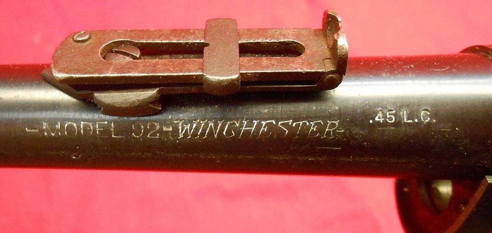

  1. Did you do this conversion? The reason I ask is a 45acp at .470" won't fit into a 357mag tube at .445". Too big for the 357m bolt face, too. Here is one I replaced the ejector in. It was converted down in Brazil for a rubber plantation police force so they could use the same ammo they were using in the systemas and balistor moline 45s. They used 44-40s and 38-40's then the mag tubes were set back protruding into the receiver. The left side guide was shortened for the cart stop as was the carrier shortened. The right side not modified. Probably the most unique thing was the caliber marking 45LC. In the early 1900's that was their name for 45 ACP. It was called 45 Latin Cartridge. These guns didn't work that well. Particularly at speed. They tend to throw out live rounds with emptied. This was mainly because the 45acp had no rim that would ride in the angled rim slots. Slow and deliberate they sorta work.

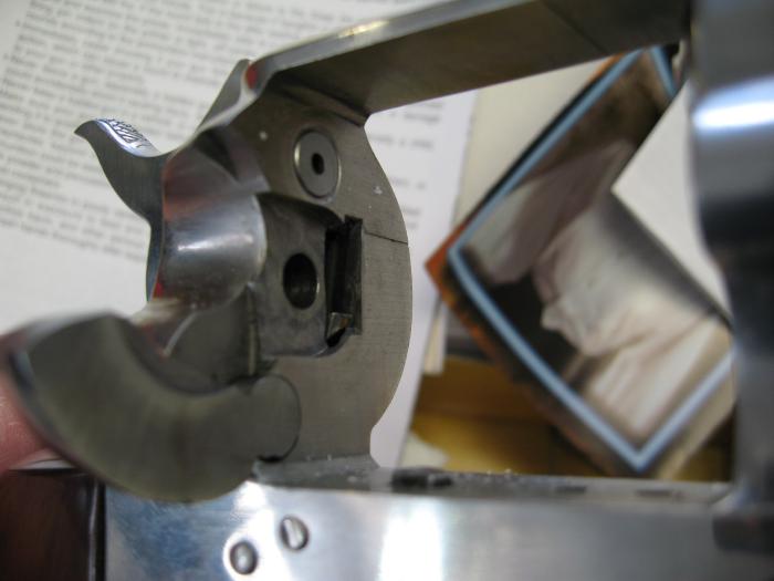

  4. Never dry fire a colt style SAA action without quality snap caps. The firing pins are designed to float to help align them with the hole in the frame. If the FP doesn't have a primer to hit it slams forward and eventually bends/loosens the retaining pin. Plus, the Pietta has a recoil shield mounted firing pin bushing that can be loosened and lost.
  5. Seems no one mentioned primers backing out. Tell us about your ammo. This comes up occasionally when hand loading for CAs. Some ammo is down loaded to a point where it won't re-set the primer. How it works. When fired the primers always back out but as the bullet exits the brass is slammed back over the primer re-seating it. If it is so weak the primer may not re-seat and will lock the gun up. To check this next time it happens use a rod down the bore into the brass and give it a tap to re-set the primer. If that isn't the problem the timing is a bit off. The top of the pawl may need to be lowered just slightly to give the bolt time to release the cylinder.

  14. I would add a hardened firing pin bushing like the Colt and Pietta GWII SAA has. I just had to do that to a pair of ASM SAA's. They too had recessed enough to bind the cylinder because the primer wasn't re-seating. I haven't checked in awhile but I bought several bushing from Dixie years ago
