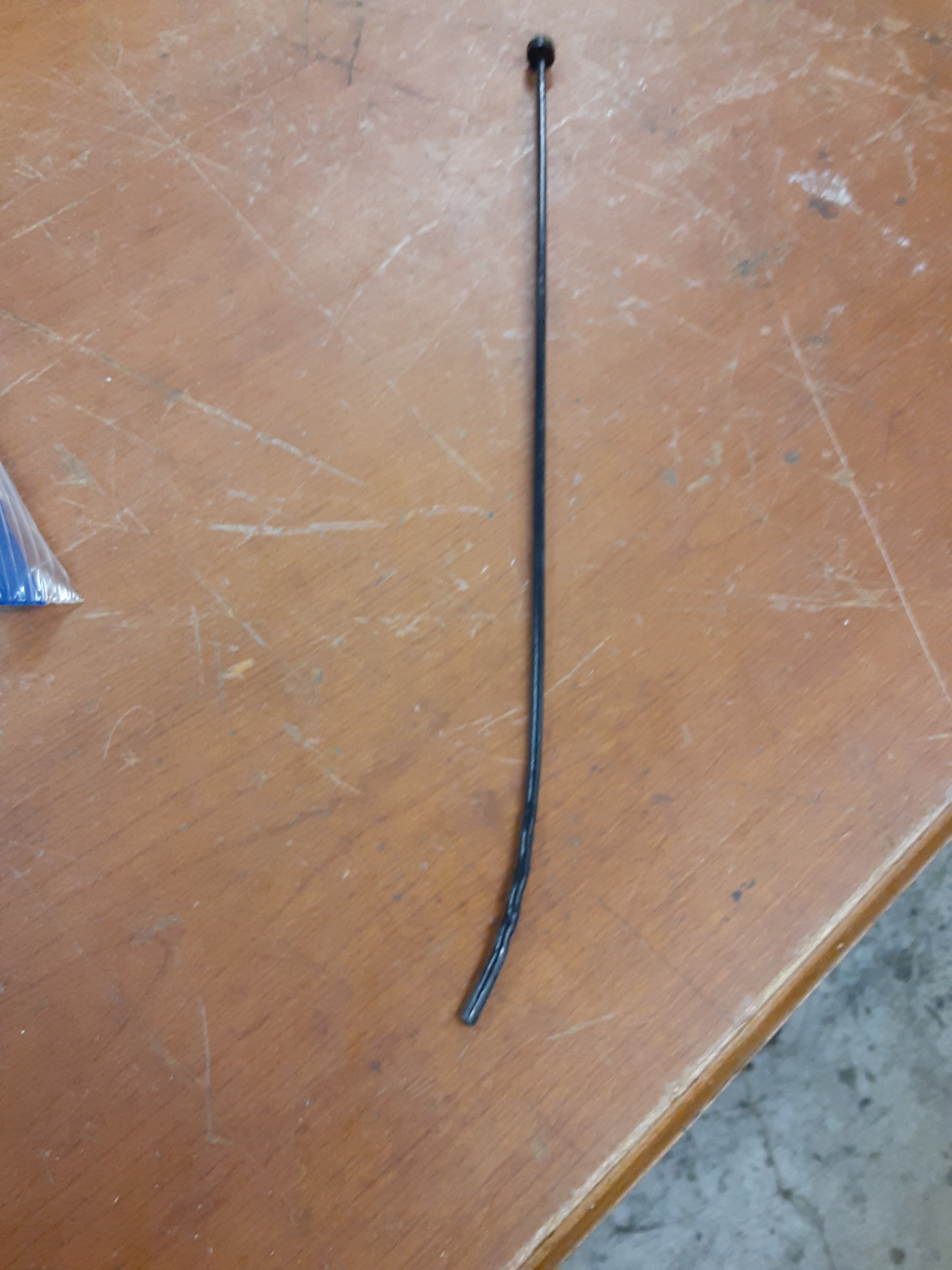

Ever have a primer (federal) go off in your Dillon (650)? Took 10min to find this guy......(ALWAYS WEAR YOUR SAFTY GLASSES!)

Oh, yeah.  One of the few weak parts of the design of the Dillon 650 machine, IMHO.  Had 2 explosions in the one I used to run.   The primers rotate a long way in the primer feed rotor, and dirt or other debris under the rotor can work to flip a primer up on edge where that one detonates, and often transmits the ripple around the rotor to the stack in the feed tube, and that all goes up too.
Keep machine VERY clean, blow out primer feed areas with compressed air, wear safety glasses, and feel blessed you did not get hurt and that you have the Dillon parts order number to get any parts replaced quickly and for free.

 Had about 40 primers go off. It was one large boom. Had to get a new parts including the shell plate.

As the Dillon tech told me after I called about replacement parts for my 650 after a primer explosion, “If you feel tension or resistance on the up stroke, STOP”. The primer feed rotates on the up stroke and there should be no resistance. But if there is, DON’T FORCE IT, or else boom.
