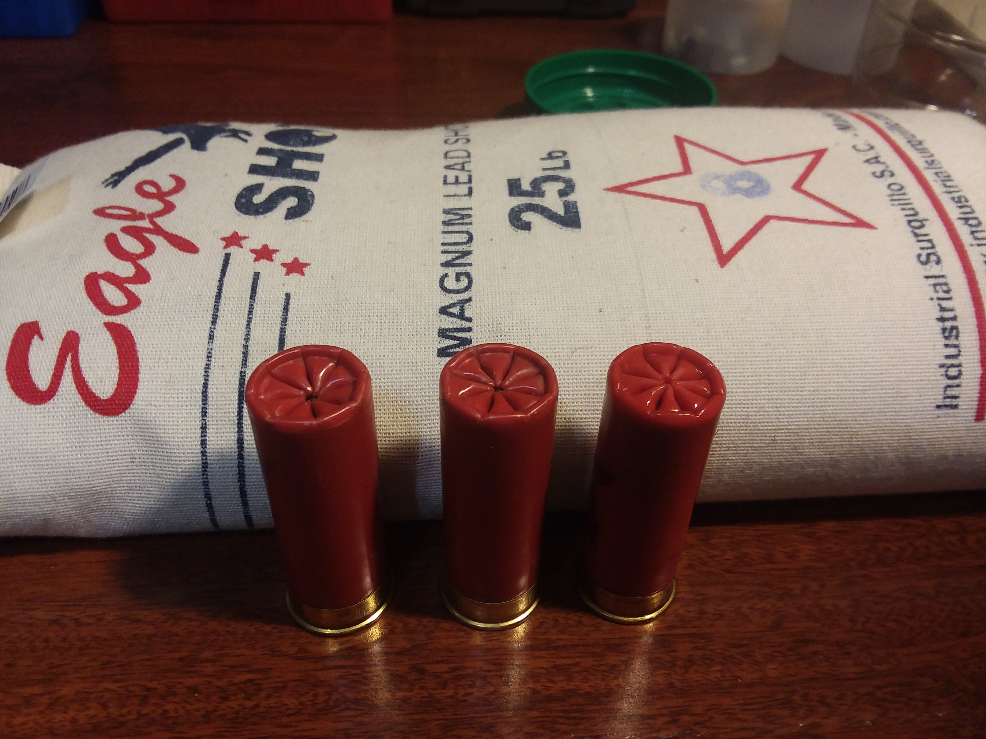

Ozark Okie Posted February 27, 2020 Posted February 27, 2020 I recently received a MEC 600 Jr (old...pre-82) from another club member; gave me the incentive to reload some shotgun shells. Cleaned up the press and studied up on light loads; settled on Clay 13.5-14 gr powder, claybuster CB0178-12 wad (optimum 7/8 oz), and 7/8 oz shot - shimmed the powder bar to drop approx 7/8 oz, ordered MEC #25 bushing and started to load with Win AA hulls (once fired by me). All is good, EXCEPT...the combination of powder, wad and shot does not give me enough column height to get a good tight crimp. If I crimp as the shot drops, the crimp is concave; if I trickle in another 1/16th inch of shot from a scoop, get a good even, tight crimp...but defeats my aim for 7/8 oz. These loads were with #9 shot....left over from my skeet days. Begs the questions - - is there something about the press (not any adjustments that I'm aware of) or my technique that I can change to get the result I need? - Is there a significant difference in the volume of same weight of #9, #8, #7 1/12 shot? .....I plan to use either #8 or 7 1/2 - do I need a taller wad to give me the necessary height? .....seems unlikely since so many folks like and use the load I chose. - do I need to add an over powder card/wad...or over shot? ....again, haven't seen any mention of this - other? Will appreciate any feedback, suggestions. Thanks OO
Duffield, SASS #23454 Posted February 27, 2020 Posted February 27, 2020 The crimp is adjustable. Go to the MEC website for the manual. Check your wad pressure, too much will slightly collapse the wad and cause your problem. Yes, #9 shot is slightly less volume than an equal weight of #8. I don't know if it is enough to cause your problem. Duffield
Tequila Shooter Posted February 27, 2020 Posted February 27, 2020 + 1 on adjusting pre-crimp and crimp. I'll also add with loading that small shot before you crimp add a small piece of paper towel or such this will keep those small balls from coming out.
Slow Mo Dern Posted February 27, 2020 Posted February 27, 2020 Hi Ozark, Do you have the right charge bar installed? I use 7/8 oz. of #8 shot but my charge bar is marked with the number 78 on it. The charge bar for 1 oz. is marked with a number 100 and the charge bar for 1 1/8 is marked with the number 118. When I changed from 1 oz. to 7/8 oz., I changed the charge bar. I found Mec charge bars in my local gun store. I hope this will help. Mo
Garrison Joe, SASS #60708 Posted February 27, 2020 Posted February 27, 2020 A sunken crimp does normally mean your powder/wad/shot column is slightly shorter than what your press is CURRENTLY adjusted to process. Several things will fix that. You can increase the powder weight just a little. The cowboy load you mentioned is a VERY low pressure load. You have room to add powder without creating excessive pressure. I had better luck up around 14.5 grains of Clays when loading that very hull and wad and 7/8 ounce of shot. You can lower the crimp starter just a little, especially if you have a little bit of a hole in the middle of the crimp after crimp is formed. You can lower the BODY of the crimp die a little, and back off (raise) the crimp plunger (stem) inside the body of the crimp die about the same amount. As mentioned above, the MEC manual (which you can download from MEC web site) has rough instructions for those adjustments. You can drop one or two Cheerio donuts (yes, from a cereal box) into the wad before you drop shot. This adds nothing to the payload weight but takes up a little volume, thus filling your shot column. This is an easy adjustment to try first. Good luck, GJ
Yusta B. Posted February 27, 2020 Posted February 27, 2020 I've loaded this combo for at least 10 years: All your components are a-OK. 1) drop your starter crimp die about 1 to 2 full turns. Start with 1 2) little to no wad pressure. See how it turns out. Would like to see a pic of your crimps.
J-BAR #18287 Posted February 28, 2020 Posted February 28, 2020 I think you are seating the wad/shotcup too deeply in the hull. The height of the drop tube at station 3, which is the thingy that pushes the wad down into the hull, is adjustable. Raise it until the shot level is a hair below the crimp fold. If the crimp folds/points meet without a gap then the pre- crimp and crimp dies do not need adjustment. link to owner’s manual, adjustment is shown on page 9: https://www.mecoutdoors.com/Content/documents/600JrMark5.pdf

Ozark Okie Posted February 29, 2020 Author Posted February 29, 2020 Good morning, folks. Thank you for all the interest and feedback. You got me on the right track, which I should have been able to do myself with a little more digging, but then I would have missed out on all the suggestions and additional information.....so thanks again. The adjustments I made are 1) reduced the wad seating depth and 2) backed off a little on the final crimp. I'm attaching a picture of three shells...left to right - my first load with the concave crimp, second is my best effort yet after adjustments and third is an unfired factory AA for reference. I can live with what I've come up with so far and think I can still improve it a little. I would like to have the rounded slightly tapered finish that some later presses give with the 3rd crimping stage, but the 600 jr doesn't have that feature. The only thing I wonder a little about is the fact that there is now a small gap between the powder and bottom of the wad (due to seating the wad less deep)...assume it will have little or no affect on shooting. I'm shooting today, so I'll find out. BTW....regarding "shimming" the powder bar, its just a plastic sleeve to take up space and allow less shot into the opening - its a 118 bar and with the sleeve its dropping very near 7/8 oz. fyi...the picture also shows a bag of #8 shot I bought yesterday.....local Sportsmans Warehouse, Slidell, La...$39.99. As before any comments, suggestions appreciated. Thank you. OO

J-BAR #18287 Posted February 29, 2020 Posted February 29, 2020 1 hour ago, Ozark Okie said: The only thing I wonder a little about is the fact that there is now a small gap between the powder and bottom of the wad (due to seating the wad less deep)...assume it will have little or no affect on shooting. I'm shooting today, so I'll find out. I think you got it. Nice looking shells. An air gap between powder and projectile can be a problem when using blackpowder but not smokeless powder. We don’t worry about gaps in rifle or pistol cartridges, no need to worry about a gap in a shotshell loaded with smokeless powder.

Ozark Okie Posted March 1, 2020 Author Posted March 1, 2020 Good morning again, just following up on yesterday's performance of the reloads. They did well and I'm happy with them...recoil was light, all knockdowns OK (missed a couple of flying birds, but it was the guy behind the trigger, not the shells). Just a couple of comments about the "sleeve" I used in the original 118 charge bar. It was simply a piece of 1/32" plastic cut to fit into the shot cylinder in the bar.....like a jeweler would use to reduce the diameter of a finger ring. With a little trial and error cutting on the "sleeve" I got the volume of the shot cylinder reduced the right amount to drop 7/8oz...a little contact cement to hold it in place and its working well. I made the mod to the original 118 bar just to avoid buying a new bar until I was sure that the press would produce the loads I want. If I have problems with the plastic sleeve, I'l go ahead and buy the 78 bar. I'm happy with the reloads and I appreciate all the feedback. OO
