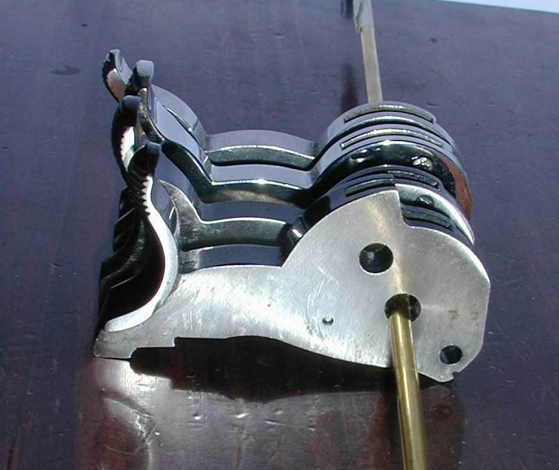

El Mulo Vaquero, SASS #55942 Posted February 4, 2020 Posted February 4, 2020 The Bisley hammer will have to be reshaped, material removed to fit the Old or New vaquero frame

Major E A Sterner #12916 Posted February 5, 2020 Posted February 5, 2020 Before getting a pair of Bisley Vaqueros I had a pair of .45 Colt Vaqueros that I got to shoot duelist with, I ordered the Bisley hammers from Ruger and removed some metal off the area El Mulo Vaquro shows in his post, They dropped right in with no changes to the timing. As long as you have a way to remove the metal evenly it's a very easy process. I used a Vaquero hammer that had the spur cut off to scribe the line where metal had to be removed, worked out great.
