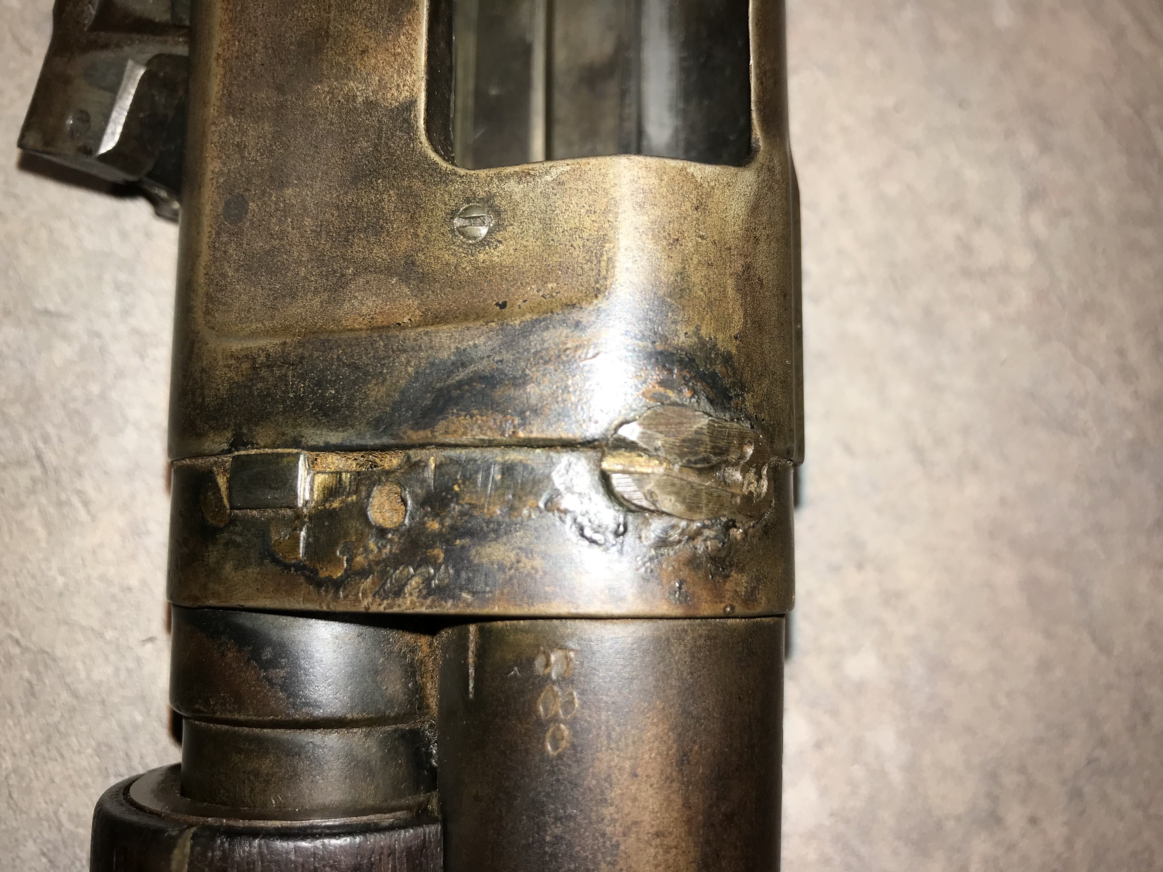

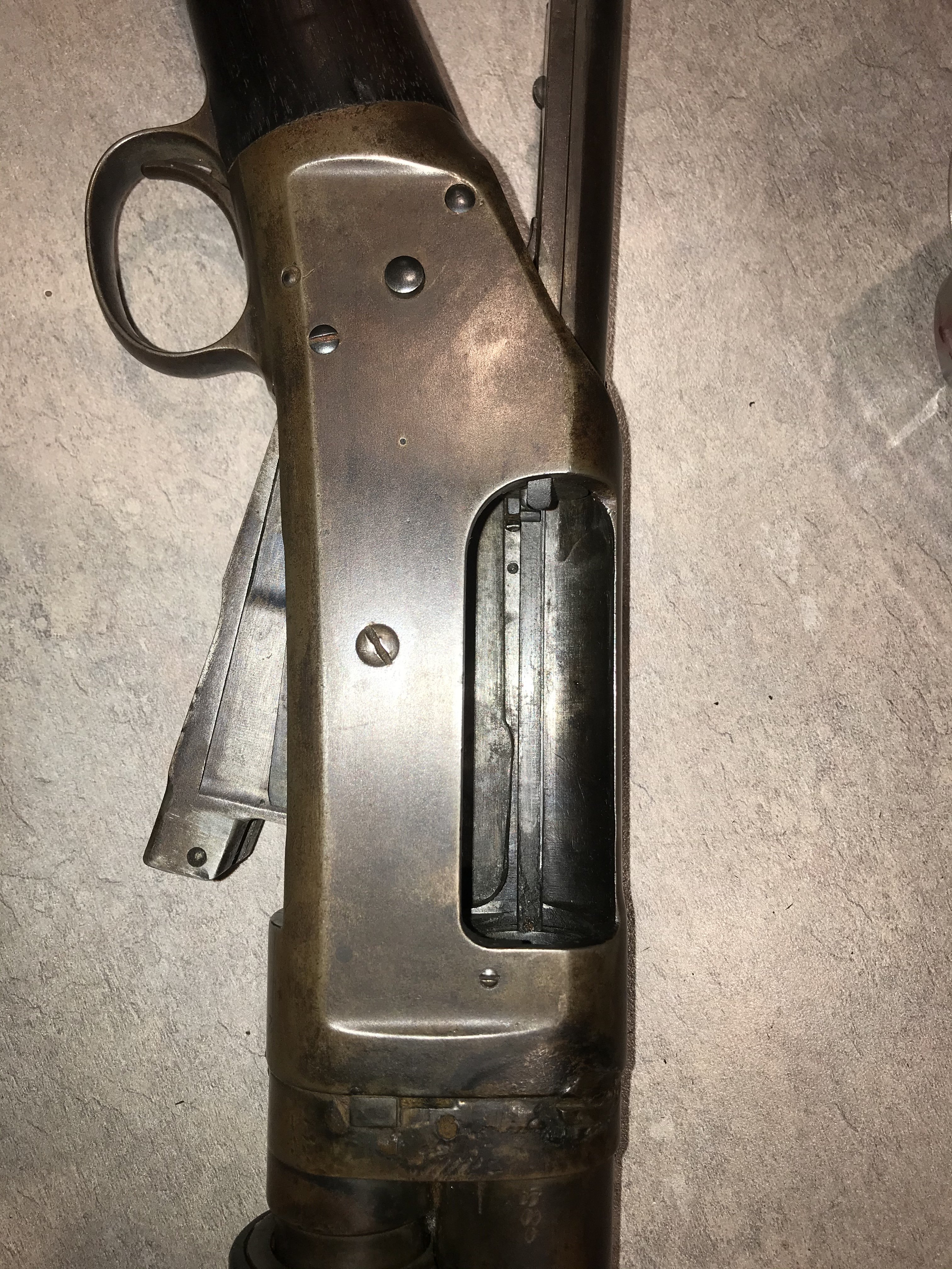

dannyvp Posted October 10, 2019 Posted October 10, 2019 I have a friend who found this is his dads closet and he knew I was looking for one. it very hard to cycle right now due to no oil, and it still has a full length barrel. what do I need to look for in one? what do you think of this one?
watab kid Posted October 10, 2019 Posted October 10, 2019 it looks really rough , i have a weakness for things like that but i would want it free or really cheap , JM2C
Warden Callaway Posted October 10, 2019 Posted October 10, 2019 Looks to me like it's a 1893 - thus not legal for SASS. But I don't know much about 93s or 97s.
Wrangler Rich SASS #42157 Posted October 10, 2019 Posted October 10, 2019 Not a 93, but this one has been (at one time) welded together. If it isn't free or close to it, let it go. WR
Yul Lose Posted October 10, 2019 Posted October 10, 2019 Looks like somebody tried to make a take down 1897 into a fixed barrel 1897 for some reason. Very poor welding work.
Major BS Walker Regulator Posted October 10, 2019 Posted October 10, 2019 You could sell the parts but they have been welded together.
Garrison Joe, SASS #60708 Posted October 10, 2019 Posted October 10, 2019 Why welded? Probably loose when assembled and would not stay together to fire safely. Would take major investment to get this one working. IMHO. GJ
Bad Bascomb, SASS # 47,494 Posted October 10, 2019 Posted October 10, 2019 Quality (or lack thereof) of welding brings up the question of metal strength in critical areas. The amount of heat applied in uneven concentrations would compromise strength of receiver. Wall hanger status.
dannyvp Posted October 10, 2019 Author Posted October 10, 2019 Sorry I fat fingered the title. It’s a 1897. he hasn’t given me a price, he asked me what it was worth. is there a way to test it or inspect it to see if it’s safe?
Chickasaw Bill SASS #70001 Posted October 10, 2019 Posted October 10, 2019 Sir in a nut shell , she be hurt real bad , I would NOT attempt to shoot it , the only test is to tie it down and fire remotely , hang her on the wall , she ain't worth getting hurt over Chickasaw
H. K. Uriah, SASS #74619 Posted October 10, 2019 Posted October 10, 2019 IF it is shootable, I would not pay more than a hundred bucks for it. Would like to see a pic of the whole thing, not just closeups. That welding spot makes me wonder why it is there. And even though it looks like it's a mess, I'd still not cut the barrel. Long barrels are cool.
dannyvp Posted October 10, 2019 Author Posted October 10, 2019 1 hour ago, H. K. Uriah, SASS #74619 said: And even though it looks like it's a mess, I'd still not cut the barrel. Long barrels are cool. the only reason I would cut is this is for my 11 year old. That’s a lot of fun for him to hold. The one he shot was pretty short.
Boggus Deal #64218 Posted October 10, 2019 Posted October 10, 2019 Keep looking! I wouldn’t shoot this one myself! I sure as h*ll wouldn’t let my 11 year old shoot it!
KingSnake Posted October 10, 2019 Posted October 10, 2019 That shotgun barely qualifies as a "parts gun".
Sarge Posted October 10, 2019 Posted October 10, 2019 Take a pass unless he gives it to you for a parts gun. It appears to me that the adjustment to tighten the take down worked loose and rather than repair it properly, it was welded. If you are going to go the Winchester 97 route, it's always good to have spare parts laying around. No telling what type of damage the heat did. Can't see the stock, but good stocks are hard to find. Maybe some of the internal stuff is good too.
Mudflat Mike, SASS #20904 Posted October 11, 2019 Posted October 11, 2019 Before cowboy shooting came along, folks would "fix" the magazine tube from pulling out of the extension when worn by welding it together, appears that's what's happend here. Good luck
Russ The Red Posted October 11, 2019 Posted October 11, 2019 It's not worth a dime and it is too dangerous to fire, especially with modern powder. I wouldn't let my 11 yo grandson anywhere near a firing line with that weapon. Please heed the advice of much more experienced people and don't take it.

Cat Brules Posted October 14, 2019 Posted October 14, 2019 BUY THE GUN...... BUT, offer your friend $25.00 for it. It’s good for parts but not good for either shooting or as a wall hanger. It is just too rough, and potentially dangerous. Now, you have some work to do. For this shotgun to have gotten into the condition that it was in (because someone thought they could fix a loose magazine tube by welding), the shotgun would’ve had to have seen significant use. That means, “significant wear”. You are going to have to put some time and effort into dismantling the gun, putting each part, screw, pin, in a small plastic bag and labeling it. See if you can find a parts list and drawing for the shotgun on the Internet. Label the parts with the part name and part number from whatever drawing you find. Clean all the parts as you dismantle the weapon. OK, you now have some experience in dismantling a Winchester ‘97. NOW, find an original WINCHESTER-made, Win97 in good condition and shoot that in competition. Use the parts from this worn out piece to keep your competition shotgun running. Or, you could sell the parts individually or in “ assemblies” on eBay. Other shooters here can provide info as to what to look for when purchasing a Win97 for CAS. You could also look for YouTube videos as well. There may be a video there that specifically gives you tips on inspecting-for-purchase a Winchester ‘97. Cat Brules

Cat Brules Posted October 19, 2019 Posted October 19, 2019 Of course I can’t see the weapon to know anything about it for sure. However if the mag tube was welded up and the gun can’t be taken apart it almost certainly means that the mag tube was coming loose and would not properly stay in place. For that to happen that means that the threads on the magazine tube, and probably the receiver are worn so badly that the gun, as I said, won’t stay together. That means the gun is worn out. I would not try to fix this gun to shoot It. As I said, I have not seen the gun. However, it’s in pretty rough shape from the looks of the photographs. You can do a lot better for yourself. Make sure you buy a Winchester model 97 that’s fully functional and without a sloppy front end. If you can get this rough weapon cheap, and use it as parts-support for a good Win97 that you use to compete with, therein lies its value to you. BUT, DON’T FORGET that the weapon has seen a lot of use. Many of the other parts that are in it may also be worn to one degree or another, but the screws, pins, non-wear parts, etc., could prove invaluable as support for your match weapon. That is why you have to buy it very cheap. I wouldn’t cave to paying significantly more than $25 (30-35 max., in my mind). Check the serial number to see how old it is. Cat Brules
