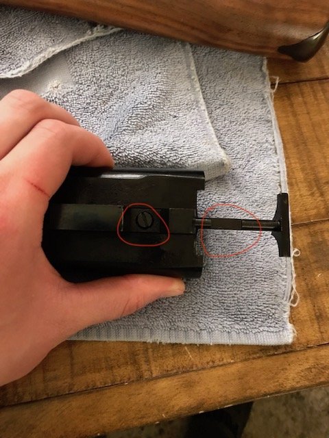

Double Pipe Classic Posted April 24, 2019 Author Posted April 24, 2019 One more question (I hope) since you all have been so helpful. I just cleaned the gun for the first time and the extractor fell out when I tilted it up. There is a notch on the bottom of the extractor and what appears to be a set screw on the bottom of the barrel assembly (which I am assuming allows the extractor to extract without falling out if tightened a bit). Just wanted your opinions if i'm completely off base or if this is by design as I haven't seen anything in the manual and haven't found anything online. Thanks
Springfield Slim SASS #24733 Posted April 24, 2019 Posted April 24, 2019 Tighten the set screw, it shouldn't fall out like that.
EnglishMike Posted April 27, 2019 Posted April 27, 2019 Yup, just tighten the screw, check the ejector as you tighten it, so that it’s not binding up on the screw. As for the gun being hard to break open, read up on slicking it up, polish mating surfaces etc wil help.

Ya Big Tree Posted April 30, 2019 Posted April 30, 2019 On 4/24/2019 at 1:04 AM, Double Pipe Classic said: One more question (I hope) since you all have been so helpful. I just cleaned the gun for the first time and the extractor fell out when I tilted it up. There is a notch on the bottom of the extractor and what appears to be a set screw on the bottom of the barrel assembly (which I am assuming allows the extractor to extract without falling out if tightened a bit). Just wanted your opinions if i'm completely off base or if this is by design as I haven't seen anything in the manual and haven't found anything online. Thanks Man, that thing broke already?? I'll give ya $300 for it.

Garrison Joe, SASS #60708 Posted May 1, 2019 Posted May 1, 2019 22 hours ago, Ya Big Tree said: Double Pipe Classic said: I just cleaned the gun for the first time and the extractor fell out when I tilted it up. There is a notch on the bottom of the extractor and what appears to be a set screw on the bottom of the barrel assembly (which I am assuming allows the extractor to extract without falling out if tightened a bit) Yes, DPC, that is the function of the set screw. It has to be tight enough to retain the extractor, but loose enough so the extractor actually moves properly. Find that spot, then lock-tite (purple low strength) the screw at that position. Good luck, GJ

Double Pipe Classic Posted May 3, 2019 Author Posted May 3, 2019 On 4/27/2019 at 6:07 PM, EnglishMike said: Yup, just tighten the screw, check the ejector as you tighten it, so that it’s not binding up on the screw. As for the gun being hard to break open, read up on slicking it up, polish mating surfaces etc wil help. Thanks. I've got it tightened up now. Planning on trying it for the first time after work today!
