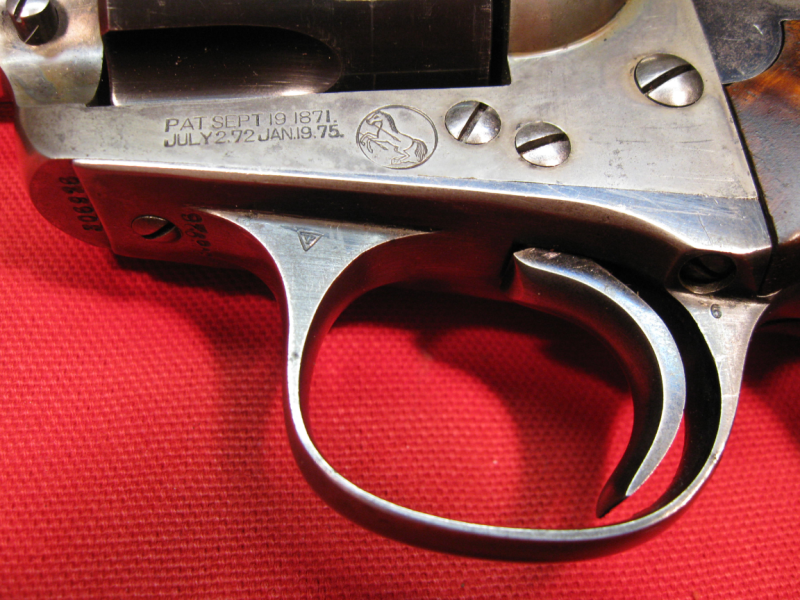

Driftwood Johnson, SASS #38283 Posted April 12, 2013 Posted April 12, 2013 Howdy Here is some information gleaned from Jerry Kuhnhausen's book Colt Single Action Revolvers Shop Manual, the most authoritative book I know of having to do with the mechanics and capabilities of the Single Action Army revolver. This may be useful for this discussion. Cylinders and frames of SAAs made prior to approx. SN 96,000 (mid 1883) were made from materials generally resembling high grade malleable iron. Cylinders and frames from approx. SN 96,000 to about 180,000 (mid 1898) were made from transitional low/medium carbon steels. These cylinders and frames were not factory guaranteed for Smokeless Powder cartridges. Cylinders and frames from approx. SN 180,000 (mid 1898) began to be made from medium carbon steels. Later versions of these cylinders were better and more uniformly heat treated. SAAs with cylinders in this final type were factory guaranteed in 1900 for standard factory load Smokeless cartridges. Shortly after this Colt began stamping a triangle with VP in the center on the trigger guard. This stands for Verified Proof, and indicates that the gun has been proofed for Smokeless powder. Here is a photo of the VP symbol on the trigger guard of a 2nd Gen Colt. http://img.photobucket.com/albums/v495/Driftwood_Johnson/colts/colt%20markings/ColtVerifiedProof.jpg Here is a photo of the VP symbol on a Bisley Colt made in 1908. http://img.photobucket.com/albums/v495/Driftwood_Johnson/colts/colt%20markings/BisleyColtMarkings.png For what it's worth, just about any old Colt made before 1900 has probably been fired with Smokeless powder at some point. Probably without any damage to the gun. But doing so repeatedly can be risky. By the same token, if it is an old Colt and it has the VP proof mark stamped on the trigger guard, one can shoot Smokeless powder in it, as long as the usual cautions about the gun being in good condition, and the pressure generated by the loads being within SAAMI spec, are observed. Here is a pair of pressure curves superimposed on each other to illustrate the problem. Yes, these loads are shotgun loads, and yes, the Smokeless powder is not identified. But the concept is the same. Both loads achieved the same velocity with projectiles of the same weight. In addition to the amplitude of the curves, notice how much gentler the Black Powder curve is. Notice how the sharp pressure spike generated by the Smokeless load, in addition to being higher, is much shorter in duration. That's what causes the problems with old guns, the short duration pressure spike can shatter the old steel. http://img.photobucket.com/albums/v495/Driftwood_Johnson/Pressure%20Curves/pressure_curve.jpg I don't own any pre-1900 Colts, but I own several S&W Top Breaks made before 1900. I'm sure they have probably been shot with Smokeless at some point, but I would not dream of shooting them with it. As my friend Happy Trails said just after blowing up an antique Merwin Hulbert, 'I guess I shouldn't have been firing them with Smokeless Powder'.
Big Jake1001 Posted April 12, 2013 Posted April 12, 2013 1st gen Colt's were made from 1873 till 1941. Black powder frames had a screw retaining the base pin 1873-1896. Then the spring loaded cross pin held in the base pin. Some say all guns from this transition are OK for smokeless. 1898 up were as Driftwood said made of better quality steel and I've read that Colt warranted all guns OK for Smokeless from 1900. The VP (Verified Proof) in a triangle stamped on the trigger guard didn't appear until 1904. So there are Plenty of first Gen Colts that were made after 1900 until WWll that were safe to use with smokeless. I have 2 Colt SAA in 38 WCF mfg in 1900 and 1 Colt Bisley 38 WCF mfg 1902. I do shoot some smokeless (loaded lightly) but mostly real Black Powder in them. Any Colt made in the 1880's should only be shot with Black Powder loads. A friend has a Colt .45 made in the 1880's that was restored by John Kopec and has an extra Smokeless .45 Colt clyinder that John fitted to the gun. Jake
