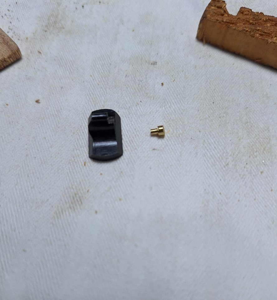

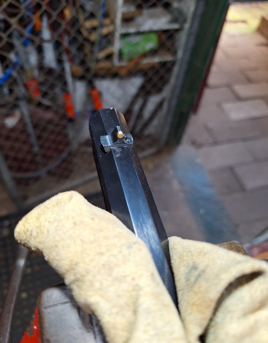

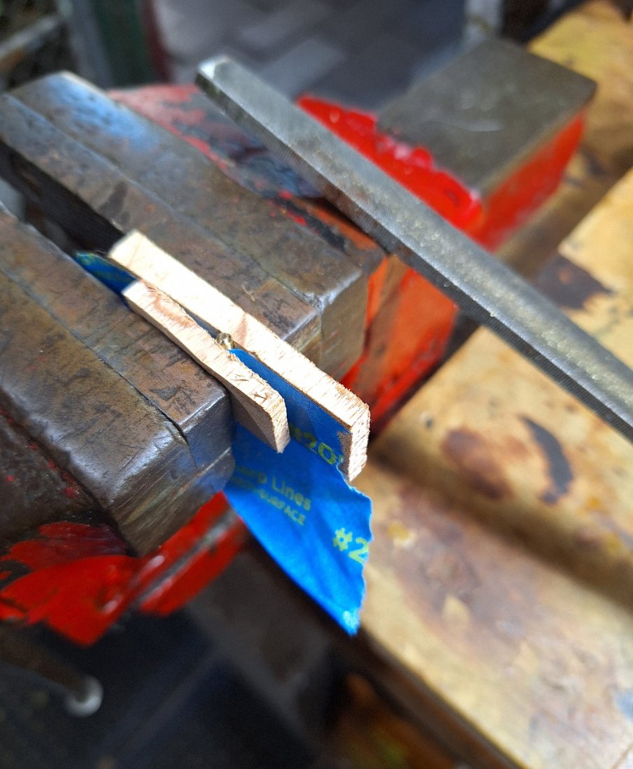

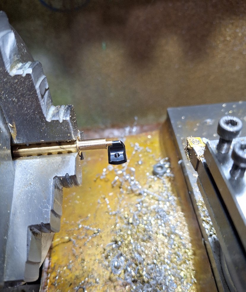

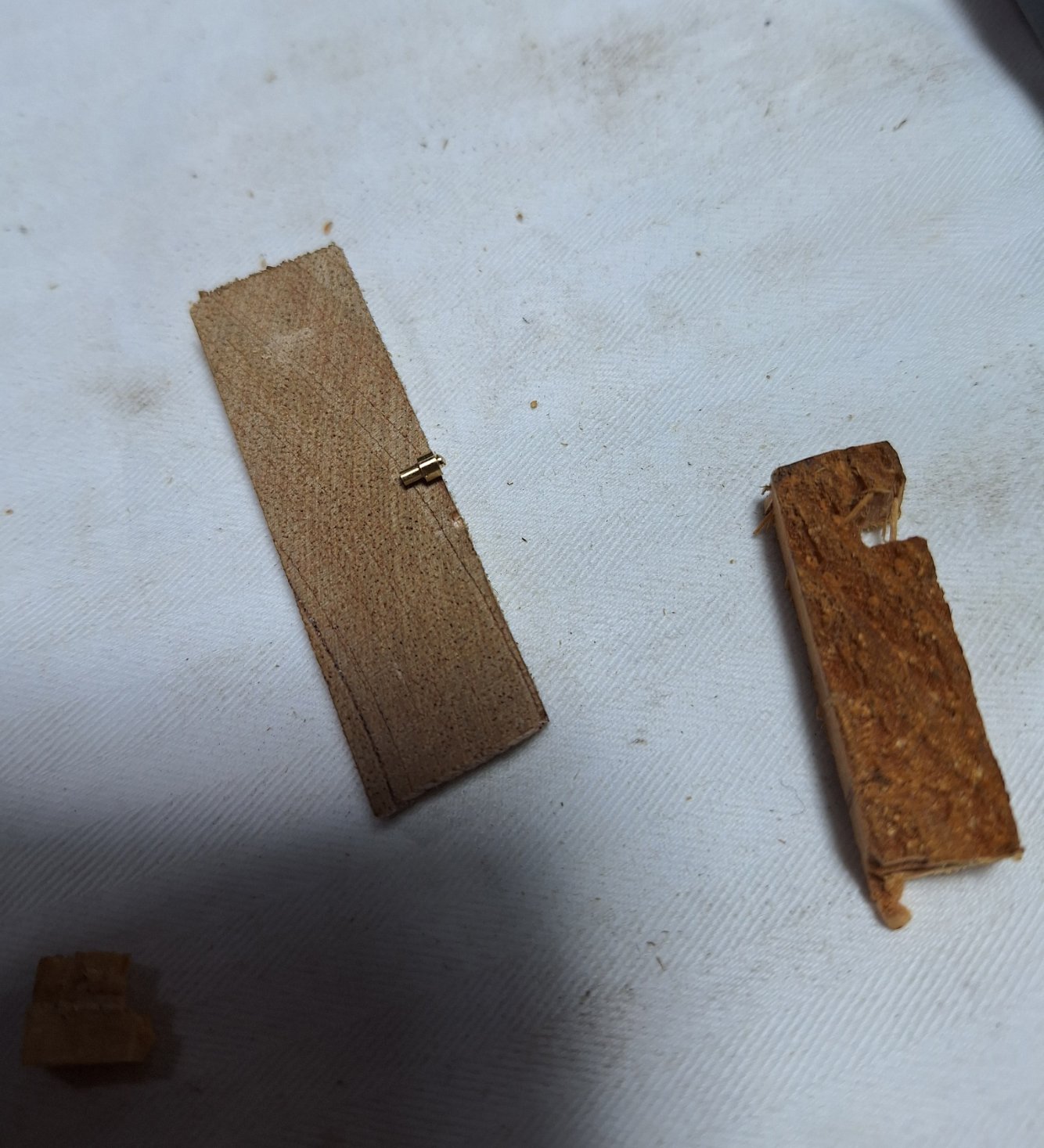

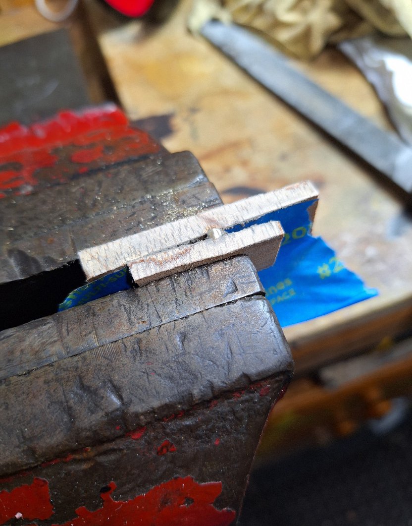

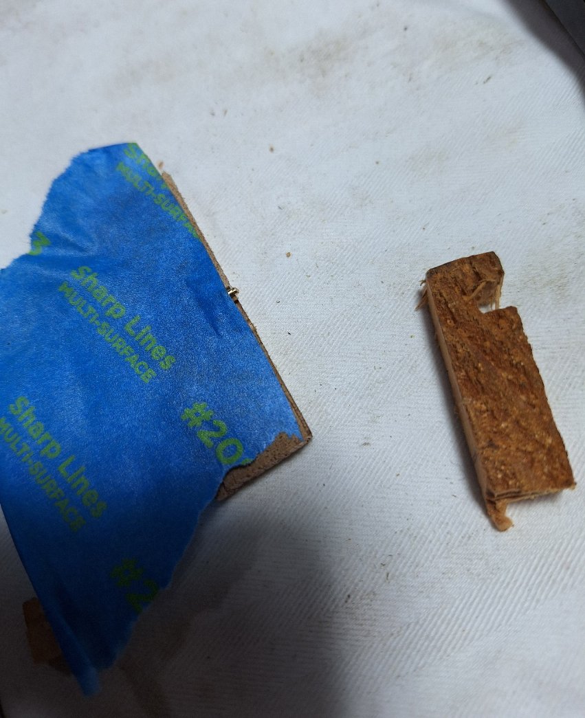

Buckshot Bear Posted March 12, 2024 Author Posted March 12, 2024 Thanks pards one and all for the suggestions, but the boss was having none of that "Please can I have exactly what I had before" ....... Turned down the insert shank to a thou oversize - Test fitting for a friction fit - Parted off - Had to hand file off the nub that I always get from parting off, the piece being so tiny was a problem to hold so I used some masking tape and to get it in place and then sandwiched between some wood offcuts and after filing gave it a polish - Looking good - Used some Loctite 638 Retaining Compound, along with the friction fit I hope that it stays in place. At least if it doesn't I know I can make another one now......and back on the barrel -
Larsen E. Pettifogger, SASS #32933 Posted March 12, 2024 Posted March 12, 2024 638 will work fine. I have never had one fall out using 638.
Buckshot Bear Posted March 12, 2024 Author Posted March 12, 2024 19 minutes ago, Larsen E. Pettifogger, SASS #32933 said: 638 will work fine. I have never had one fall out using 638. Thanks Larsen.
