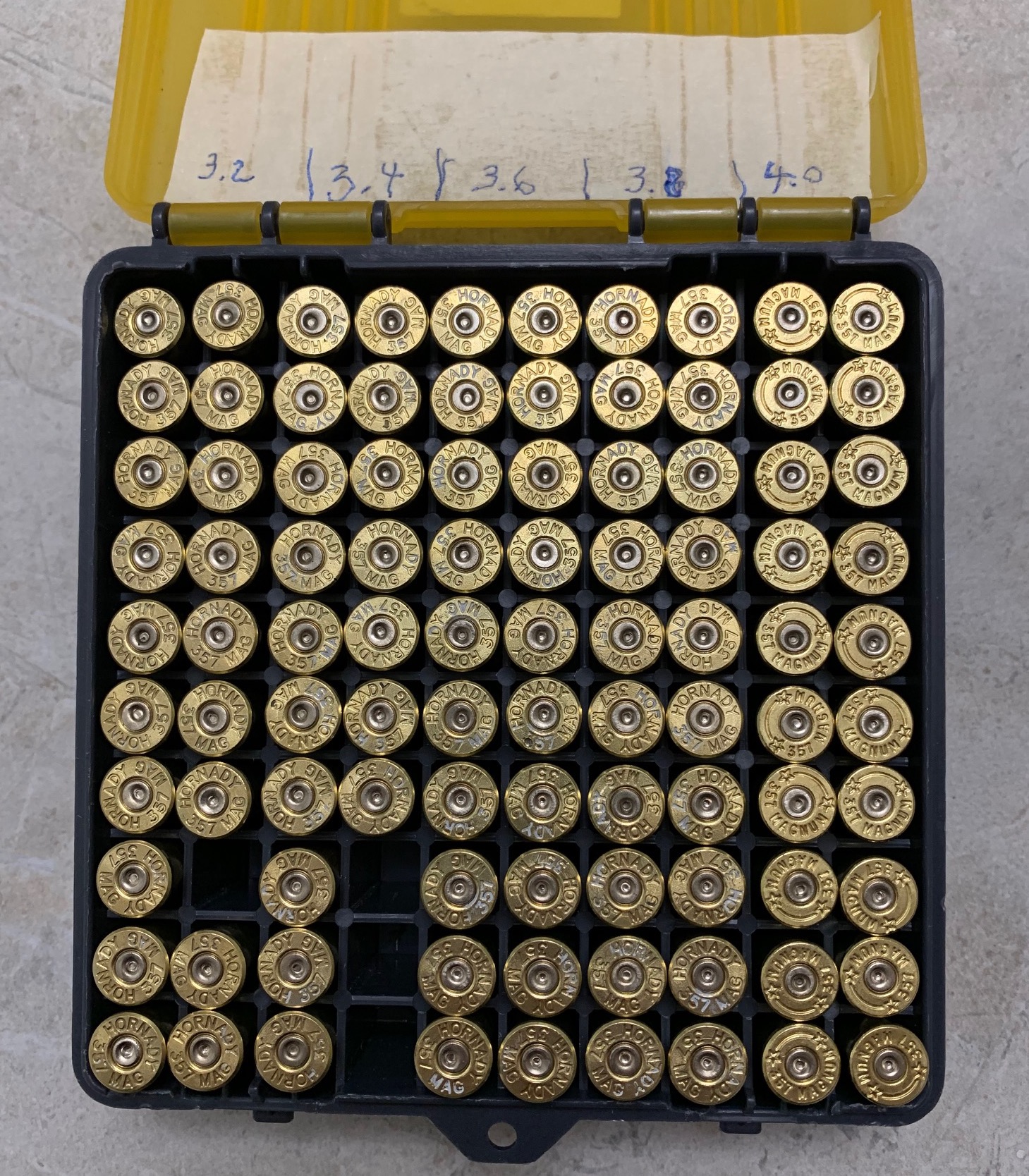

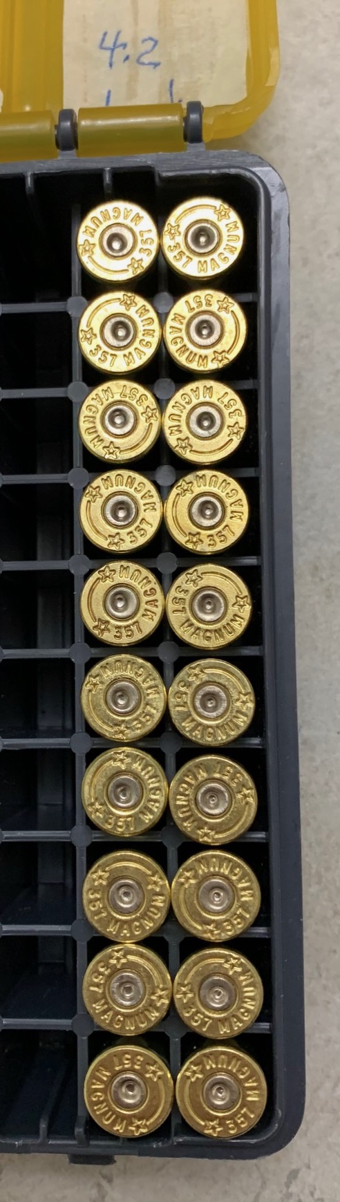

Mysterious Stranger Posted March 20, 2023 Author Posted March 20, 2023 For the first 60 shots (ladder test): 357 Magnum 357 Magnum case 158g Hornady swaged bullet (no. 10408) The load source is Hornady's own load table for this bullet: Their table stopped at 4.1g, but I tried 3.2, 3.4, 3.6, 3.8, 4.0, and when the primers still looked all the same (not flatteneded) I fired the 4.2 grain load as well. The Trail Boss loads fired for the last 35 rounds were all: 148g cast bullets 4.1 grains of Trail Boss Jim G

Sedalia Dave Posted March 20, 2023 Posted March 20, 2023 8 hours ago, Jim Gnitecki said: Their table stopped at 4.1g, but I tried 3.2, 3.4, 3.6, 3.8, 4.0, and when the primers still looked all the same (not flatteneded) I fired the 4.2 grain load as well. Using the flattened primer test in SAA revolvers is a good way to blow up a gun. Yes these revolvers are proof tested but they are not over built.

Mysterious Stranger Posted March 20, 2023 Author Posted March 20, 2023 7 minutes ago, Sedalia Dave said: Using the flattened primer test in SAA revolvers is a good way to blow up a gun. Yes these revolvers are proof tested but they are not over built. My primers seem pretty far from being flattened. This photo shows the primers after firing for the 3.2g to 4.0g loads: This photo shows the 4.2g primers, which look no different: And a good strong apparent firing pin hit for all shots fired. Jim G
