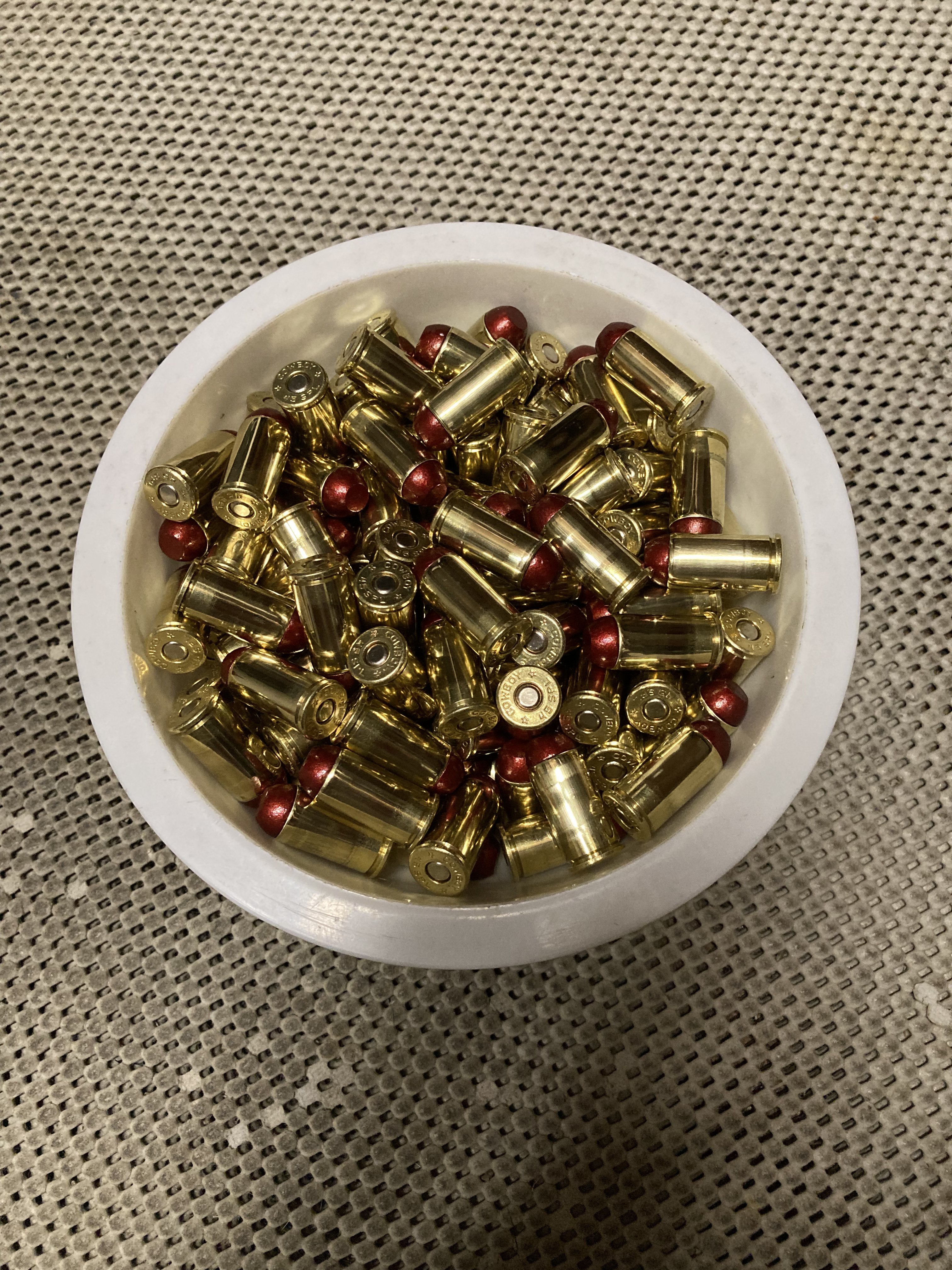

Warden Callaway Posted October 12, 2021 Posted October 12, 2021 My efforts at making C45S from cracked 45Colt cases. Labor intensive and not to way I'd do it if I were to make more than a few. But this is how I did it using what I had. I'm still "using up" the first 500. They have been reloaded numerous times and annealed several. Get cracks and splits in the body. A few loose primer poskets showing up now. Good thing I have 500 new stashed back.
