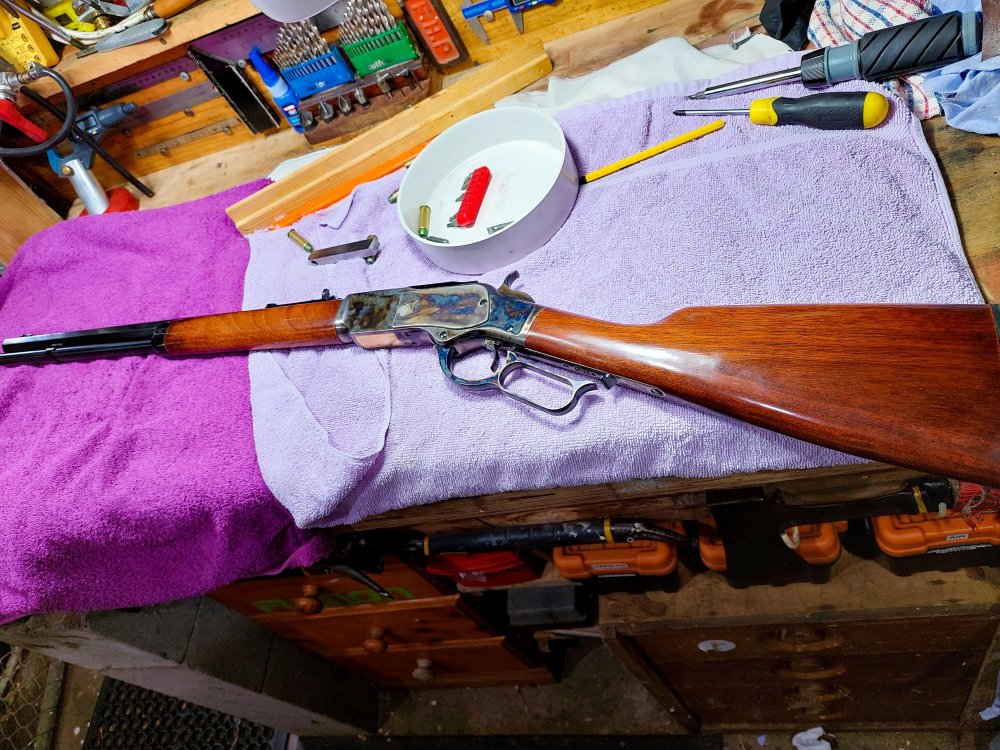

Buckshot Bear Posted September 21, 2021 Posted September 21, 2021 Put the '73 back together today after 18 coats of linseed oil rubbed in over 21 days.

John Boy Posted September 21, 2021 Posted September 21, 2021 Patience rubbing the wood over multiple days really pays off … excellent finish

The Original Lumpy Gritz Posted September 21, 2021 Posted September 21, 2021 Nicely done. Please confirm you used no stain to color the stock. OLG
Buckshot Bear Posted September 21, 2021 Author Posted September 21, 2021 2 hours ago, The Original Lumpy Gritz said: Nicely done. Please confirm you used no stain to color the stock. OLG Yes walnut stain diluted down with alcohol. Each coat of linseed oil made the stock and forend richer coloured. They were put in the sun (hot and high UV's) and turned every hour.
Rancho Roy Posted September 21, 2021 Posted September 21, 2021 I was taught......Hand rubbed Linseed oil....Once an hour for a day...once a day for a week....once a week for a month.....once a month for a year.....Then as needed

Dusty Devil Dale Posted September 25, 2021 Posted September 25, 2021 Very nice. A good butt wrap will help protect that shiny finish from LT, ULT, and restaging table debris. But with linseed oil, repair is also pretty easy. Nice job.
Buckshot Bear Posted September 25, 2021 Author Posted September 25, 2021 59 minutes ago, Dusty Devil Dale said: Very nice. A good butt wrap will help protect that shiny finish from LT, ULT, and restaging table debris. But with linseed oil, repair is also pretty easy. Nice job. I have a really nice leather butt wrap, just want to wait another week or so before I put it back on.
Blackwater 53393 Posted September 25, 2021 Posted September 25, 2021 Some judicious steaming can “heal” many of the dings on stock and fore end finished with good oil!
Big Sage, SASS #49891 Life Posted September 25, 2021 Posted September 25, 2021 I've done 30 or 40 stocks with linseed oil. I like to dilute the first few coats with thinner so it penetrates easier. I also like a satin finish instead of the "shine". I use powdered pumice and light mineral oil rubbed to give the stock a satin, less glossy finish.
