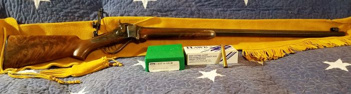

Here is a discussion regarding smokeless loads for the .40-70 SS posted on the SHILOH discussion forum in 2008.
LINK
I picked up this Shiloh Sharps #1 Sporter from the original owner a few years ago.
The only loads he had shot through it since 2000 were XMP 5744 under a Hawk 350gr RT.
When I am able to access a 500+ yard range, I intend to work up some BP loads for it.
