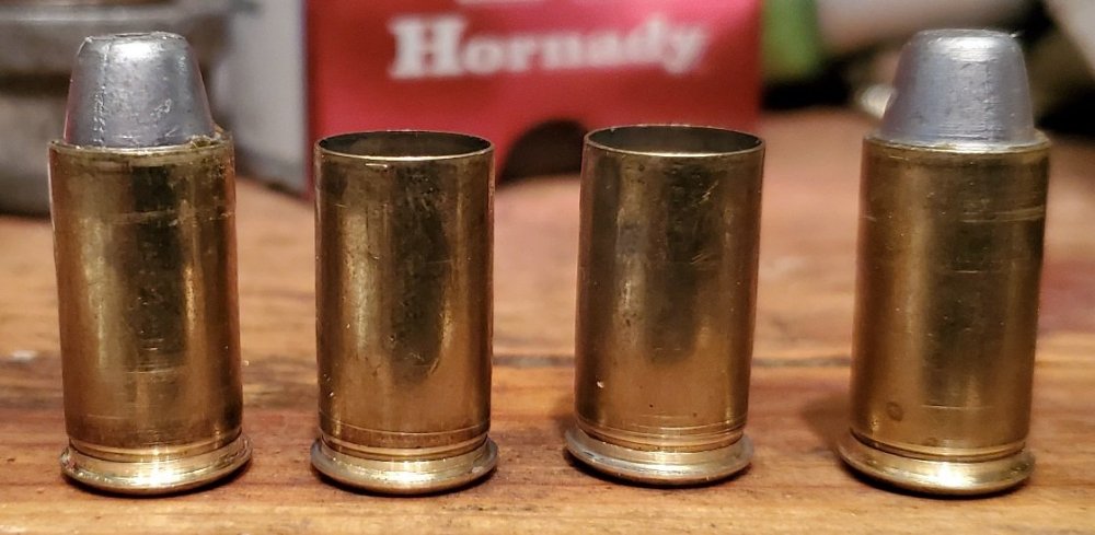

Red Eye Jim Posted May 16, 2020 Posted May 16, 2020 I'm thinking about picking up some .45 Cowboy special brass. A couple of questions. Am I correct in thinking that my Dillon .45 ACP dies setup for my WB loads (200 Grain RNFP) with my .45 Colt plate would be the loading method? Also would these rounds work in my Ruger Birdshead with the .45ACP cylinder or would that need some gunsmithing? Right now it seems like the only rounds my .45ACP Birdshead will work with are ones that can drop into a .45ACP case gage and drop out without issue.
Sarge Posted May 16, 2020 Posted May 16, 2020 Your die set should work. I've had the best luck with a Hornady .45 Auto/AR die set.

Gateway Kid SASS# 70038 Life Posted May 16, 2020 Posted May 16, 2020 17 minutes ago, Sarge said: Your die set should work. I've had the best luck with a Hornady .45 Auto/AR die set. I am a new 45 CS user. This set is what I use with a 45 colt shell plate on a Dillon 550. I think the auto rim crimp is a roll type and my standard 45 ACP is a taper. If I am incorrect someone will let us both know. Took a little fiddling but works great with 130 grain Barnstormer and 160 grain rnfp. Regards Gateway Kid

Colorado Coffinmaker Posted May 17, 2020 Posted May 17, 2020 Well Golly gosh. I've been loading Cowboy 45 Special on my Dillon 650 Since Adirondack Jack first made the cases available. Completely without problem. However, trying to use 45 ACP dies is a mistake. First problem is the ACP resizing die gives the case a slight taper. Suggested to use a regular Dillion 45 Colt resize die. Second, the 45 ACP Taper crimp is designed for jacket bullets in a case that headspace on the case mouth. To roll crimp I use a Redding Profile Crimp die for 45 Auto Rim. 45 Colt shell plate is fine. my Dillon 45 Colt expander/powder dies works perfect. I do use the Dillon 45 ACP bullet seater die with the punch turned around. Scrimping to save a few bucks on dies is a mistake.

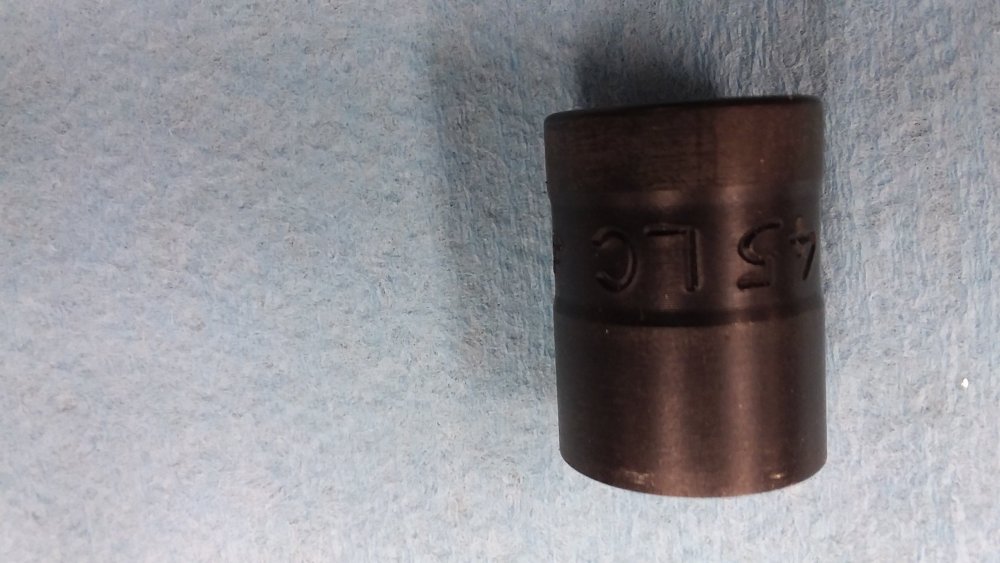

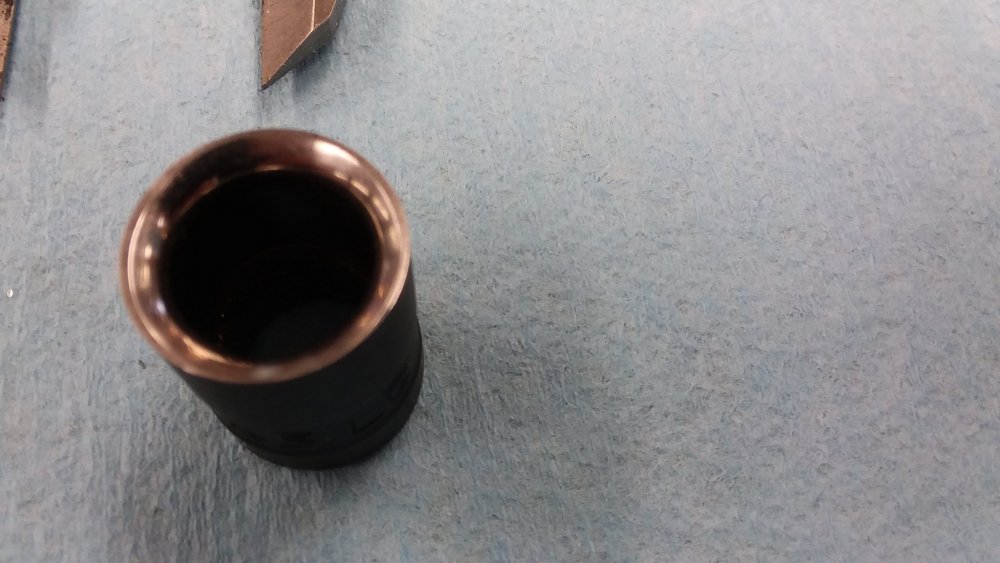

Eyesa Horg Posted May 18, 2020 Posted May 18, 2020 11 hours ago, Ripsaw said: I run the SDB as well. For C45S I ground down a 45Colt crimp die (bought an extra one from Dillon) so that it would work with the shorter cases. I use a 45Colt sizer, 45ACP expander and seating die, and the ground down 45Colt crimp die. Ripsaw, Could you PM me some more info on how you did that. Maybe a picture next to a 45 colt crimp die.? Much Obliged. Eyesa

Ripsaw Posted May 25, 2020 Posted May 25, 2020 On 5/18/2020 at 8:32 AM, Eyesa Horg said: Ripsaw, Could you PM me some more info on how you did that. Maybe a picture next to a 45 colt crimp die.? Much Obliged. Eyesa Here are some pics of the modified 45Colt die insert for the SDB for crimping C45S. Just make sure you grind off the correct end! Bevel and Polish the new "bottom ".

Eyesa Horg Posted May 26, 2020 Posted May 26, 2020 On 5/25/2020 at 11:43 AM, Ripsaw said: Here are some pics of the modified 45Colt die insert for the SDB for crimping C45S. Just make sure you grind off the correct end! Bevel and Polish the new "bottom ". Nice job Ripsaw, that came out excellent. Thanks much.
Eyesa Horg Posted June 6, 2020 Posted June 6, 2020 On 5/25/2020 at 11:43 AM, Ripsaw said: Here are some pics of the modified 45Colt die insert for the SDB for crimping C45S. Just make sure you grind off the correct end! Bevel and Polish the new "bottom ". I did this modification to a new 45 Colt die today and it works excellent. Thanks Pard Eyesa
